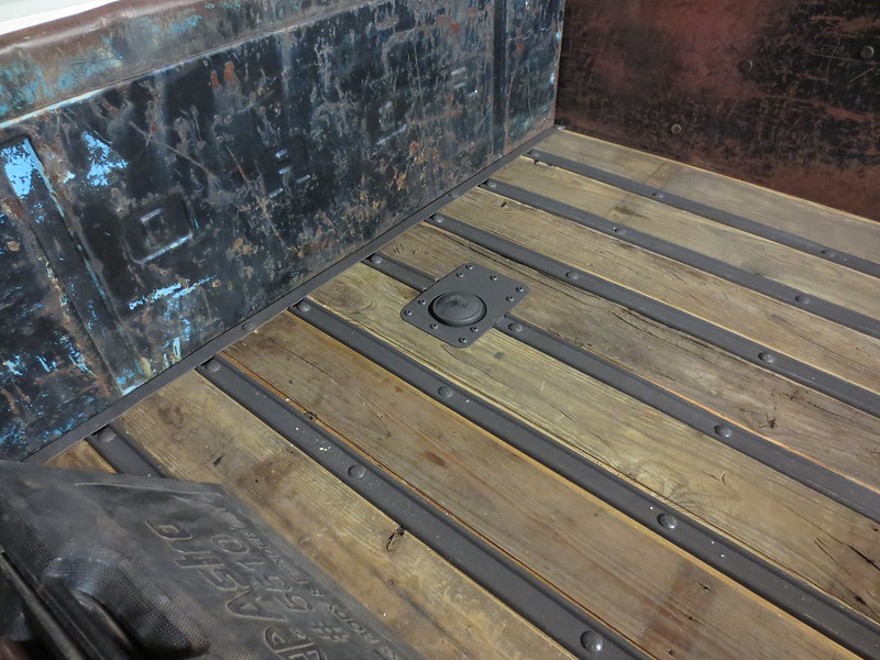

    The exhaust work has been slow going without a chop or band saw. I ran out of bends today so went ahead and cut down the 24" muffler to two 12" after deciding to go with duals all the way to the back. I have the end caps made just waiting to weld them to figure out if the inlet needs a little offset to clear the mid mounted crossmember. We also got the bed about 90 percent installed today.

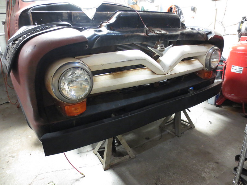

    Thanks for the compliments. The front will actually come up maybe an inch or two from what is shown in the latest image. I want the fender to wheel spacing to be pretty much even front and back. We are very near to the first start. Just trans cooler lines, and a short section of battery cable away.
