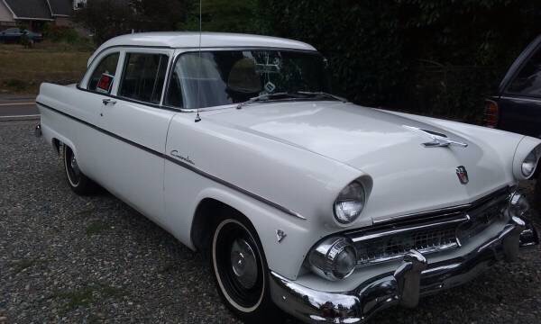

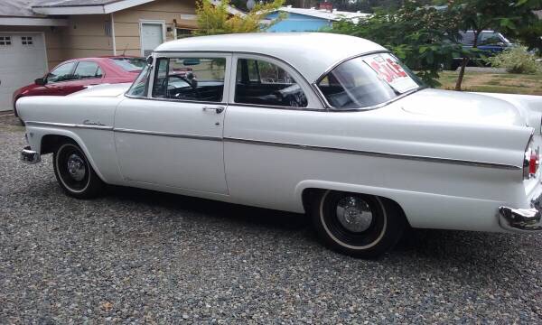

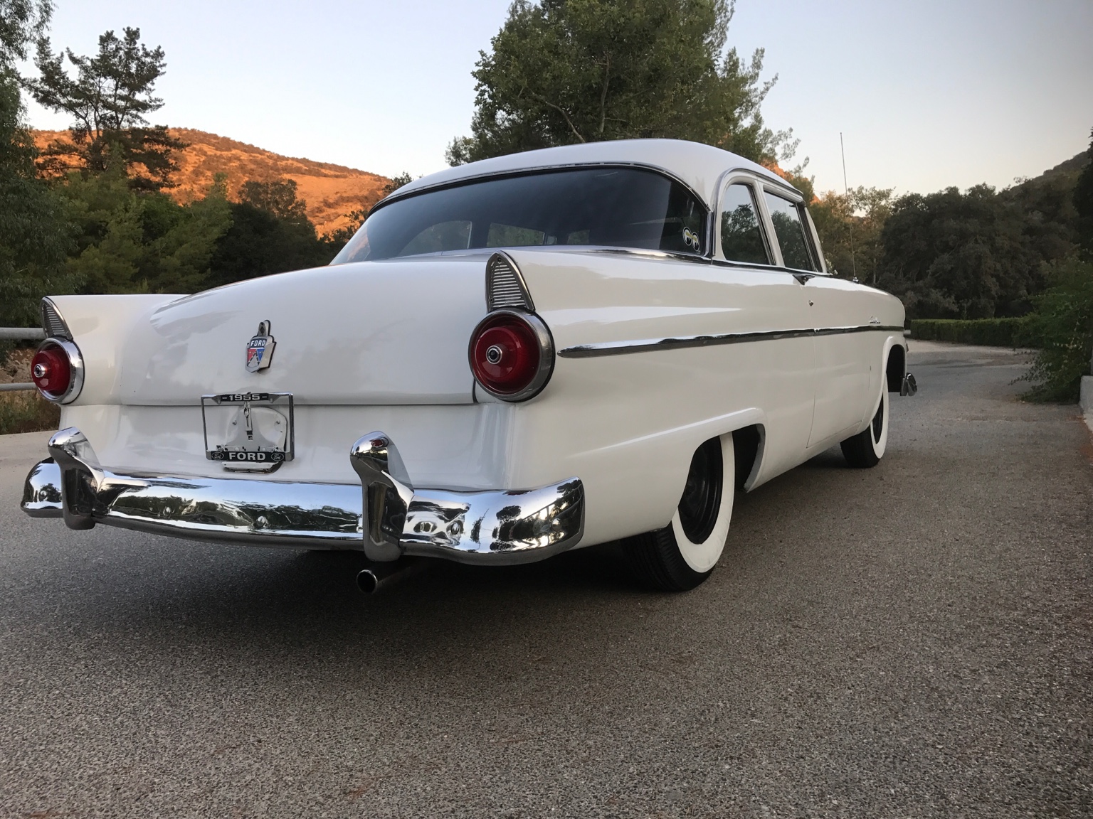

    What's up everyone, figured I'd start a build thread on my 55' customline while I figure out a game plan for my 56' that I'm not sure about yet. Anyways, I bought this 55' 2 door post Ford in Washington sight unseen, called the guy up off of Craigslist, asked a couple questions (not enough) and sent a shipper out to pick her up the next day. These pics are from the Craigslist ad.
    [​IMG][​IMG]
    [​IMG][​IMG]

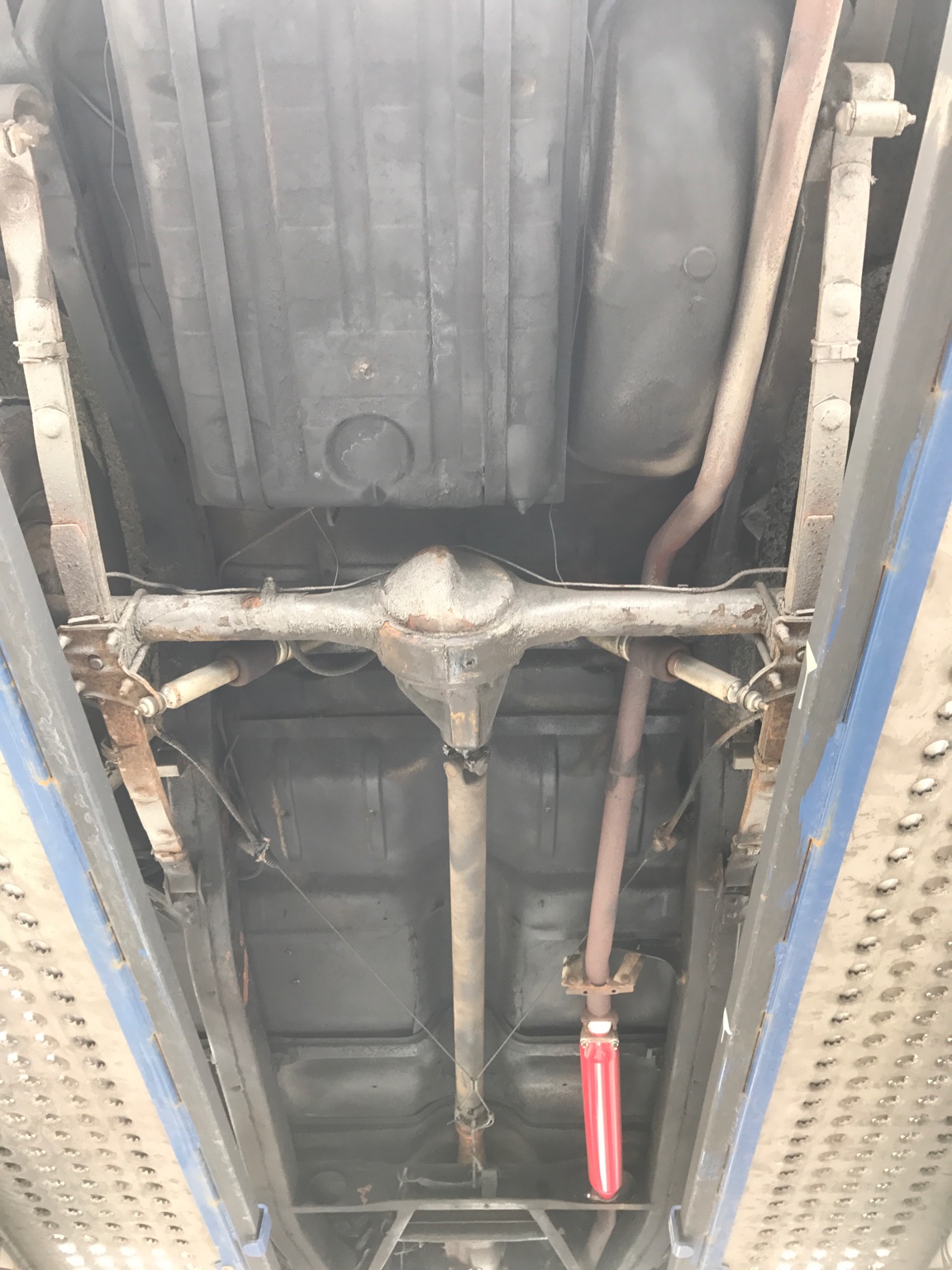

    Here she is the first time I saw her.
    The driver lifted her up in the air so I could check out underneath. Found a couple small spots of rust, but nothing to worry about. This is easily the nicest looking pre 60's car that I've most likely owned. I don't plan on going crazy here, I like my builds simple and clean. This one will be as low as I can comfortably and safely make it. [​IMG][​IMG][​IMG][​IMG]

    After starting her up to drive her off the trailer, I noticed that the stock 272 y block with a 4 barrel edelbrock, did not enjoy idling. The PO said it ran great and drove it daily (loling at myself). Well after messing with the idle circuits and what not, finally got it running decently and decided to go for a cruise. Make it about 45 miles and stop for about an hour. Jump back in, make it another 20 miles and of course, she dies on me and won't start back up. Well after a dead 6 volt battery from starting attempts, and a couple pissed off buddies to come rescue me, I finally getting it going after it cooled down.
    The next day I tore into this thing. She wouldn't idle for **** but cruised perfectly. I'm a big Holley fan, so any excuse to ditch this edelbrock was fine with me. The symptoms of this idling issue kept seeming to be fueled by a vacuum leak.. only problem is that there are only a few different vacuum possibilities on these old fords... windshield wipers, vacuum advance, and intake gaskets...(for the most part).. well I went all in and replaced intake gaskets and byp***ed the windshields wipers out of a simple curiosity.. all though my problem got better, it was not fully gone and still idled like hell and died when hot... I have a freshly built 292 sitting in my backyard waiting to go into my 56' post car that I have patiently let sit for quite some time. Just waiting on a new shop to go through so I can really tear her apart. Anyways, I found the vacuum advance on the 55's disi was a little loose and not removable so I swapped my 56's electronic ignition for my 55's perfronix, and bam, problem solved!

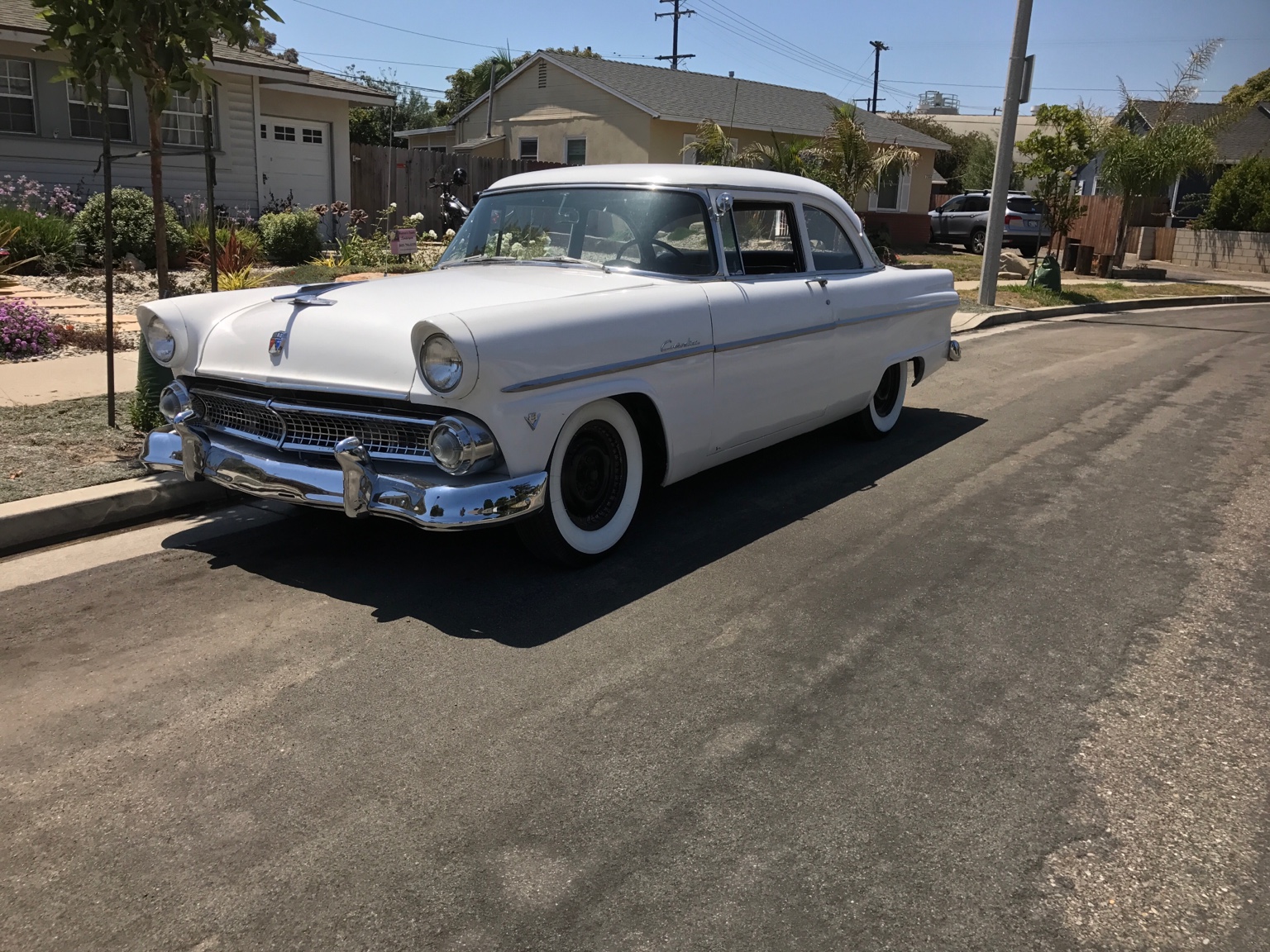

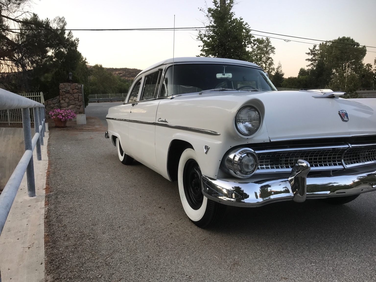

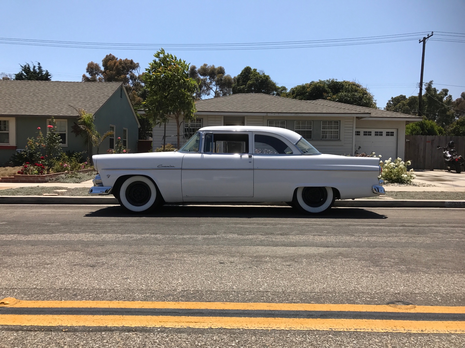

    Keep in mind I have only had this car for about a week and a half or two weeks. This car is my daily driver/project. I've got my 86' Harley FXR as a my backup ride/part getter if something goes wrong with this pile. Anyways, about 3 days in while I was chasing vacuum leaks, I decided to lower this thing and make her sit pretty. I ordered 4" drop blocks for the rear and Aerostar coils for the front with 2" drop a arm spacers from "butchs cool stuff". Once the 4" drop blocks got in, I got very worried about axle-body clearance and stole the 2" blocks from my 56'... I didn't think I'd have so much clearance. Really kicking myself for not going with the 4"... I will be redoing this swap very soon. I haven't installed the Aerostar springs or drop blocks up front yet. Those should be here within the next 12 hours. Also forgot to add that I put on some new firestone bias ply 670r15 3-1/4" wide white walls after the drop... I have never been so frustrated trying to get rear wheels off. Would've been near impossible with the 4" blocks...
    She has been running amazing, aside from getting a little hot in this warm California weather. She handles the freeways fine, just doesn't like sitting for too long in the sun. I have ordered a new aluminum radiator for her. Hopefully that does the trick for now.
    Here's some pics of how she sits now. [​IMG]

    Just looking at how high she sits in front bothers the hell out of me with the wide whites on. Can't wait for her to be sitting better and cover up the top of that tire.

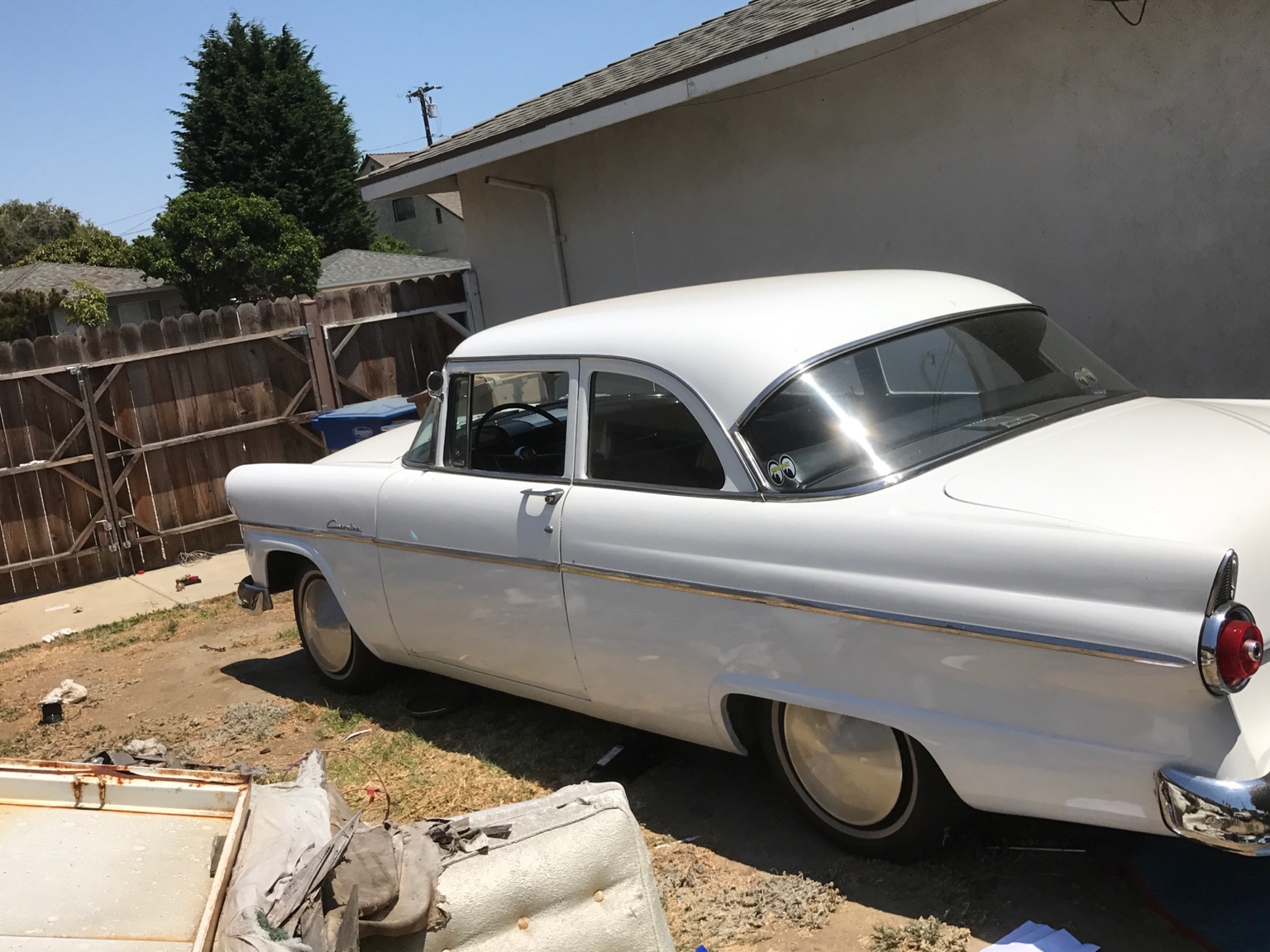

    So I had original hubcaps on but took them off to install speed disc.. only problem is they didn't look good without the front being lowered in my opinion and I dented the hell out of two of them getting them on lol so we'll see. Here's a real **** picture with the speed disc. [​IMG]
