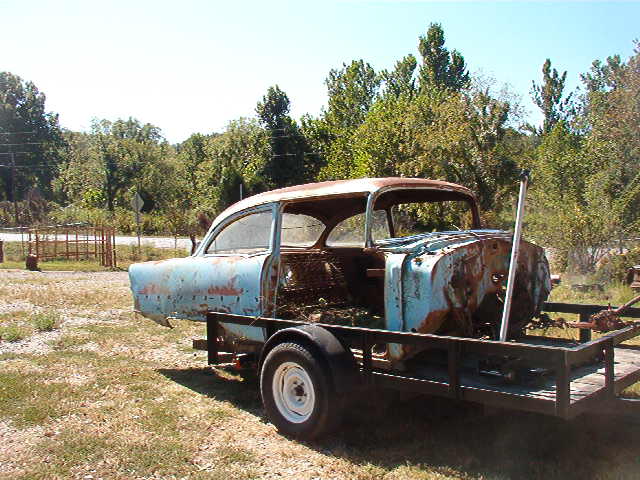

    well,,, i draged in another hunk of junk. found this one in the weeds about 3 miles form my house. its a 56 chevy 2 door sedan. i have a '55 one piece 'glass front end . if i go with the gasser look like i want , how hard will it be to fit the 'glass front end on the 56 , and how will it look? someone told me it was common back in the day caues the '55 clip where more availbe than the '56. true? anyone got pics of this being done?
    found in the weeds:
    home:

    I saw one at a show a few weeks ago, I thought it looked kind of strange....
    The main difference is the rocker and wheelwells don't match. 55 rocker has a flare out at the bottom, 56s rolls under. The 55 wheel openings are more squared, 56 is teardrop shaped.

    I don't have pics of mine from 67-68. 56 BelAir 2dr htp. It was a rusty car with bad front fenders, so I found a racecar 55 glass nose for $50. It fit fine. I had no skiils but made front hinges to tilt it. It looked hokey to me, but I was still in HS working part time...couldn't even afford used mags. Car had a 348 tri-power/3 speed.

    Seems the 55 front on a 56 was a lot more common than the other way around. You'll have to fab up a workable wiring harness. Others have already made note of the minor difference in the trailing ends of 55 fenders. The 56 tail lights can use the "custom" one piece, full lenses to give it a little "exaggerated 55" look. I'd say trade the 55 glass nose for a stock or glass 56,but then again.......... I'm 56sedandelivery/Butch.

    yes the wheelwells were a thought . but if i gasser it, ill radius the wells and cut the teardrops out. taillight are still a wonder.

    its only glass, you can always fade the rocker line out at the bottom of the front wheel opening, 1/4's look solid? do they have much filler, if so the radiused 1/4s look decent on Rat Patrol, not like you cant reskin it later on.
    its only a front end, if youve already got it use, not like you cant swap it out if you come across a good deal on a 56 front end later.
    Get it mechanically sound and running hard with the body parts you have, throw a whole bunch of flake at it (emerald green body with white pearl roof), skinny slots or Americans on the front with black steelies and cheaters on the back, beat on it for a while, think up a new plan if you want to redo it or sell it

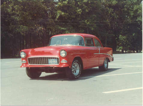

    1. Kustom Painters
    I helped build a 56 2 dr sedan for a high school friend of mine, Keith Campbell, back in the late 70's. We just used what was available, and that was a 55 nose for the car. I later wound up buying it from him and changing it around a bit, finishing it up.
    IIRC, you really only have to flatten out the extension of the fender flare of the 55 front fenders. to make it passable. We used the 56 side trim and shortened it, because I believe it wouldn't work well with the 55's body line.
    I'll try and find a pic showing more of the front.

    1. Kustom Painters
    Found a front shot!
