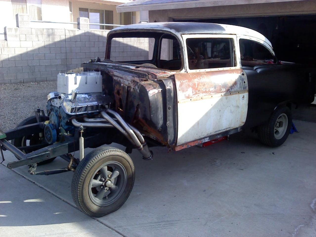

    Thanks all for the great comments, Im pushing ahead so i can enjoy this car soon. Ive wanted a 55 g***er for a super long time.

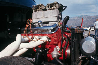

  4. Looking good Kevin, glad to see you have the TR-1 with the "false floor" (center piece). It'll make more power and keep you from puddling fuel and blowing the plenum box apart. I love those funky old TR-1's. I have '69 Popular Hot Rodding yearbook with an article on the TR-1 small block (301" test engine)versus the X8 crossram. At 5000 rpm the X-ram has fuel stand off above the carbs, but the power is about the same for both manifolds. By 6500 the X-ram is signing off and the tunnel ram is over 20 hp better. At 8000 the TR-1 is 62HP better! Now this is the very first tunnel ram Edelbrock ever made and it KILLS there X ram.., good choice.

    rick, it was funny I was at a local swap meet in havasu and i didnt even have my 55 yet , but was building a 70 nova drag car...I saw the tunnel ram on the ground for 100 bucks and it looked perfect for the era i was building. but soon after i bought my 55 chevy and said this needs to go on this car for sure. def looks differnt for sure... what is cool i have a extra brand new divider in a bag from edelbrock with original paperwork ...pretty neat stuff...

    Looks great man! another one saved:cool: Are you worried about that bread box tunnel ram?? NHRA banned em back in the day cuz they collect fuel and explode.....I wouldn't run it but thats just my .02

    I have the center piece that fits between the two halves so it doesnt collect fuel..

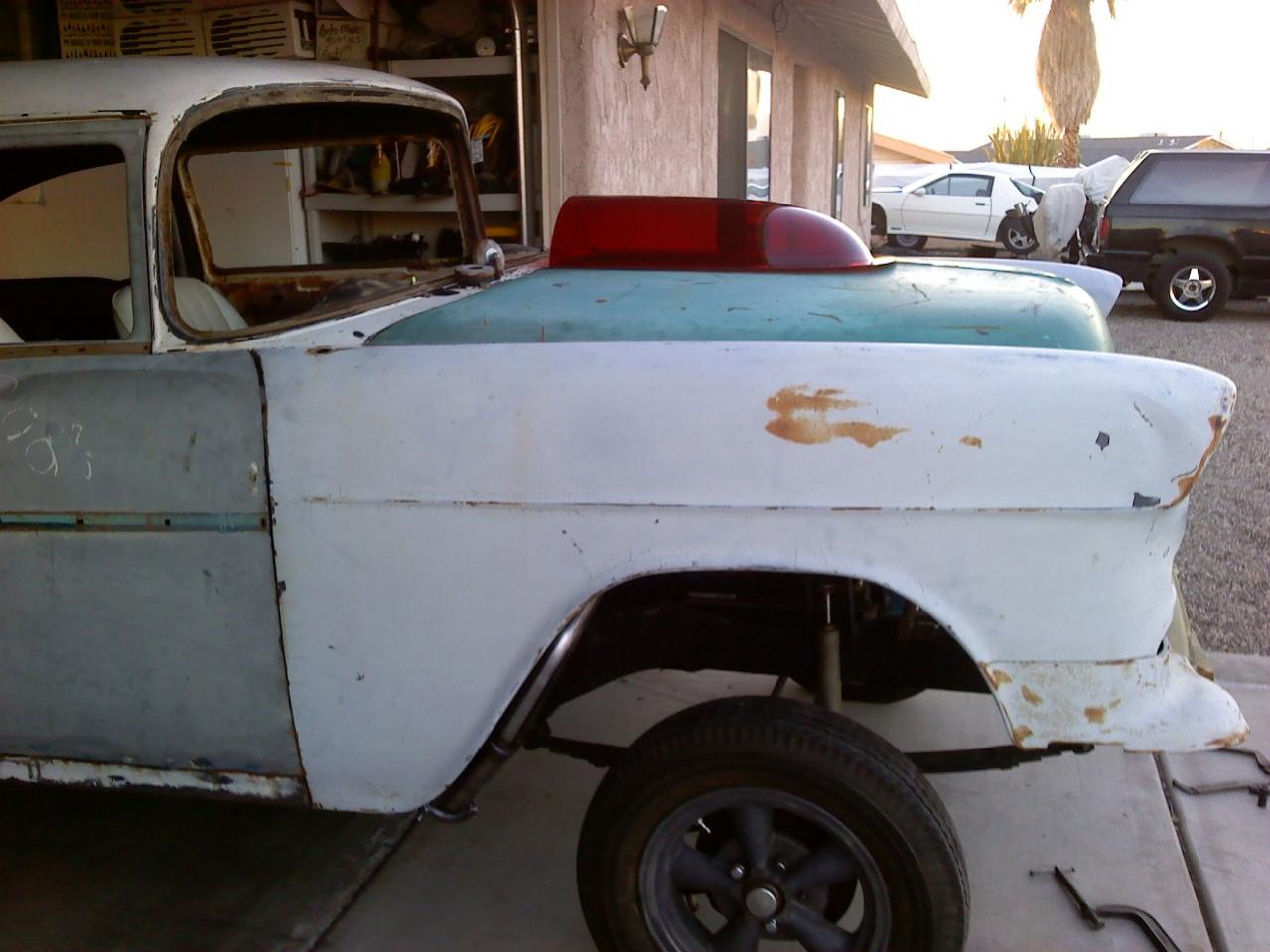

    gettin the nose fitted and finishing the tilt this weekend . it will roll forward few inches before tilting so when painted wouldnt scratch doors...
    watcha think about the lexan red scoop will match red windows when done..
  17. Looks the part, very nice , the scoop and windows will work!:)

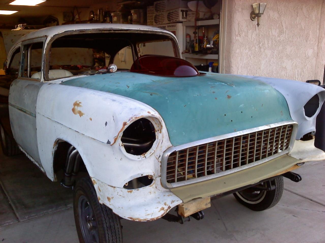

    the scoop mounts from under side of hood so the flange will be hidden . I should have some better pics this weekend when I go to work on it. Thanks for the likes..:D
  19. ....nice touch with the lexan scoop and red tinted windows idea......thats a big thumbs up.

    Very impressive work. Saving a rough '55 and creating a cl***ic g***er. Keep the progress photos coming, I love it!

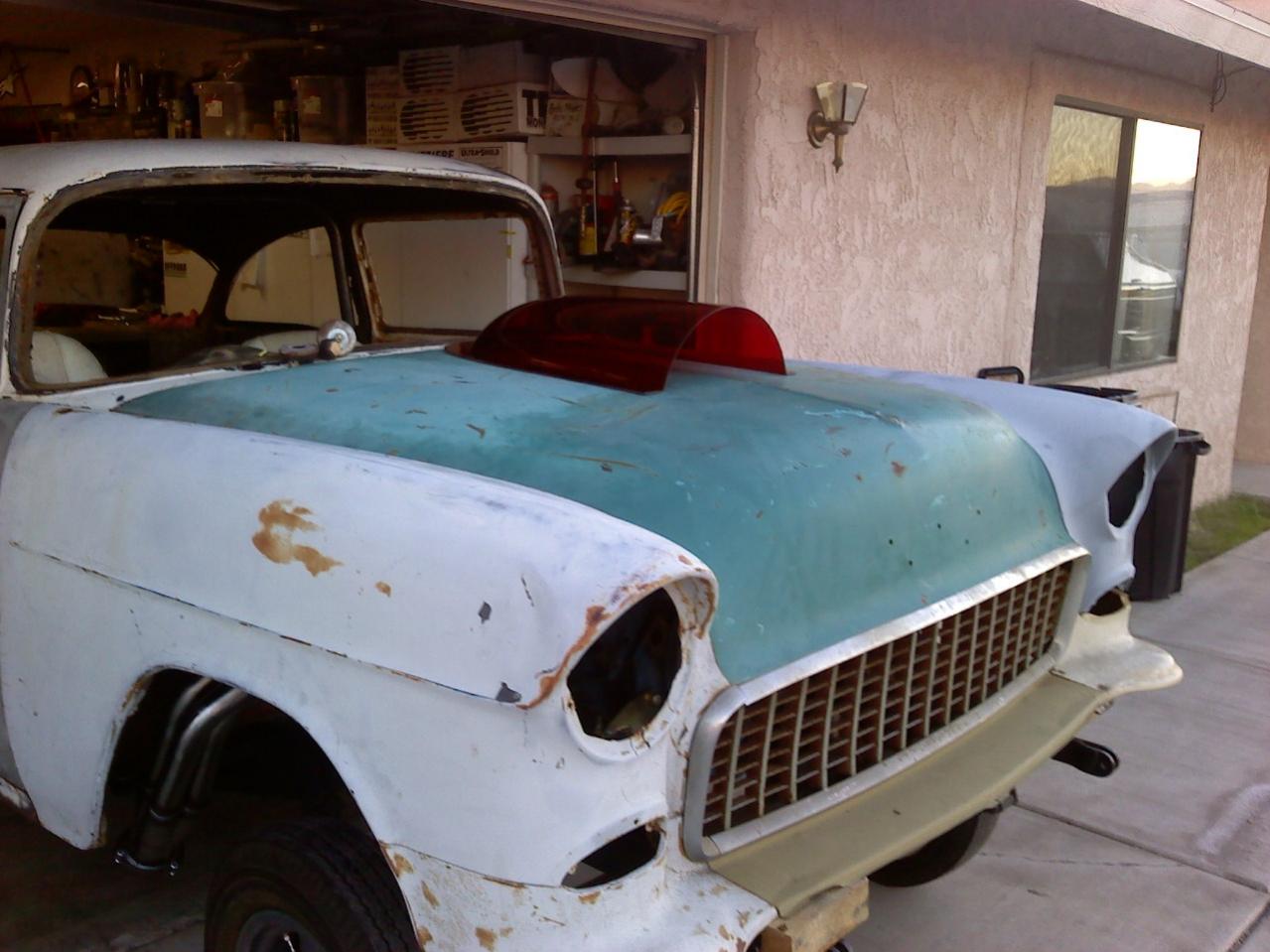

    What's the scoop look like with the opening foward? I think it will look better that way!

    kinda looks wide mouthed....also it would have the high pressure from windshield facing backwards ...the wind hurls over hood on these cars and hits gl*** anyways..but here u go.

    You're right. After seeing it forward, it doen't look a nice as rearward.
