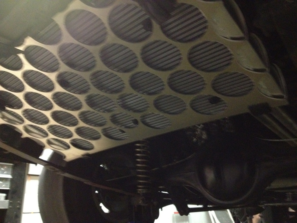

    After studing your build how well is the rear mounted radiator working without any opening in the trunk lid like I have seen ours do? The more I look at this build it is just bad *** build.
  26. ottos
    Joined: Jan 25, 2011
    Posts: 278
    ottos
    The radiator is where stock fuel tank was and it's on a angle so it scoops air from below car and pushes thru.. Also had two pusher fans and 24 feet total of thin aluminum 1 1/2 in piping to run cooling to the front and return to rear.. Runs too cool most times... Don't even turn fans on...
