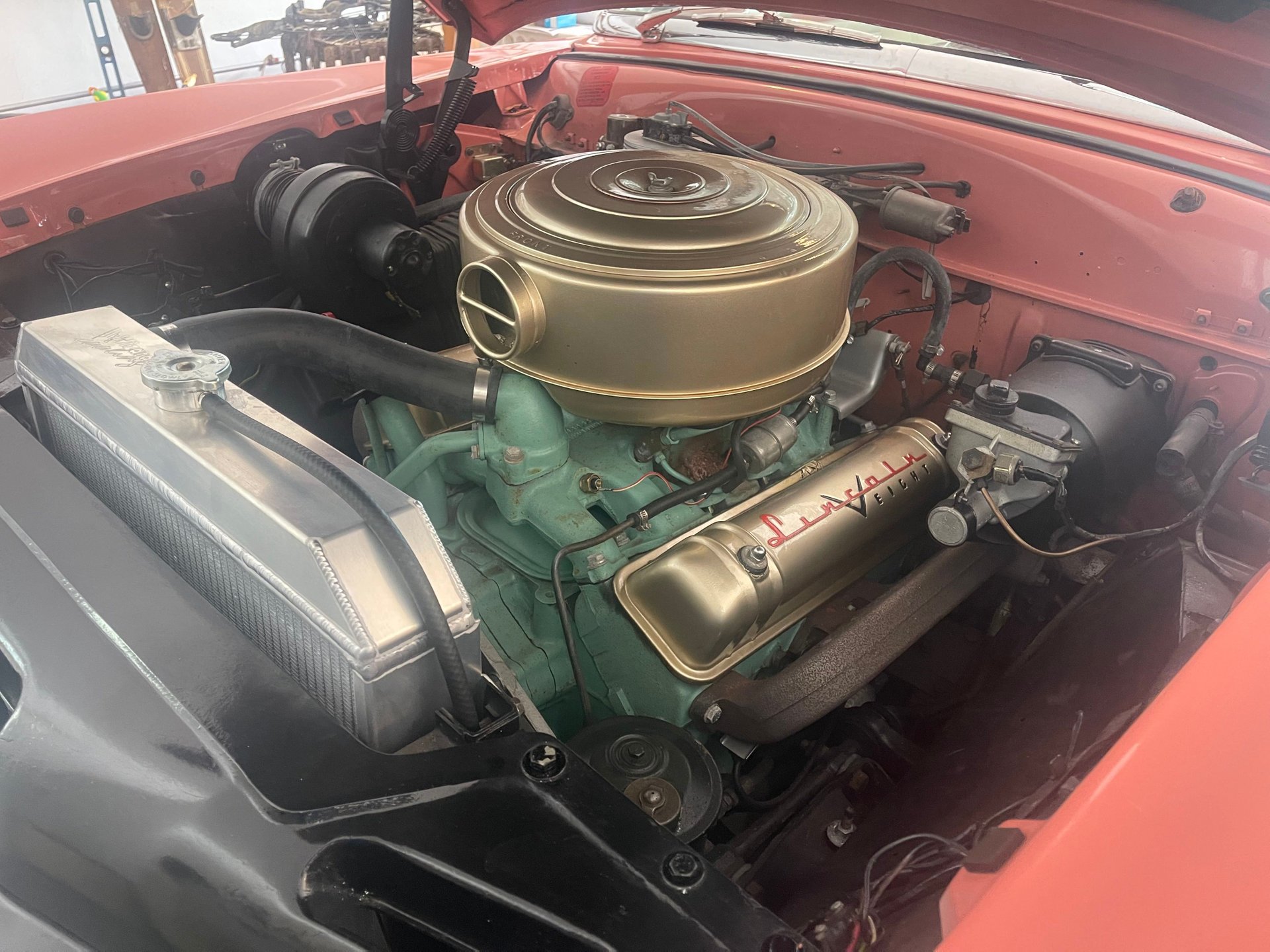

    This is the original setup, correct (ignore the aluminum rad)?

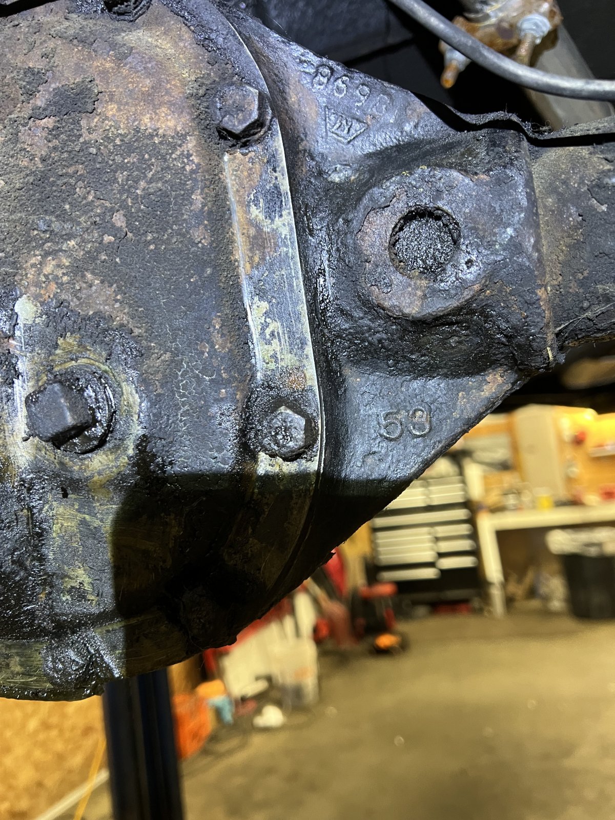

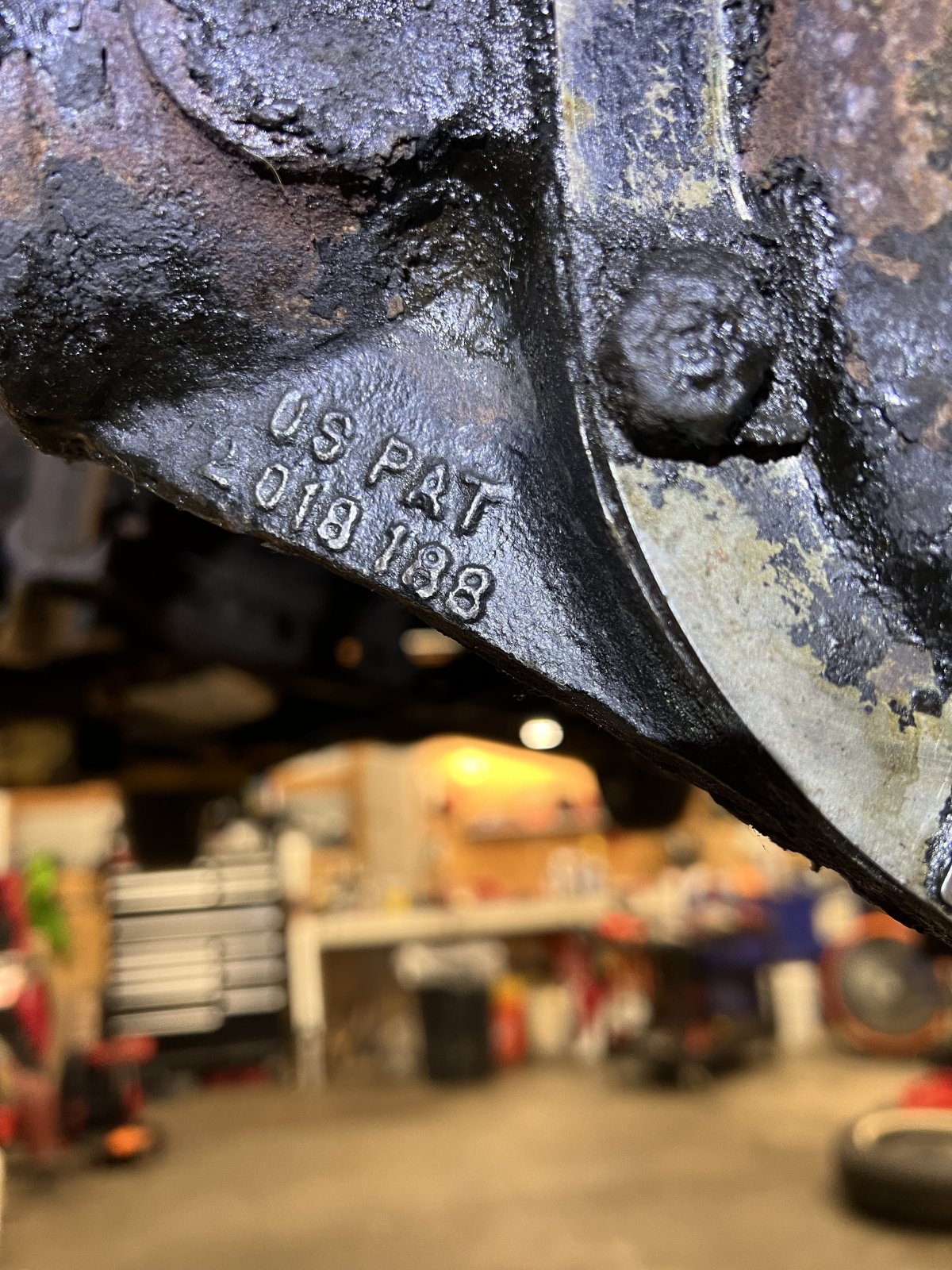

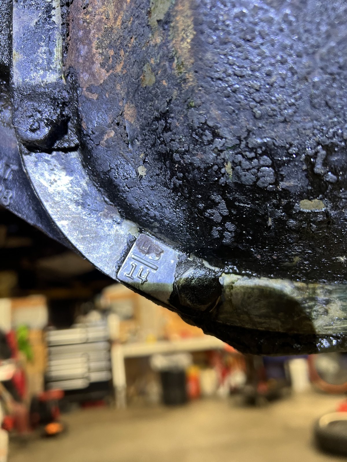

    Just to add another wrinkle while you’re picking an engine. Those Lincoln Y blocks made their living on torque, not horsepower. The rear axle ratio reflected that. Depending on model and who you believe it’s either a Dana 45 or a Dana 53. Either of those might be a parts problem for a ratio change. That would really play into a 302/AOD combo in a 4500lb car.

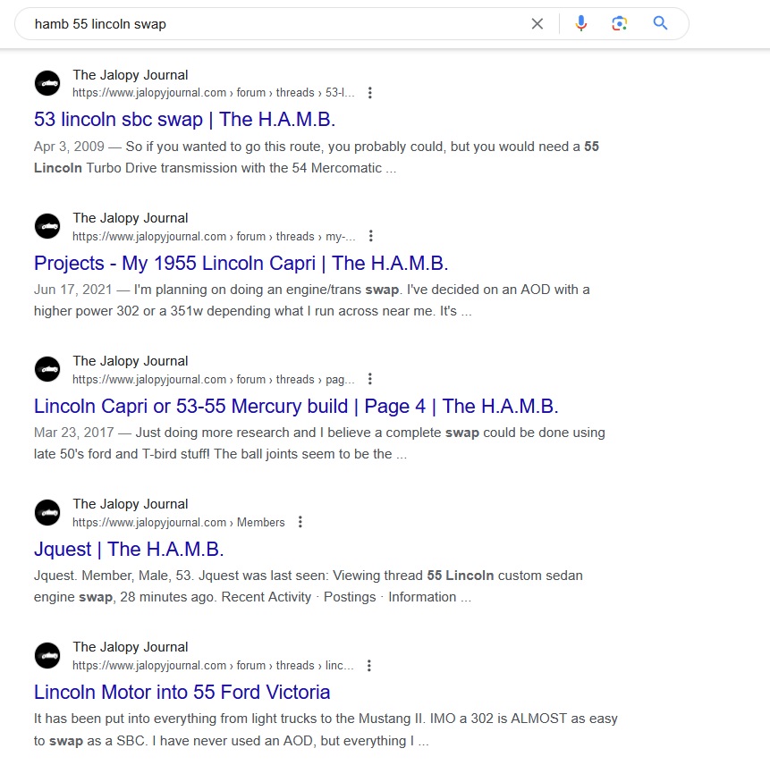

    Sometimes using google to search works better than using the hamb search. But be sure to include "hamb" in the search line.
    this is a picture of a quick search, I don't know if you've look for it this way or not
