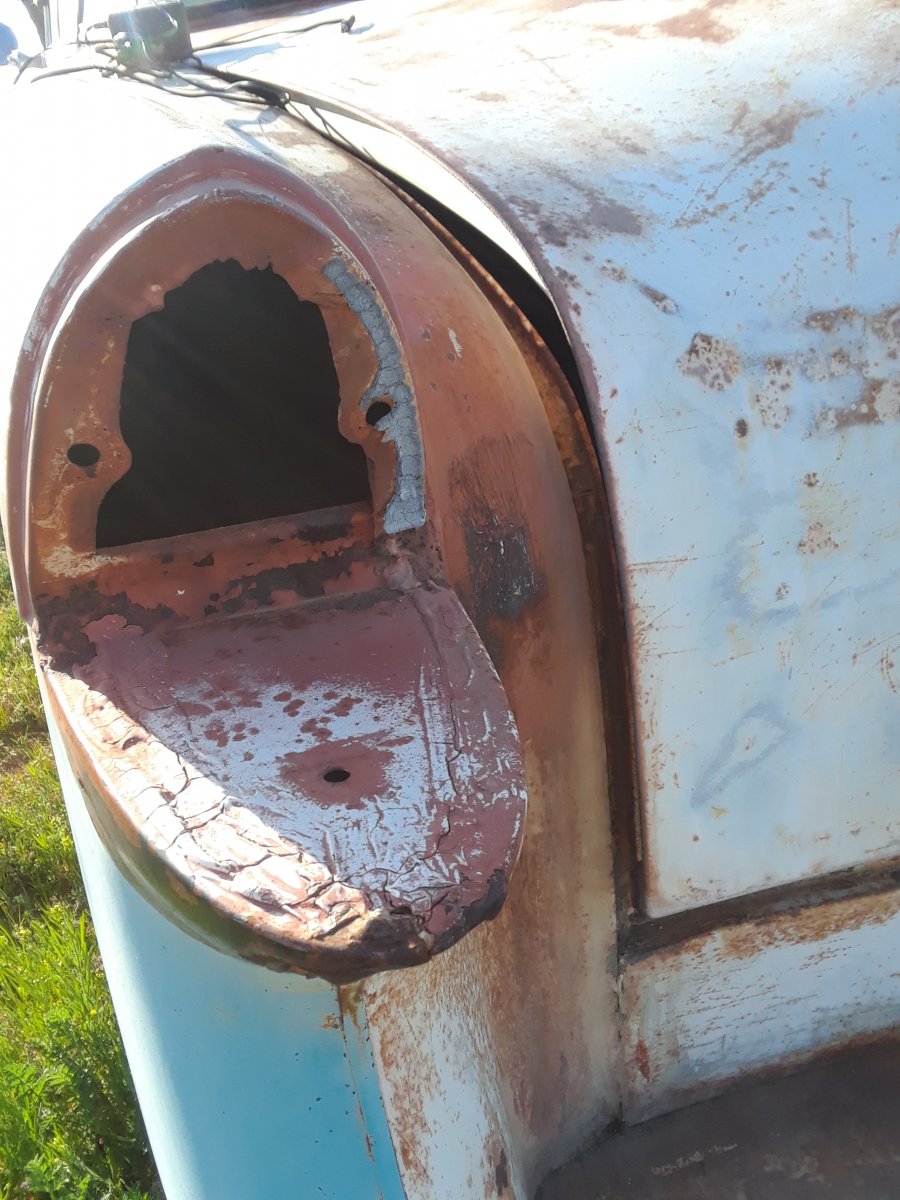

    This was just leaving my moms house. The wife told me to put it somewhere its not visable lol.
