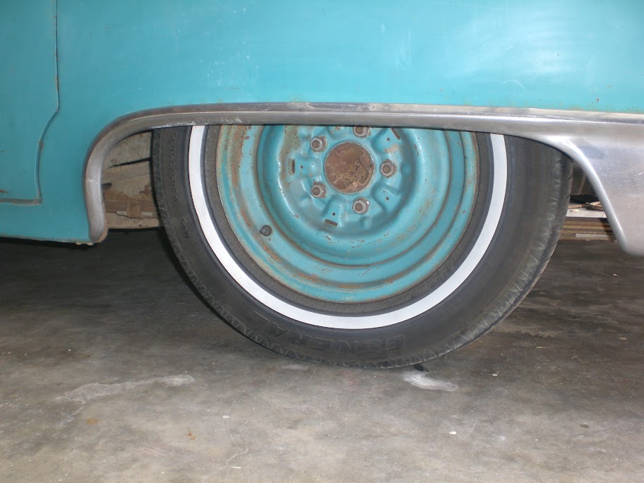

  16. Here's a couple pics guys, lowered it 2" in the back.
    The $30 Autozone block & u-bolt kit worked perfectly, fit the springs exactly.
    Heading up to Good Guys in Del Mar this afternoon. I'll get some better side shots and post them with the before pics.

    Glad that worked out for you, Looks much better so far!

    Looks good out back, so what are you going to do up front? leave it? cut a spring or have a set custom built?

  21. Heres a couple more side shots, not great though.
    Sorry I'll take some good ones tomorrow and post a before/after.

    That looks pretty sharp! How's the ride quality?
