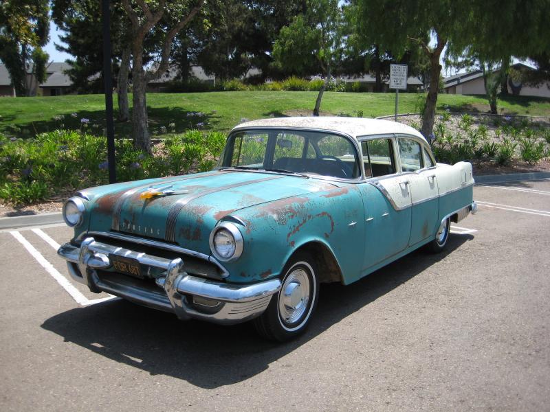

    Here she is by the way:

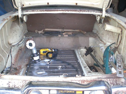

  19. Well got the tank in.
    I didn't use any sort of sealant under it yet, may pull it up this weekend and put something under it.
    It seals well to the flat trunk floor as is though.
    I'm gonna move the filler neck out towards the trunk opening farther too, but this will work for now. I will add a vent too this weekend.
    Here she is underneath. It actually sits about 1/2 " higher than the lowest point, which is the spare tire mount. So I'm not worried about it dragging when I lower the rear.
    Heres the hole:
    And the 65 Mustang gas tank kit from California Mustang ($209 shipped I think)
    I still have to plumb the fuel line and hook up the sender this weekend, and vent the filler tube, and then figure out how the hell to get this sender to work with my stock gauge.
    Thanks for the help and I hope this helps anybody looking to do the same.

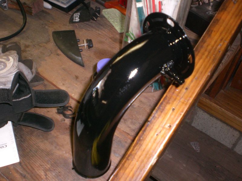

  25. Hey guys another quick update.
    I drilled a hole in the filler neck, and welded in an air line fitting I had sitting around, and then ran my vent tube out into the fender.
    This is temporary, I'm gonna relocate the vent line. I'm still looking for a gas cap to the fit the 66 Mustang filler neck that is sealed (non-vented cap).
    Heres a couple pics of the vent fitting (note, I'm a horrible welder, so please excuse the really crappy weld around the fitting!)
    And finally, heres a video of her running again!

  26. Heres some better pictures of the vent fitting
    Forgot to mention, I've put about 30 miles on the car since the tank yesterday and today, and she drives like a champion! Its really amazing how well preserved this thing is after sitting in the desert for 40 years.
