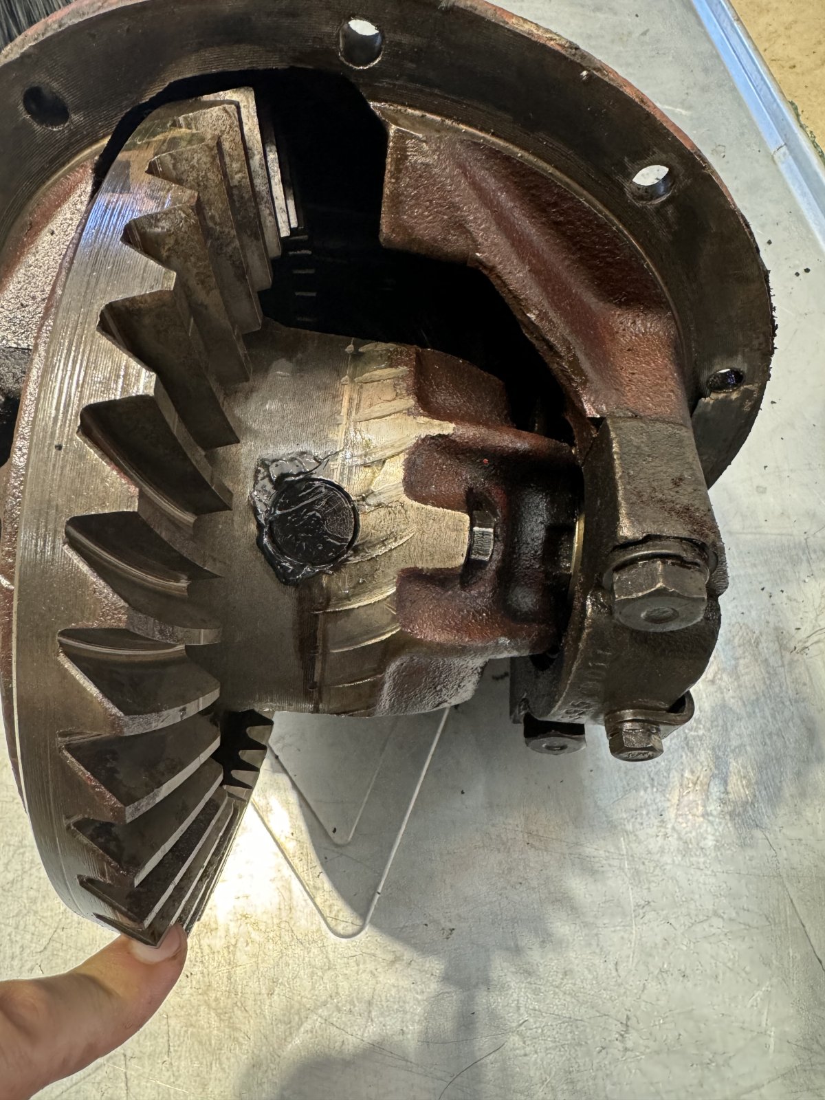

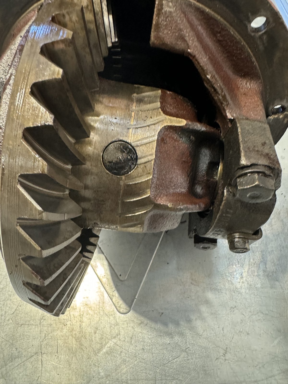

    I cracked open my original 55 Chevy truck differential and noticed these marks on the carrier.
    any clue what caused this? I do not see any damage or wear on the pinion or ring gear. No foreign objects in the diff. Just curious if anyone has a clue.

    The pinion nut came loose at one time, and then it was repaired.
    I've seen that a couple times
