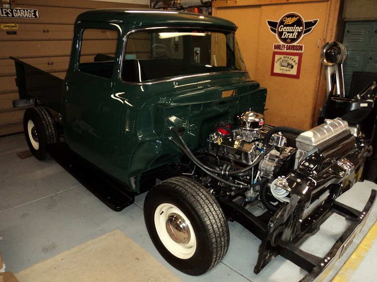

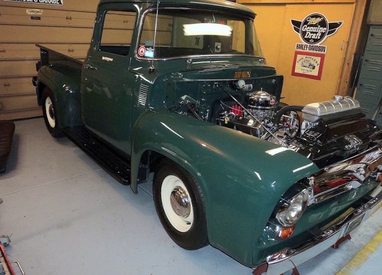

    A quick update..Rebel wiring kit almost done. Damn I work slow!! Inner fender panels are cut out for the IFS edged with slotted rubber trim from Steele. Lights and panel are all individually grounded to the frame as is the engine and cab all in the same location with the battery ground. Nothing too flashy I suppose, matter of fact still debating on beauty rings. Just want a nice smooth sleeper style for this truck that has so many memories for me.

    Trying to decide if I need beauty rings or not. They can be a pain to fit. What do you guys think? If so who sells the best ones?

    I'd forget about the beauty rings. It has that classy truck look just fine without them, and nobody likes seeing their rings spinnning down the highway in front of them when they let go...

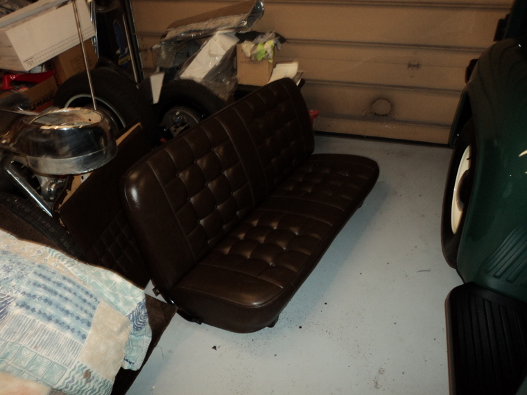

    Coming slowly..Wiring finished..engine fired..20 year old seat still looks good and goes in tomorrow. Plaque is my old club back in the fifties and still active. Some guys hang them on their walkers.:D

    Seat is in and gives plenty of room for access to the fuse block (whew). The plate topper is a 40 year old piece from the fist squadron I flew with. The wheel pics show the install of a 70's Chevy spline to fit the stock 56 wheel to my Flaming River column.
