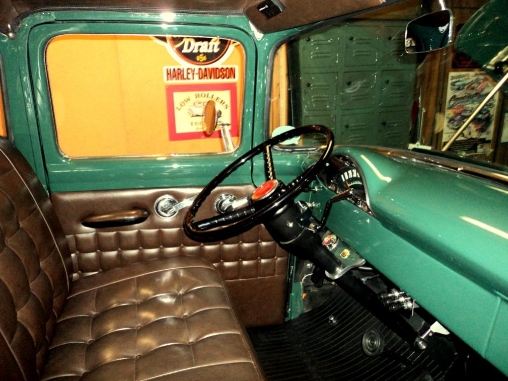

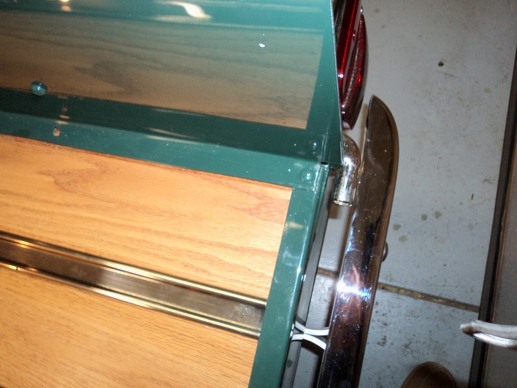

    Bed wood is in place for trial fit before oiling and sanding. I'm not too keen on the shiney clear coatings anymore. Rather just periodically re-oil. I like the light oak color so wont be going too dark. Ro (my wife) has volunteered to do the finish work..which is good since she has more patience than me. I really like the hidden bolt bed strips because they give me some flexability needed due to the under bed tank. Installing the seat belts also.

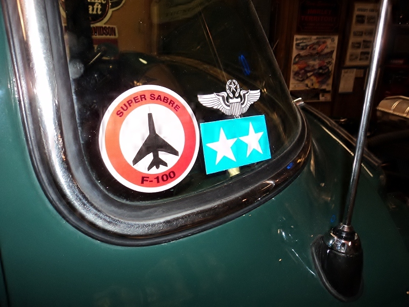

    A few update photos. Man do I work slow! The front tilt hood prop is a 36"x 3/8" swedged alum. rod that hooks to one of the original rear hood hinge brace bolts. super stable for any wind gusts. The light oak bed was sanded and finished with Watco clear Danish oil by my wife Roberta. Interior is done except for carpet. The last shot of the decal shows that I might be too old to fly the "Hun" anymore, I can still drive one.:)

    Happy with the stance and the So-CalAz wheel rings. The end strip on the bed was cut to allow it to fit level with the side flange.(no end wood reveal cut). Just didn't care for the recommended Mid Fifties overlap look. Nit picking I suppose but important to me. Sure glad I moved the front wheel center-line ahead 1- 1/4" when I installed the Heidt front end. Doesn't look as nose heavy.

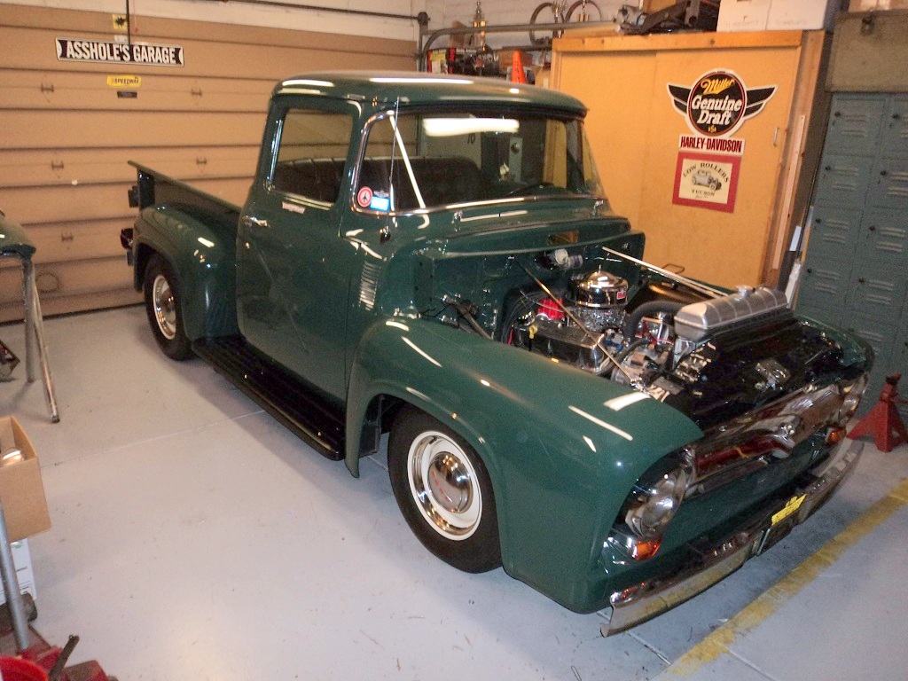

    After 6 years Ol' Green finally took a drive around the block..no problems and nothing fell off!! Now it's time to start putting all the pieces together I have for the 32 full fendered roadster. I'll start a build thread soon. Thanks to all my HAMB friends for the support. Bill

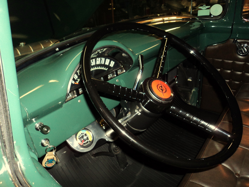

    A few updates. The stock wheel is mated to the Flaming River tilt column. And a pic after it's first drive in 5 years. Thanks to all you guys for the advice and encouragement. Bill
