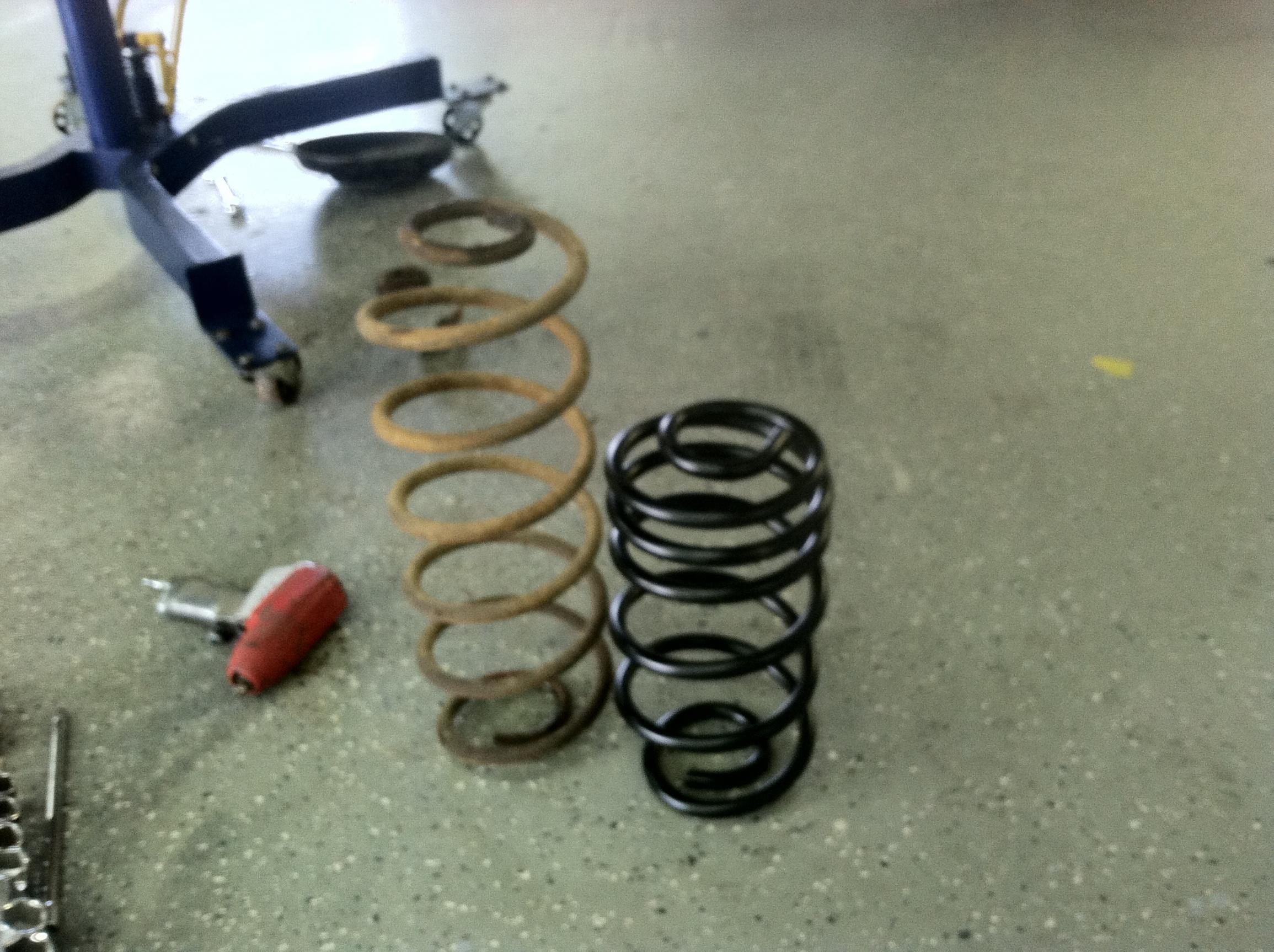

    A couple of you guys out there wanted to see more pictures of my Buick, and I'm working on it this weekend so I thought I would take some pics. I bought a lowering kit and am in the process of installing it, 3" drop springs with a 30% stiffer spring rate. Here is the rear, still need to install the front kit.

    Here is the difference between the new and the old. Yup I'm 23 years old and this is way more fun then going out bar hopping and getting drunk.

    Btw...Did Buick still use lever shocks in '56? If so, then I guess you don't have to worry about using shorter shocks. Even if it has tube shocks, due to the higher spring rate, you might not need to change 'em.

    Well got the Buick lowered 3" over the weekend. Looks really nice and drives just like it did before , actually a little better because the original front springs were so worn out.

    No this Buick had normal shocks not never style shocks, the kit came with new shocks so I decided to put them in because the car was torn apart. And thanks for the comments, I know I'm a youngster and not a lot of people my age appreciate the classics but I sure do!! And I'm having fun with this car!
