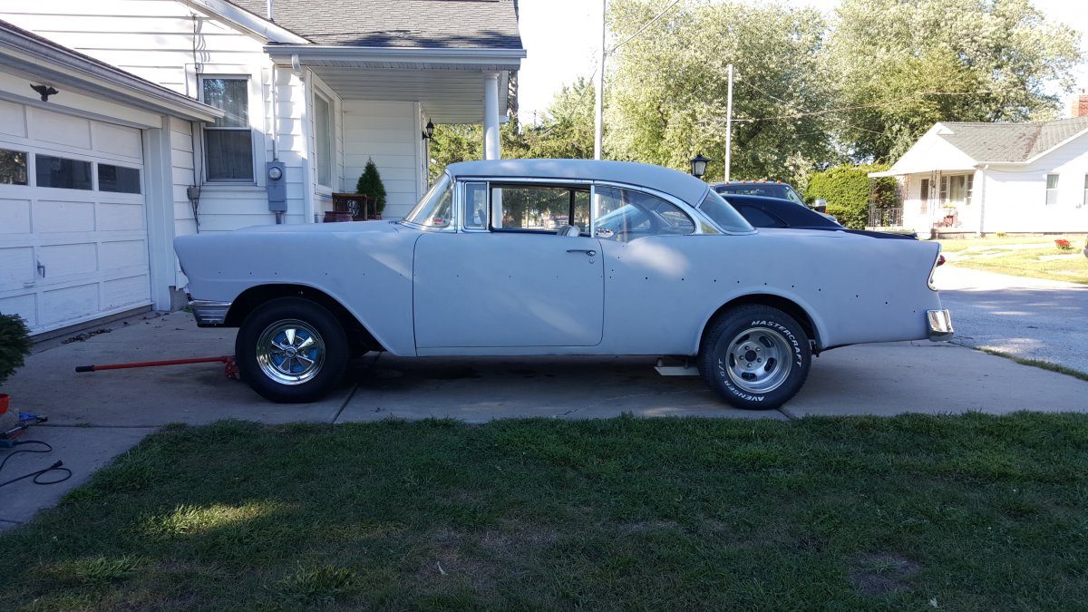

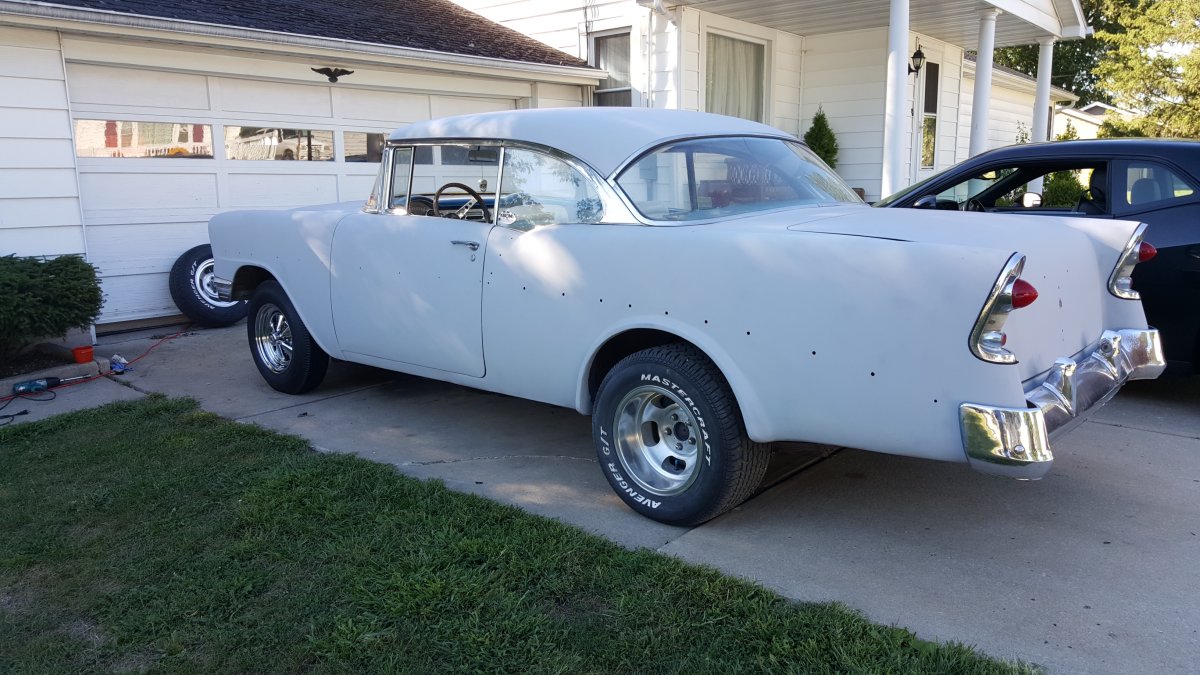

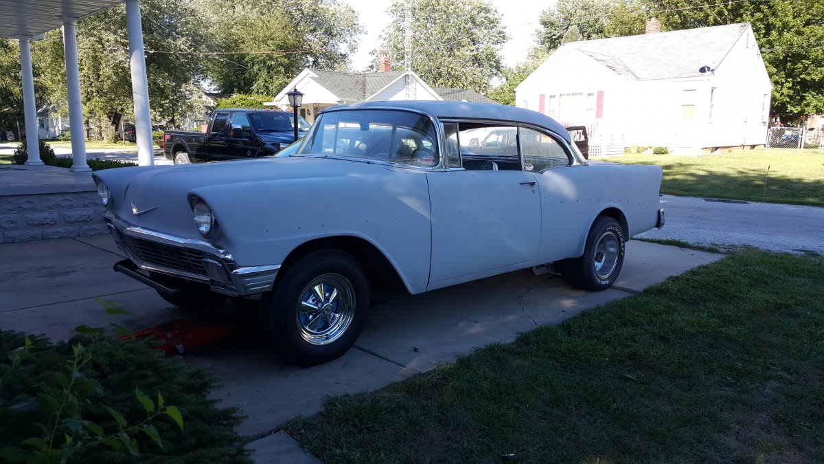

    Well today I decided to take the Cragar S/S wheel with a 7.10-15 Firestone Deluxe Champion I use as a spare and see what it looked like up front. I have to say I personally love the way it turned put and am going to have to put money down to buy the same wheel & tire combo. However I can't find one of these tires for sale anywhere on the web 20150913_163300.jpg 20150913_163309.jpg 20150913_163317.jpg

    Those wheels look great on the front!
    This is just my two cents worth,but I feel like you could really make that car stop people in their tracks if you opened up the radius on the rear wheel openings a bit and put a taller tire like a 29"or 30" tall tire in there.
    I know it's not in the budget right now,and you're doing a great job building on a students budget.
    Your and for the paint and lettering are right on the mark,too Man!
    You're gonna have this thing looking really good,and very authentic in no time!

  20. chevy57dude
    Joined: Dec 10, 2007
    Posts: 9,651
    chevy57dude
    Another vote for the Cragars here! Tri 5s look so right with 'em.
    Got a set of of them for the Chevy squirreled away in case I ever wanna change the look.

    Back to your cragar post, Did the back of the tire rub the A arm with that ball joint spacer or is that wheel the rite backspace?
    Smoothy likes this.
  23. Smoothy
    Joined: Jun 18, 2015
    Posts: 338
    Smoothy
    Yes that wheel worked out with the spacer, but I think part of that is because there was a wheel spacer behind the slot mag that I also used for the cragar.
