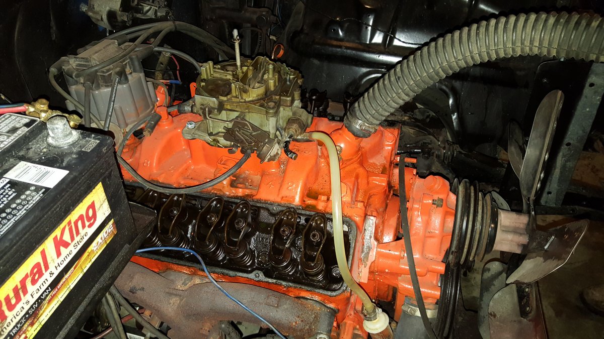

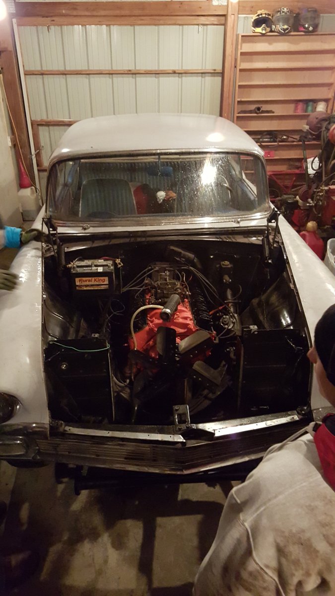

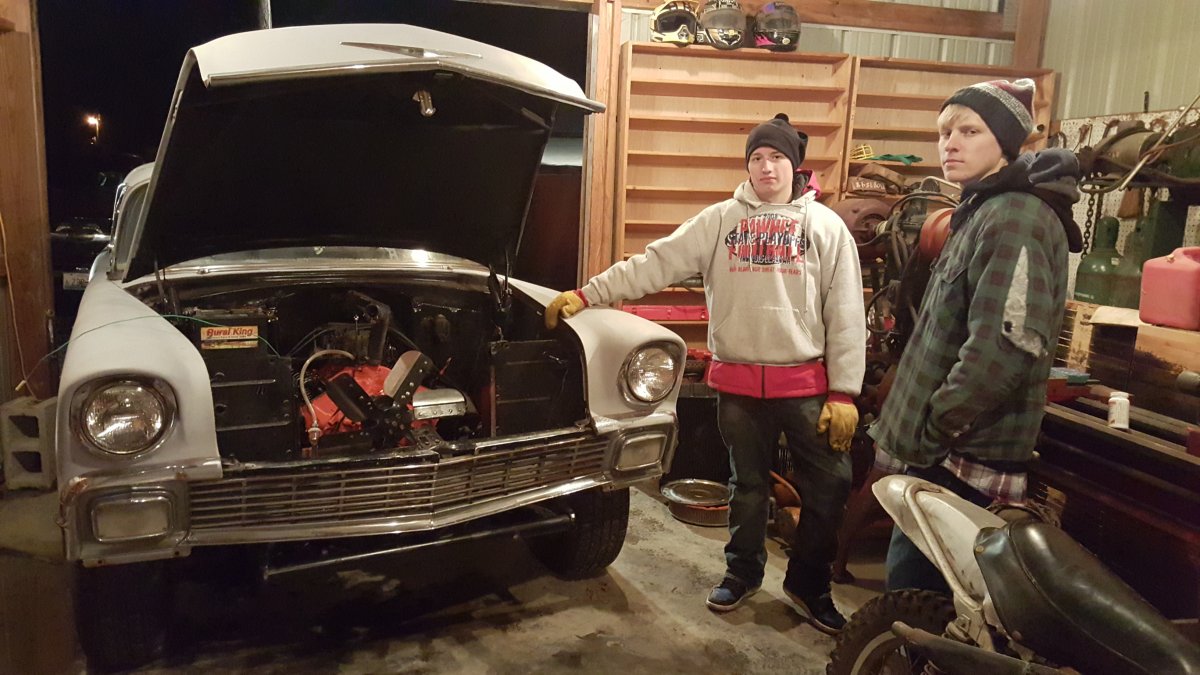

  24. Smoothy
    Joined: Jun 18, 2015
    Posts: 338
    Smoothy
    Above are a few photos of today's progress. My friends Kevin, Dylan, and Alec are all home on break for Christmas, so we decided to take advantage of that and get the engine out of my car and built. We got the car in the garage, and are ready to pull it completely by tomorrow, get the heads off and see what we're dealing with.
  25. Smoothy
    Posts: 338
    Smoothy
    I've run both of my cars with a similar setup, where would this be an issue? It's far better than the piece of washing machine hose that I had replaced.

  27. powrshftr
    Joined: Mar 29, 2013
    Posts: 4,551
    powrshftr
    The tech guy at the track won't be diggin' it,but I've put thousands of street miles on similar stuff.
    Make sure there's no place it can chafe or wear through against a frame rail or something.
    And that is super cool to see your buddies over there helping you out....Nothing's more fun than working on the car with some buddies.
    Well....Maybe the first time you and your buddies take it out for a rip,or take it to the track.:)
    Nice job so far.Keep us posted!
    Scott

  28. Its best if you only have a steel line between the fuel pump and carb. There is fuel under pressure and under hood heat and age and the pulses from the fuel pump can cause leaks. Better to use a metal filter between the fuel tank and the fuel pump. I would just hate to see a car burn when it can be so easily prevented.
