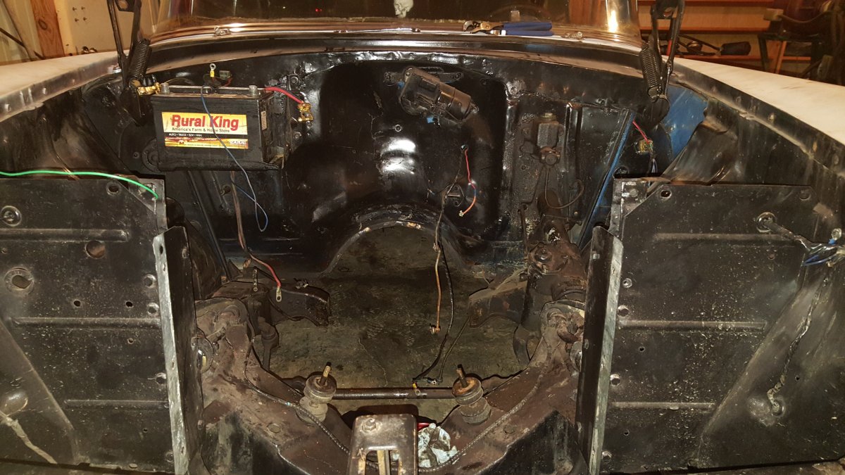

    Upon thinking about it, the car does have a metal line run all the way from the tank to the fuel pump, so really it won't be much work to make something to go from the pump to the carb. Maybe I can use a piece of braided fuel line? It will be much easier to fabricate something with the motor out as it is now, as I'm sure there's plenty I can do while waiting springs, retainers, and keepers to get here for my heads.

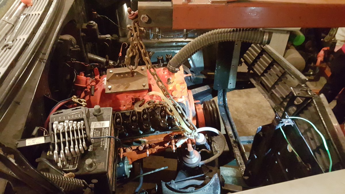

    20151228_200749.jpg the motor getting ready to be hoisted out (you can see metal line to fuel pump from the tank between the starter and the fuel pump)
    Kevin, Dad, and Alec using the new (to us) 12 ton engine hoist we paid $100 for
    Motor and trans are out!

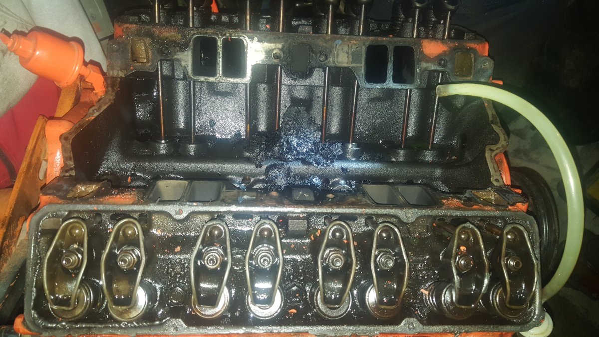

    Intake is off, discovered that burnt looking substance in the valley. Almost like burnt paint (lead to believe it is because whoever painted this motor pained the entire thing orange down to the distributer and the plugs...) or some sort of substance. It was crisp like overdone bacon.
    I now have the heads off and discovered 3 white (which I think means burnt) exhaust valves on each of the 993 heads. The piston and cylinders look good however and don't have any marks leading me to believe there isn't any damage. Cylinders could probably be honed .30 with new pistons but it isn't in the budget at the moment. I eventually dropped the pan after finding that burnt stuff only to find very little in the very bottom of the pan. Plan on using a deeper pan anyways. More to come soon!

  4. That burnt stuff is oil that has been cooked from coming into contact with the heat crossover p***age in the intake. There is supposed to be a metal shield to prevent the oil from making contact. white color on the exhaust valves simply means they are white. The cyl is burning good & hot. White color doesnt indicate burned valves. Its impossible to hone a cyl even .030. that is thirty thousands the only way to remove that amount of metal is a machine shop boring machine. .30 is 3hundred thousands and you would strike water jackets if you bored it that amount.

    So did you cut the radiator support to remove the engine or was that done when you got it? A very popular thing to do back in the good old days when you were removing and replacing the engines in race cars all the time.

    Thanks for the clarification on the burnt substance. Also meant .030 over, plus I also was under the impression that boring and honing were the same thing. You know how the saying goes...
    I actually just removed the top bar that runs from fender well to fender well, 8 easy to access bolts, nothing difficult. I think thats what you're talking about. Also the radiator mounts in front of the support bar.

  8. I ***umed you meant .030. A hone is used to scuff the glaze on the cyls. You hone the cyls when doing a ring job without boring the bloc oversize. If you radiator is in front of the support that's what is referred to as the 6 cyl position. That's what you want if you ever install a big block engine. Ask any questions you want. Im 64 and been nmessing with tri fives for fifty years. and I still learn new things all the time.
