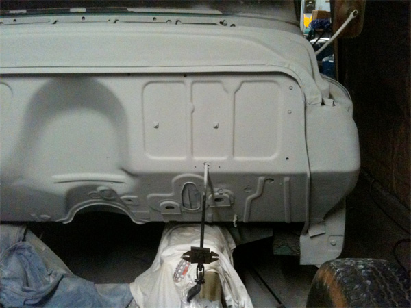

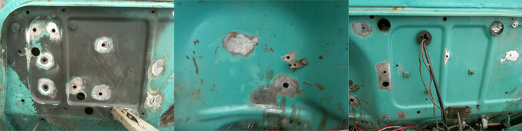

    UPDATE: after nearly 40 hours of welding, body filler, sanding, filler primer, sanding, body filler and a little cussing along the way, I have a firewall that is somewhat presentable. It's currently in primer and I hope to have it painted this weekend so I can get the engine back in and get her running and mobile once again.

    Your going about this the same way I did my 55. The firewall was the first paint shot after filling holes and hours of smoothing all the wrinkles. At that point, I had to decide the color (or go with an underhood color like black or white). That was when I finally decided red but almost 10 years later I still think about lots of different colors. No regrets really, just need about 10 more cars to put other colors on!

    My decision on the firewall is to go Chrysler Vanilla (think 2006 Charger, 300, etc). There are a couple reasons for this. First, a lot of old school rods did it this way...white or off-white firewall. Second, the firewall isn't perfect...it's good, a lot better in fact, but not perfect, and vanilla will not show the imperfections as much. Also, vanilla will bring some life and light into the engine bay and make the freshly painted engine pop. And last, I can do this in a single stage in an industrial grade that will resist gasoline and oil better and won't have to worry about trying to get pearl to lay down uniform on an erratic surface.

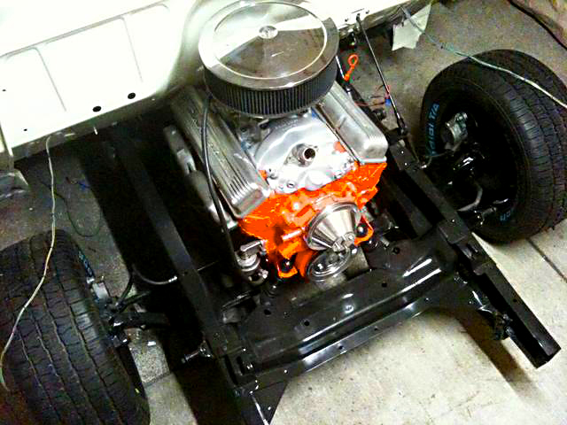

    I finished cleaning up and painting the front half of the frame this weekend, installed the rebuilt steering column and installed the engine. I have about 15 hours into the frame, 30 hours into the firewall and 8 hours into cleaning up and repainting the engine, bellhousing and trans. I figure another 6 hours into getting her running and then I'll clean and repaint the inner fenders and re***emble the front group.
    Hoping to be onto the interior by the first week in October and having the interior repainted by the middle of October. Man these things take time...

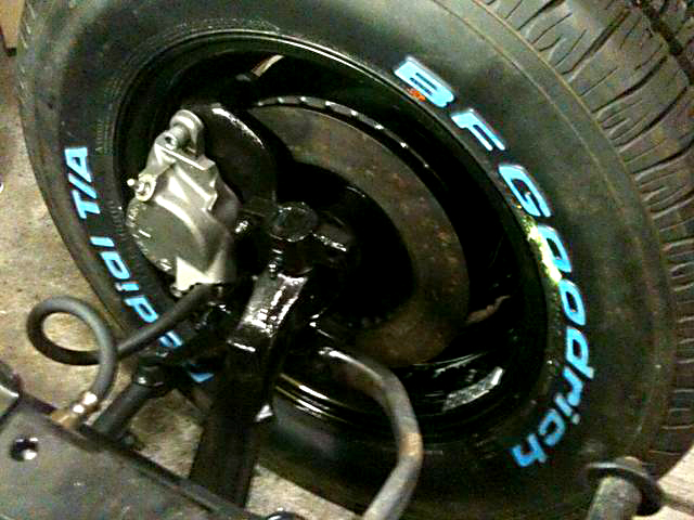

    I've gotten a few things done in the last couple of weeks.
    Attached all the new brake lines and had one of the bleeder valves rusted so tight that I stripped the nut trying to open it. Finally got it out and installed one-person bleeder valves on all 4 corners.
    Got my wheels painted and tires mounted all around. The front tires are 26 inches tall and the rear are 29 inches tall. The total track width on both the front and rear is 72 inches, which allows 1 inch clearance inside the wheel wells. The rear fender will hide the top 5 inches of the rear tire, the front tire sits 1/2 inch below the front fender opening.
    The front tires have 1/4 inch clearance to the tie rod. It's tight but I don't think I'll have issues unless one of the front tires goes completely flat.
