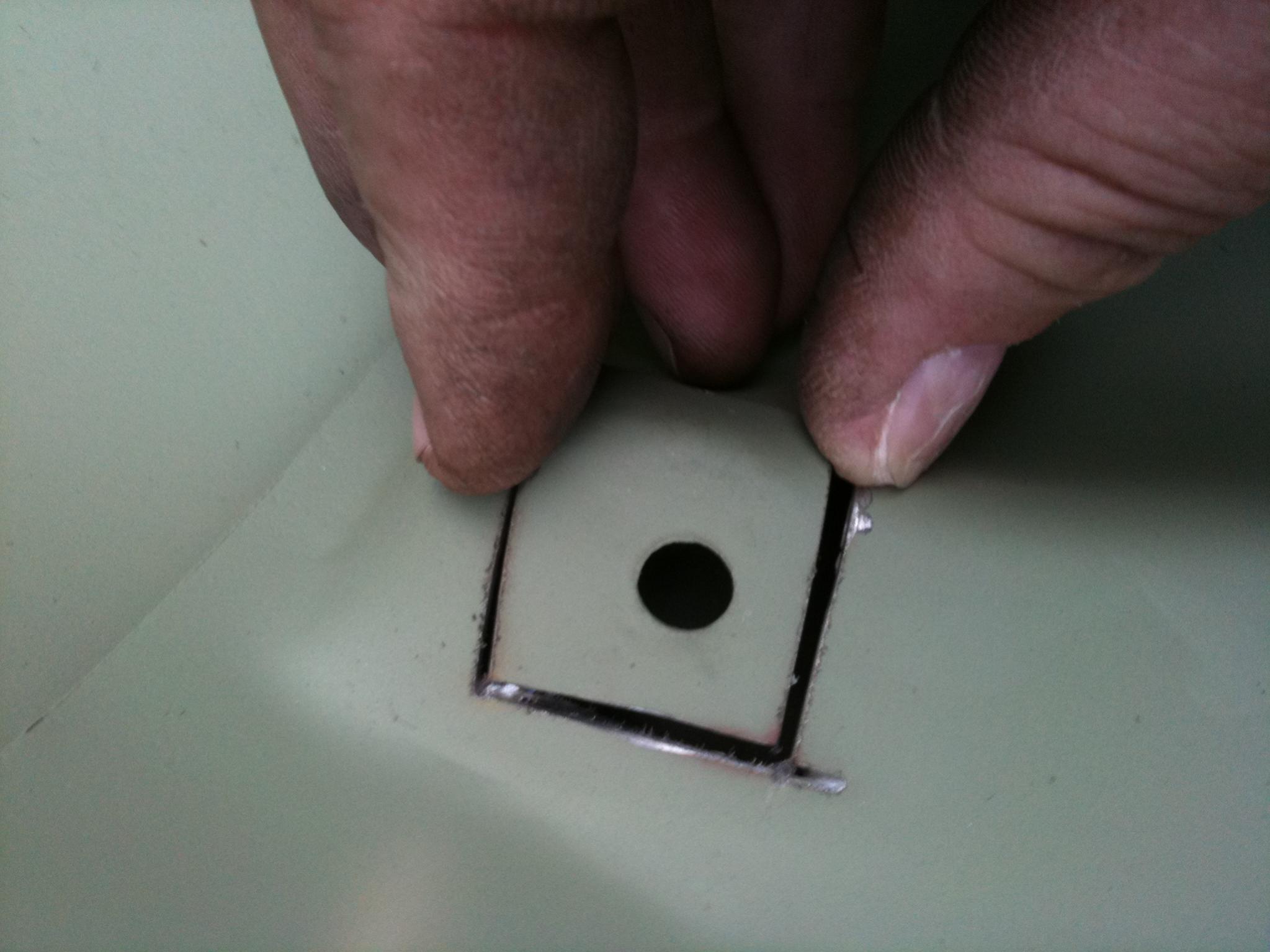

    One of the captive nuts inside the brace on my hood was missing. I had to cut the section out and weld a nut to the backside and weld that section of the brace back in. There really is no other way to do it.
