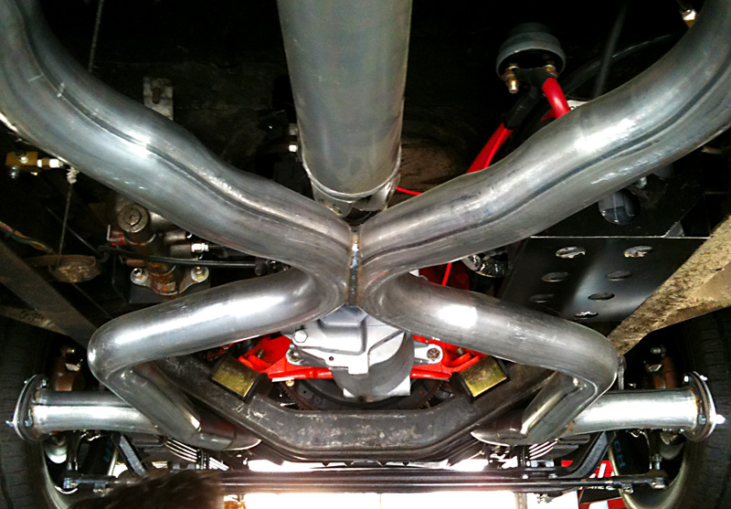

    UPDATE: It's been a while. I now have the windshield in, just got the exhaust finished - an x-pipe with cut-outs (for when I want to open exhaust) and SS Magnaflows. Sounds sweet...I'll post a video of it running soon. Here are some pics of the exhaust.

    I'm looking forward to the video. I'm on the fence between Magnaflows and one other muffler and I'm hoping to order them this week. Looks like a really nice exhaust set up

    The Magnaflows sound really nice, and the x-pipe evens out the 292 cam for every-day driving. That's the main reason I had the cut-outs installed, so I could hear the cam when I wanted to.

    is that 2 1/2" pipe? and what was the Magnaflow part number for the mufflers you used?

    Yeah, I used the 2 1/2" Vette style cast manifolds (I HATE dealing with leaking headers) and it's 2 1/2" pipes all the way out.
    I believe the part number is Magnaflow 12226. I've had Flowmasters and I like the sound and harmonics of these mufflers much better. Don't get me wrong, Flowmasters can sound great in the right application and on the right vehicle, but they would drone me out of my truck around 60 mph to where I would literally get a headache.

    I have the Vette style manifolds as well. It sounds like our exhaust notes will be VERY close in sound. I have a buddy of mine that is pushing the Flowmasters but the more trucks I hear with Magnaflows, the more I tend to sway my opinion their way. What kind of rumble do you get at idle?

    It was a buddy deal... He would have charged $450, which I think would be about right and well worth it, I got it for $250. (I supplied the Magnaflows at $80 ea from Summit)

    what size is the outlet on those tips?

    The inlet and the outlet on the mufflers are 2 1/2", the salami-cut chrome tips are cheap NAPA parts that are sized to slip over 2 1/2" pipes.

    but the outlet on the tips looks to be about 4". That's what I was asking about. I bet that adds a little more bark onto that exhaust

    That's an optical illusion, although megaphones would have been cool on there come to think of it. They are the same diameter front to rear, the camera created a wide angle effect, and I'm sure the salami cut also increases the optical illusion.

    I see a lot of red cables under the truck in the exhaust shots in post #182. I ***ume they're battery cables, but it looks like they're going to some sort of central location, are they? Why?

    The cables are all going into and coming out of a master kill switch that is mounted to the floor with the switch accessible from inside the cab.
