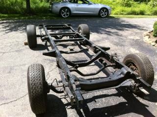

    I am just getting back into mine. Here it is right now before I dropped the cab on this weekend. I flipped the stock rear axle just to see how much drop I would get. Also I flipped the rear spring perches too. Looking for a rear end if anyone has one around Michigan area. I have some 18 " Camaro steel wheels and and tires I would like to use.
    Up front I would like to use your theme with posies, a drop axle and a sway bar. I heard Sid is an awsome guy to deal with. Just a little leary of running a bent axle. Have you had any problems with yours? CPP has an aftermarket one but you dont get that I beam look : (.

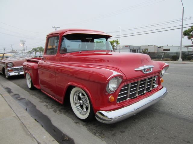

    I saw this beauty at the Mooneyes BBQ. I love the color, scallops and pin stripping.
