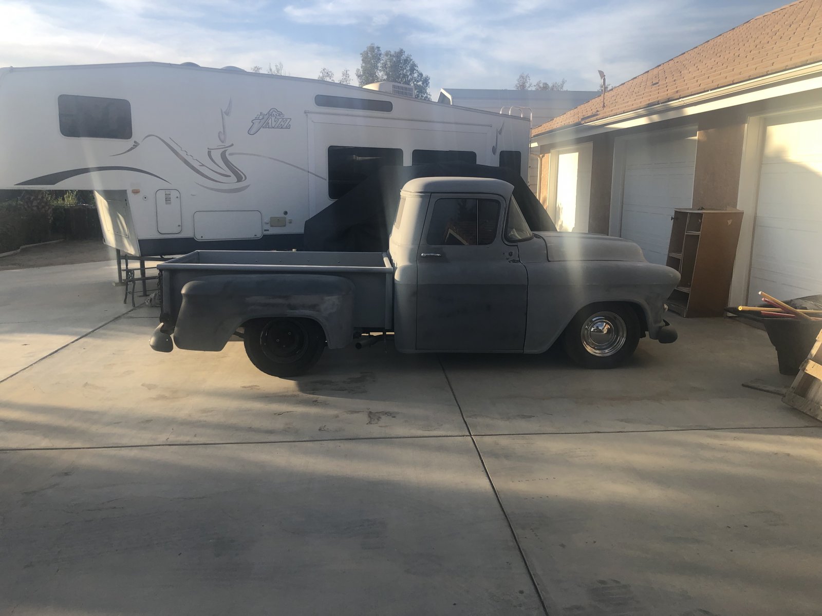

    Hey guys I’m kind of lost on what to do about my bolt patterns. I have a 56 chevy truck with the dropped axle and front leaf springs. I put the disc brake conversion kit on it from speedway which makes it 5x 4.75. The rearend is a GM 12 bolt which is 5x5. So I have 2 different bolt patterns and I don’t want to carry 2 spares lol. I was looking on speedway and they sell a 5x5 rotor can I just swap out rotors and get the correct bearing for my spindle? My other option is replacing the axles in my rearend but the quote I got was $1500 to do that. I’ve heard of have the rear bolt pattern red rolled to 5x4.75 but I couldn’t find anyone to do that. Thank you any help is greatly appreciated

    I contacted speedway but they told me the 5x5 rotors wouldn’t work because the bearings don’t work with the original spindle. I was thinking why couldn’t I just use the inner bearing and sleeve I had to use for the 5x4.75 rotor. But I’m not sure
    At this point I’m thinking switching Rearend’s would be the easier option
    or I guess if I do have a flat just call AAA lol. And just deal with the 2 different bolt patterns.

    Jeff56
    I have zero room for a adapter. My truck is super low as it is. I either have to take the wheel stems out or take the bed off to change the tire lol
