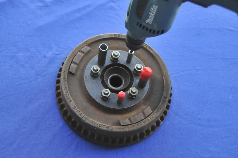

    I would think any automotive machine shop should be able to drill your rotors or axle. No shipping involved if you can find someplace local.

    Again, if nothing will satisfy you except having all 4 wheels use the same bolt pattern, you are going to have to spend a little money to get there.
    If you just want a spare that fits both ends of the vehicle, get a $50 used aluminum wheel like I posted above. Then get a plastic wheel pattern identifier for a 5" pattern. Probably about $5. Center it on the wheel and use a transfer punch ($25 for a set from Amazon) to locate the holes. Then your trusty drill to poke some holes. Simple, cheap, and you get a couple new things for your toolbox.;)
    One other thing to consider when you change rear ends or redrill your current axles, does the center register on the axle also fit your wheels of choice?

  14. Or an afternoon with a drill press and center punch !!

    I agree. It seems so much simpler to just buy 10 new studs and redrill your original rotors to 5 x 5 , than to change rear ends. And, if you're not comfortable doing it yourself, there must be a half dozen machine shops in your area that could do it...it's pretty basic stuff.
