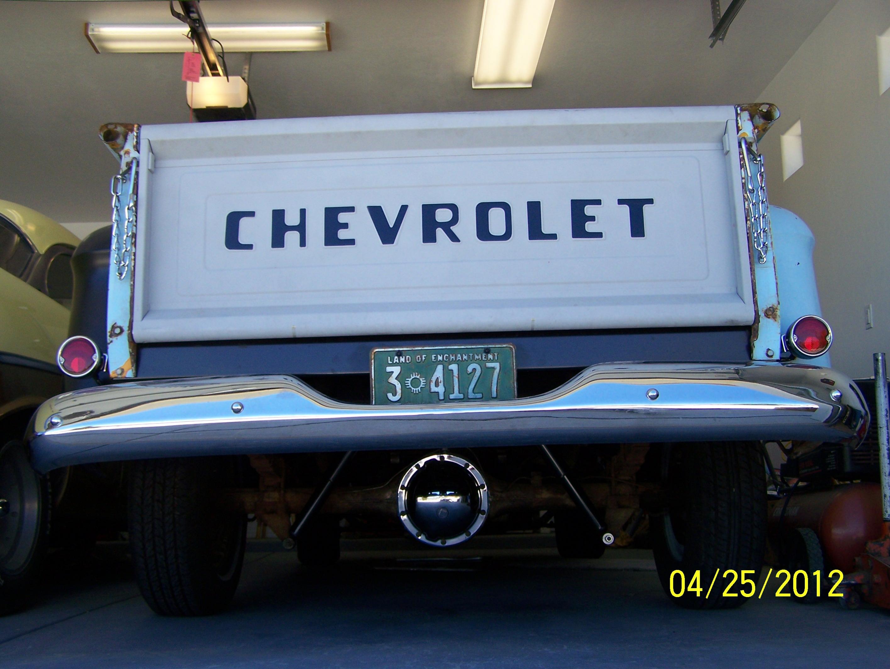

    bought a 56 chevy truck with a 70's 12 bolt rearend, it sits below the leaf springs and i want to get the flip kit to put it on top, would i need to c notch the frame or will i have enough clearance without bottoming out too bad?

    You have to "C" notch it for clearance, and keep all the leaves in the springs or it will bottom out.

    If you are leaving the stock springs (in good shape?) and hangers in place, you should be able to flip it with no notch. I flipped mine, used a dropped hanger/leaf spring kit and only needed a 1-inch notch. I don't load up my bed too heavy though.

    so did the 56 originally come with the rearend on the bottom or top? im not sure because it has a later rearend. anyway if i can flip it without cutting the frame id be happy. if not ill just settle for some drop shackles

    It won't sit on the frame but it will be very close. There's not enough room for the stock bump stops. Has anything been done to the front? Because by flipping that rear you have to figure the diameter of axle and thickness of the spring pack is your drop. Taildragger!
    Go ahead and plan for some kind of notch, you'll be glad you did.

    long story short, if you are going to do that, notch it. It would be stupid not to and could wind up causing a lot of damage, so just do it. There is a reason they designed it like they did, if you want to change how the rear end sits in it then you need to change the frame as well.

    you will need to notch it, when i did mine i put some 2x1 box inside the rails, then put some 1/4 wall tube in the notched part, and then boxed the open side of the rail with 1/4 plate
