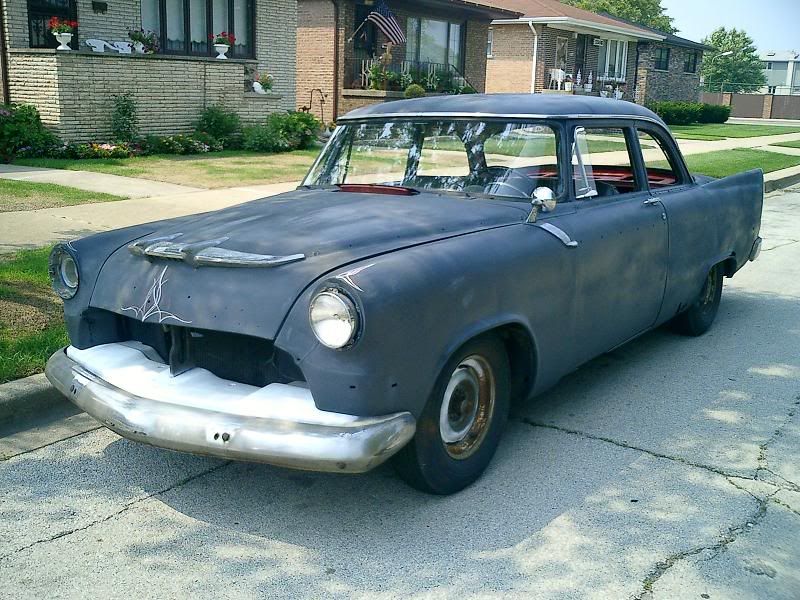

    Here's a few pics of my '56 Dodge. It runs and drives, but doesn't stop worth a damn. Still needs major brake work, some electrical and cosmetic work also, but it's coming along.
    Lou

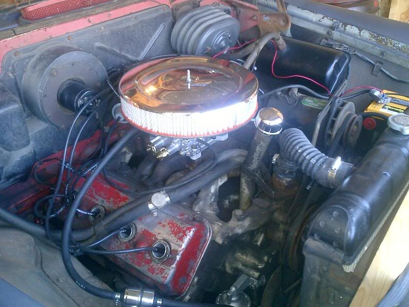

    Already there...it's the original 315. Most of the original stuff was broke or garbage. It's got a spin-on oil filter, small block chrysler fuel pump, edelbrock 500 carb, and a Chevy HEI distributor. I'm lookin' for a Caddy air cleaner for it...just wondering on the amount of cutting I'll have to do to it to get it to clear the HEI. I just got keys cut for it so it starts and stops with the key. Set the timing on it the other day and it runs perfect, no noises. Turns out the generator works...honestly didn't think it would the way everything else was going. Phase 1 is near completion.

  17. I really like the way this engine compartment looks. Just dirty up that carb, put an old style battery in and hide that fuel filter (you should run some hard line, not to much rubber hose)...perfect! Its got a good "Run what ya brung" look.

    I like . Hey is that thing that looks like an accordion the brake booster?

    Is that a 4-hole carb spacer?
    I have an open spacer on my hemi and was wondering if the universal 4-hole ones fit the carb's throttle bores and the manifold bores.
    Any Ideas?

    Sure is...it goes along with that big vacuum can too. It's normally filled with air then when you hit the brake, vacuum from the engine ****s it closed and pushes a rod that in turn pushes on your brake pedal lever...helping you apply the pedal. Something to that effect...

    The spacer I got is a 4 hole spacer made to adapt edelbrock and similar bolt pattern carbs to the small quad bolt pattern of the Carters. The spacer I got actually has two bolt patterns on it so you could probably use a variety of carbs on it...but yes it is a 4 holer. I got it from Hot Heads in NC. There website is www.hothemiheads.com
    If you ask for Bob he's real friendly and knows his ****. Ask him about the 4 hole spacer if you're interested.
