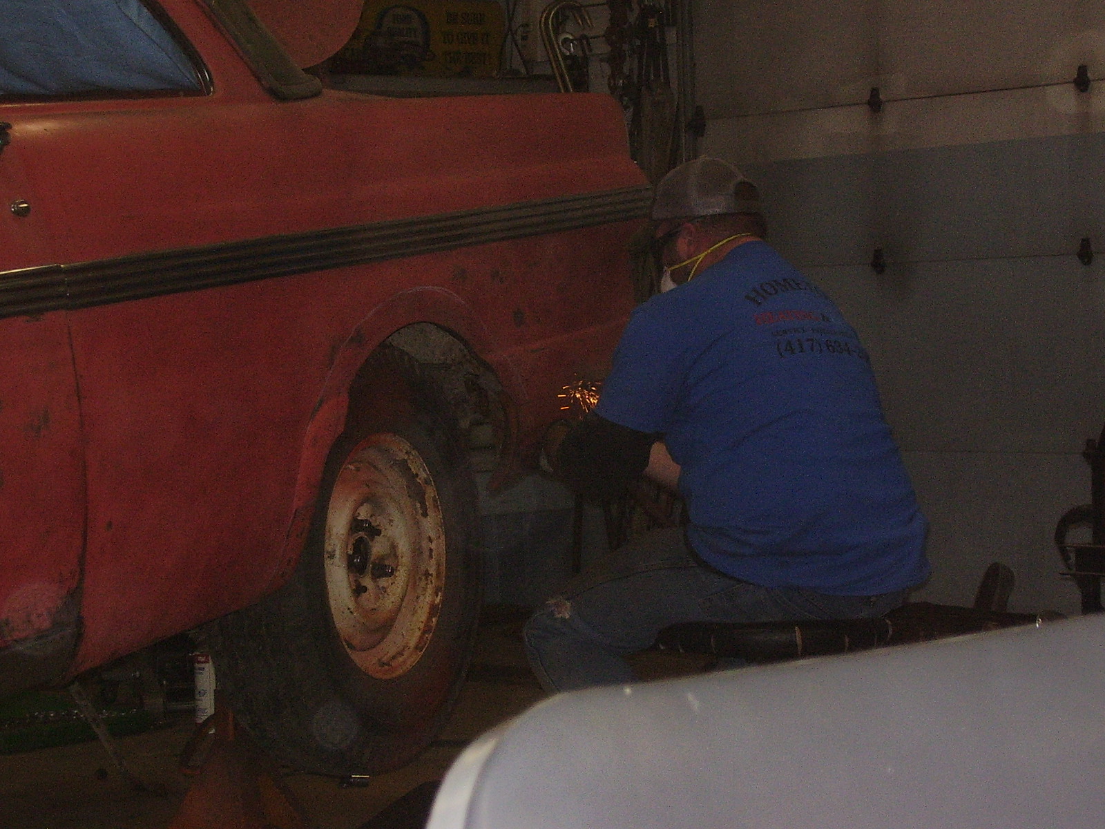

    Gonna move the engine back about 6 inches. The guy in the previous picture is my buddy, he is the sheet metal man. He will fab the new floorboards and firewall. While he has been doing that I have been restoring the dash. We started on this about 3 weeks ago so these are catch up pictures. Mac's back ordered one rocker panel so I told them to wait and ship when they bad both. With upcoming holiday it may be awhile before much else gets done. And yeah what I'd give to have a Boss9! PC090004.JPG PC100011.JPG
