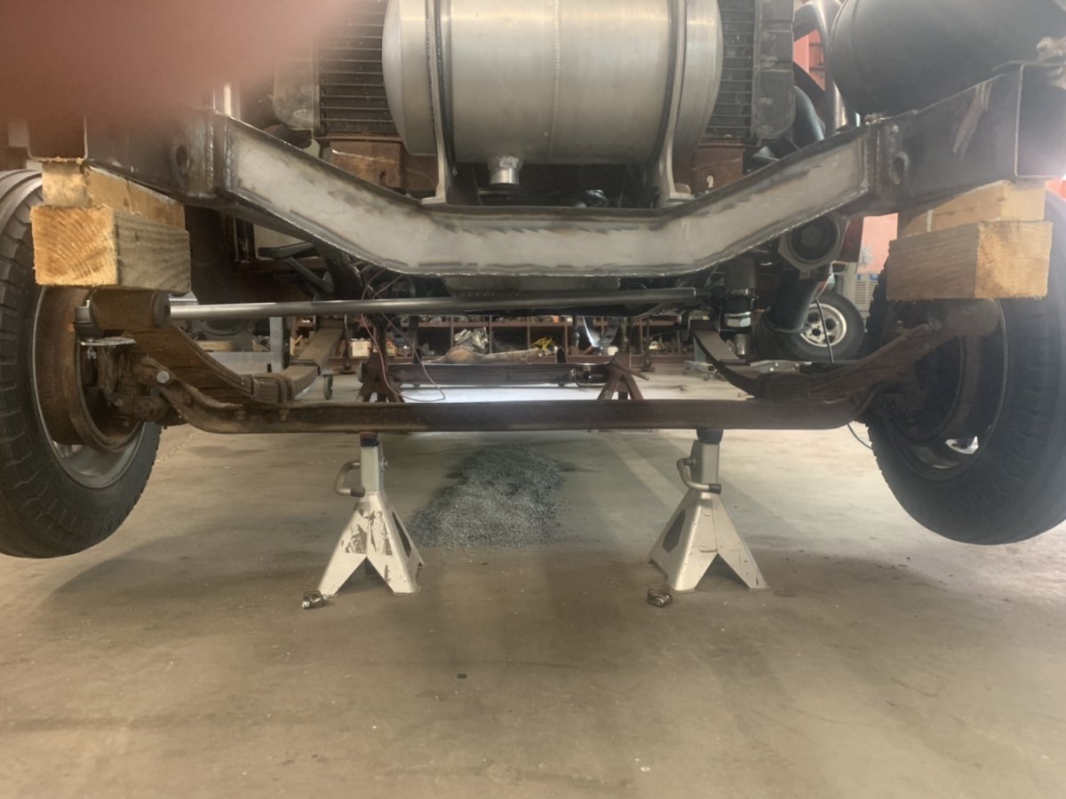

    A little work has taken place since last September. For me it’s a slow process. The front axle is in and it’s a roller again at this point. These pictures are from last year. IMG_2159.JPG IMG_2160.JPG IMG_2179.JPG

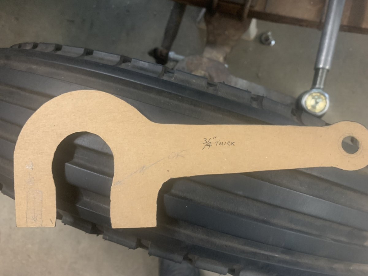

    The steering is where I’m at now. I still need a couple of gussets on the mount and need to make the arm to bolt to the p*** side spindle. The one that is on there is just for mock up. Now that everything is in place on the drivers side I can finish the steering column and shafts. IMG_2765.JPG IMG_2766.JPG IMG_2767.JPG IMG_2768.JPG

    I got the steering arm cut out, and got the surge tank cleaned and re soldered. The radiator got re-cored with 3 rows instead of 2. In keeping wit my wish to keep as many parts from the ‘50s & ‘60s I’m really pleased with them.
