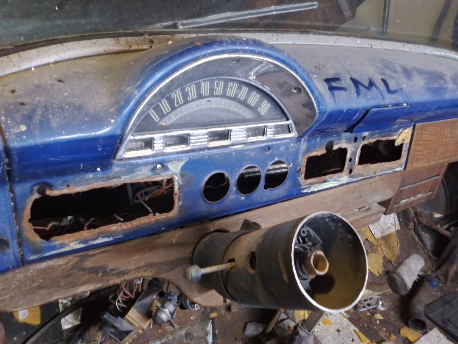

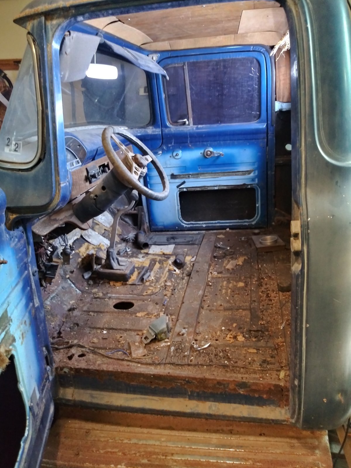

    Starting the tear down with some background easter eggs...

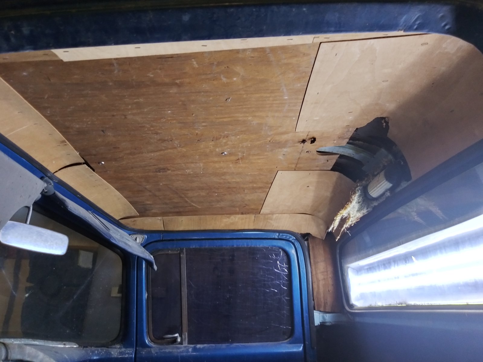

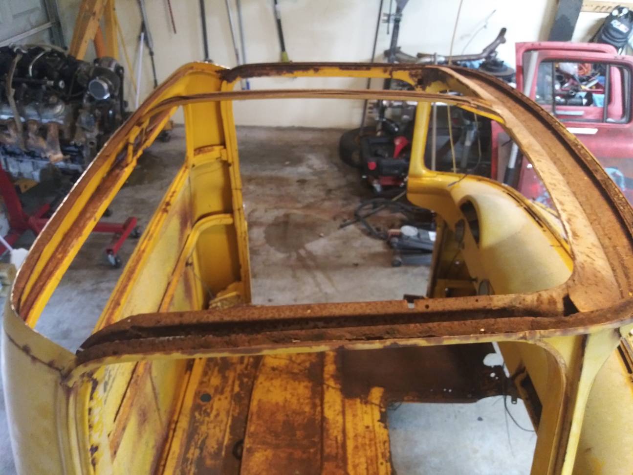

    Roof skin was wasted, but the drip rails and inner structure was actually pretty nice... image000001.jpg
    Completely stripped down...

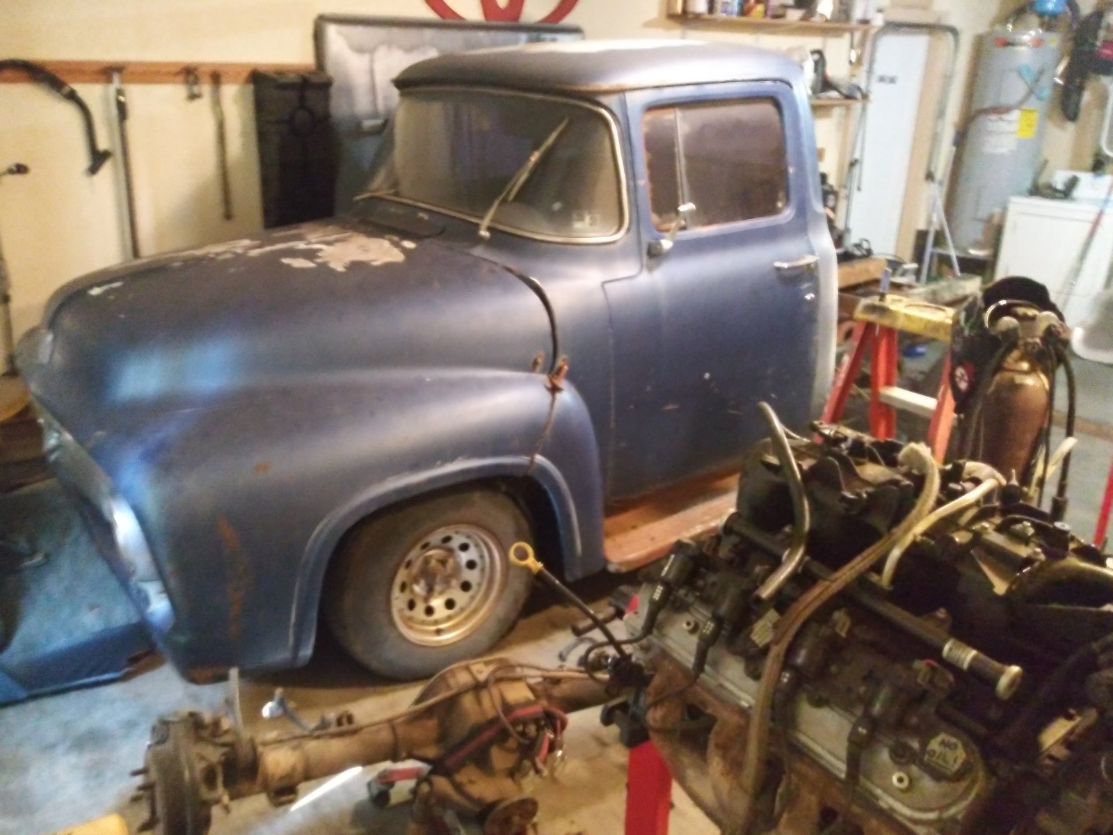

    Moving on to the engine... I put this 5.3 LM7 LS engine together in 2017 for one of my Foxbody cars. I copied every part from a recipe that made 670hp to the rear tire in a foxbody and ran mid 9's and trapped over 145mph in a heavier car. Long story short, my car didn't get built due to the lake flooding my house, moving to a new house, and then the virus, but I kept the engine with plans to put it into something else.
    I set the engine into the ch***is as far back and low as I could get away with, but also keeping the bottom of the trans pan high up enough away from the ground. The engine is offset to the p***enger side 1.5" to gain some steering shaft clearance, but this also works because the Explorer 8.8" pinion is also offset to the p***enger side. The engine uses a Holley "Muscle Car" oil pan kit and has clearance for days. I could go lower, but the headers really start to interfere with the upper control arm mounts. I had to trim the top of the p***enger side upper control arm rear most mount to clear the stainless shorty headers. Right now the truck is being built without a power adder. But I do have all of the components to install a single 78mm billet turbocharger, as well as water/methanol injection system, and some nitrous to help with launch.

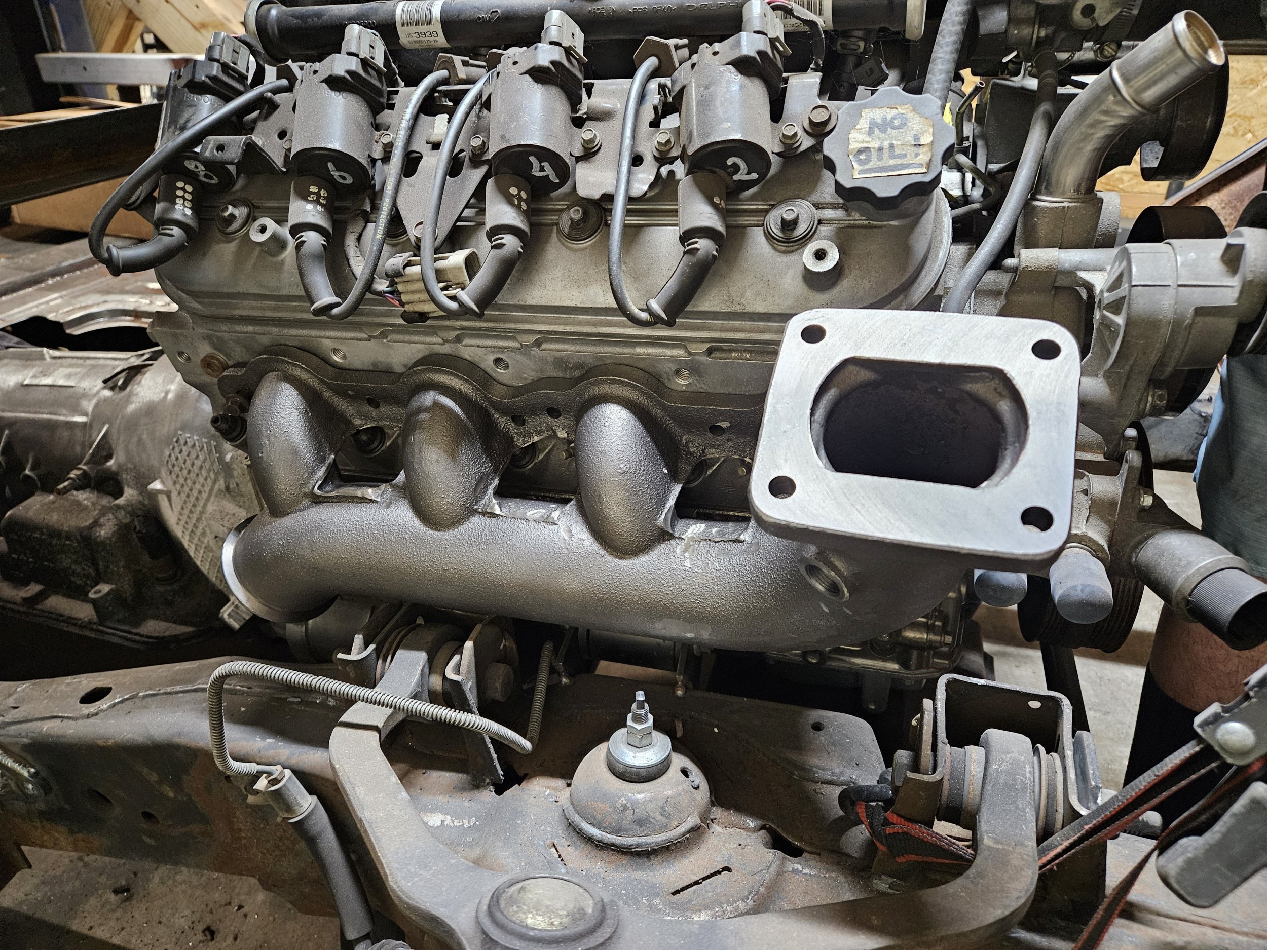

    I've been struggling with the idea of having the truck naturally aspirated or boosted. This engine was originally put together for a turbocharger in the last vehicle, but I was leaning towards going to NA just to simplify the build timeline and budget on this one. On a whim, I decided to order a single turbo log manifold for a test fit. I ***umed it wouldn't fit at all, and I'd just continue in the NA direction, and return the log manifold for a refund. Well, it fit better than the p***enger side stainless header! Well ****, now I'm heading down that path...
    So last week I ordered the 2.25" stainless steel exhaust tubing, reducers, and V-Bands to build the crossover pipe, and today I ordered the new billet turbocharger. I already have a new wastegate, intercooler, cold side piping, etc. leftover from the previous set up.
    The bummer about now running the turbocharger is that I'll have to change my exhaust system. I have all new 3" stainless exhaust tubing, mufflers, etc. that was put together to achieve a very specific naturally aspirated sound with true duals, x-pipe, etc. Well, most of this stuff won't work with the single outlet turbocharger set up, so I'm going to have to change my plans with that.

  23. Turbocharger came in, I had to toss it on the manifold to get the creative juices flowing and start planning wastegate placement, downpipe routing, oil feed/return routing, etc. I might buy a T4 inlet adapter/spacer to kick the turbo away from the engine a little more so I can stuff an AC compressor in there and have more room for a wastegate. Might have to change water pumps to make that all happen too, no big deal.
    Last night I fired up the cheap chinese TIG welder I bought 6 months ago. I haven't practiced in 5.5 months and even back then that was only about 2 hours worth of practice welding. I said to hell with it, and went straight to welding the stainless V-Band flange on the drivers side stainless header, as well as tacking the 2.5" to 2.25" stainless reducer cone into the other V-Band flange. For my first real TIG weld, I'm not mad. It'll hold, and I'm sure I'll get better at it as time goes on.

    On to some exhaust work... It'll be a single 3" exhaust out of the turbo, but getting it over the axle and out the back, well, it'll be easy, but I don't want a single tailpipe. I'd prefer the look of duals out the back, but there's simply no room for dual 3". A friend recently gave me an over-the-axle section of an aftermarket exhaust system for a newer F150, since I have a newer F150 he thought I might want to have it, I told him I'd likely cut it up to use it on my F-100 instead. Basically it's a single 3" into dual 2.5" all stainless steel with a small resonator. It doesn't fit worth a **** and the angles are all wrong and the bends are all wrong. So, I spent about 2 hours t******* it down and repositioning the dual 2.5" tubes to fit better with my TIG. I still need some more 2.5" tubing to lengthen the sections over the axle for more 3rd member/shock clearance, but the plan is to add dual tailpipes out the back, not sure if I'll step up to 3" tailpipe after the axle or keep it 2.5".
    That's all for now, ****ty photos to come, minus the exhaust stuff because I was too worn out to take photos.
