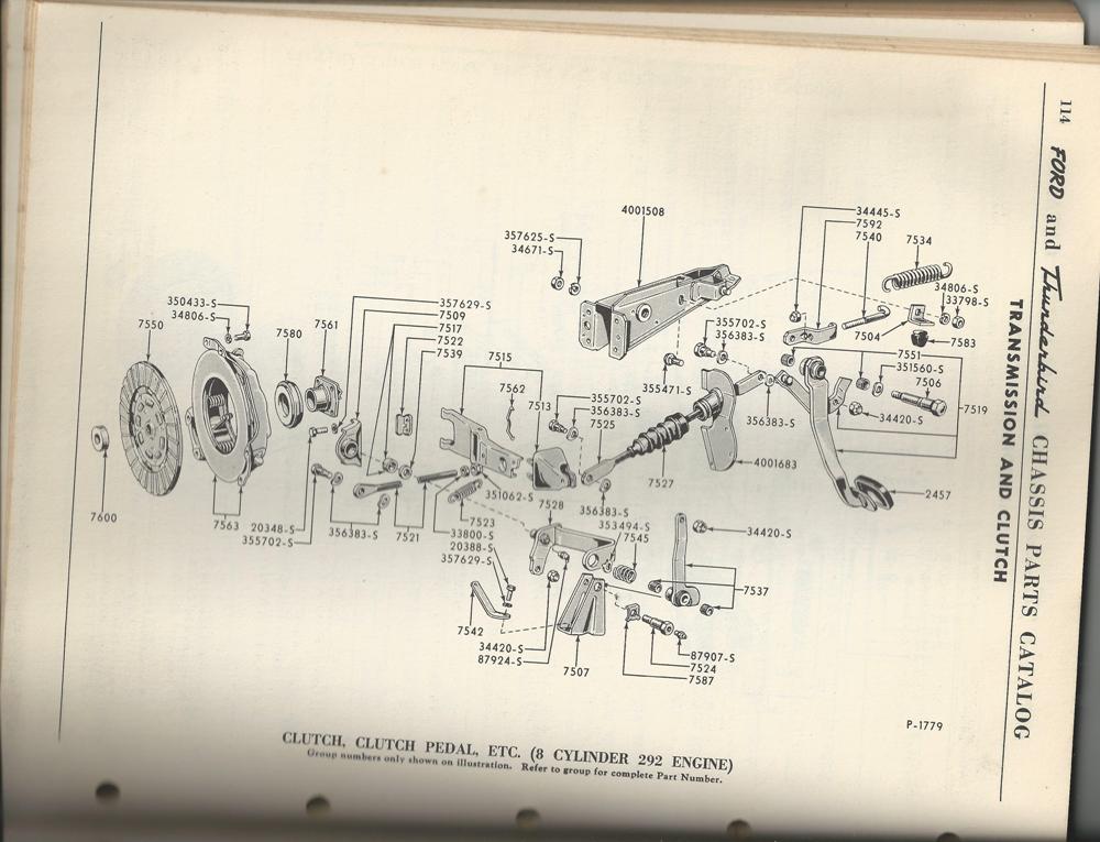

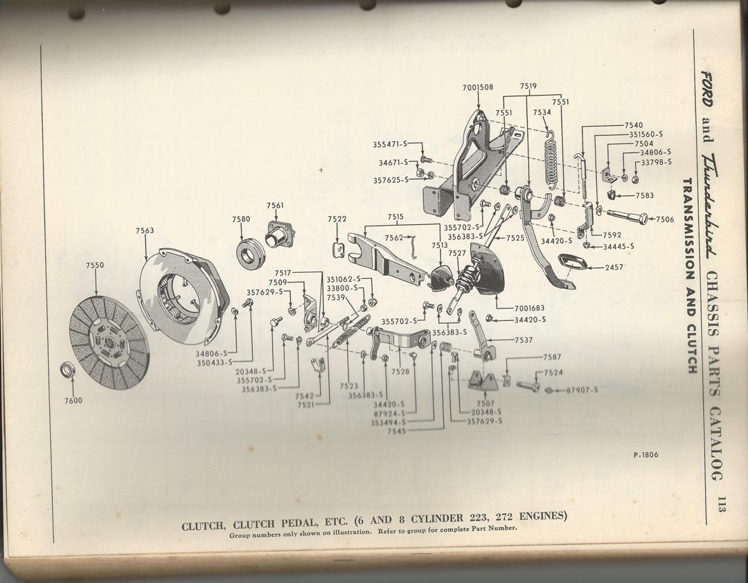

    does anyone have a good diagram of the clutch stuff, specifically the adjustment rod? I'm not familiar with these cars, and I'm trying to put something together that's been apart a long time and I'm having no luck with Google.
  2. Does the clutch yoke have a hole in it at the outboard end? Do you have the Z bar? Pictures?

    These are from a 55 Ford parts book so may or may not be any help.
    monteg0 likes this.

    these look like they'll work. it appears um missing the u shaped piece of metal, the spring, and the bolt that attaches the rod to the z bar. now I know what I'm looking for, thanks!
