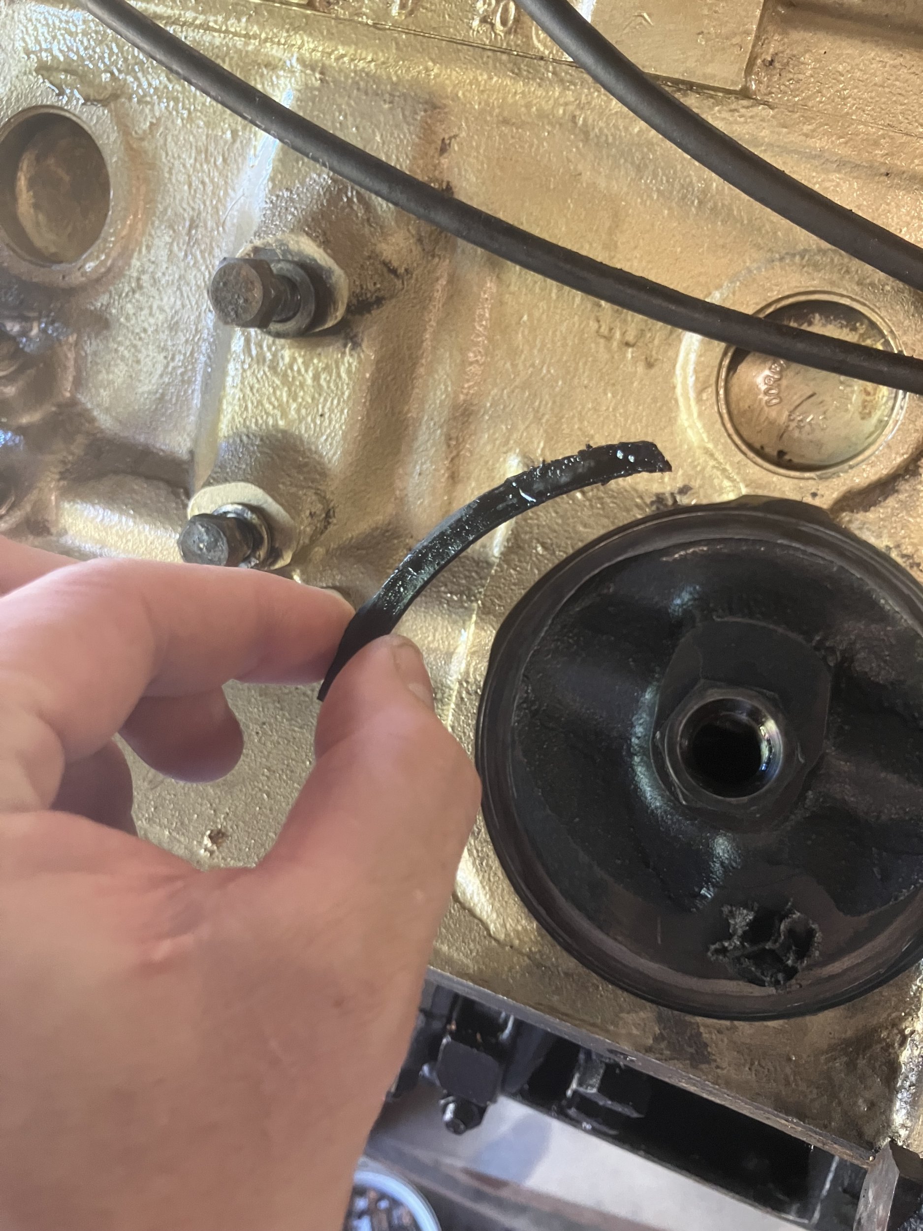

  2. I have read about this on forums. Been thinking of making my own gasket for the spin on plate. Filters (well, gaskets) cost like $60 here. But after inspecting the old fossil big rubber circular gasket, i guess I better buy a new canister to get the gasket.
    Making my own will likely tesult in a mess.
    Old cracked rubber gasket.

    The “new” gaskets available do NOT work, particularly with a high pressure/volume pump, tried and failed 5 times. The new “ rubber” is too flexible and the oil will get around it every time, maybe not right away but soon, 5 minutes into my engine break in I had oil pouring out , second time about ten minutes, starting to panic, the next 3 attempts went no better, ****ting my pants at this point. My solution was to find another engine with the Ford spin on adapter and carefully remove it with the gasket intact and use that, the aftermarket adapters are not as robust and warp easier from over tightening. After all the aborted attempts the break in worked out but not something I’d ever want to repeat.

  8. Ok, I might be in for some fun times.
    My gasket was burned/dried/stuck to the block. So I guess I have to find an engine block with an intact gasket stuck to it, and transplant everything, haha.

    I made my oil filter gasket as I bought an original 58-up plate and nut. You can buy 1’ square gasket material sheets with 3 different thicknesses at any of our part stores. They look like cardboard but are not. I cut one with a pair of scissors 13 years ago and it’s never leaked.

    Couple thoughts. Make sure your plate is flat, and perpendicular to the block. It’s not unknown for them to be bent from over tightening to try to stop a gasket leak. That’s more of a problem with some thinner aftermarket plates than the oem Ford.
    Some of the Ford suppliers list the canister filter and gasket separately. Just the gasket wouldn’t be such a shipping/duty problem, but I really don’t know. If you look into that, an email should confirm it’s the fiber gasket and not a rubber one.
    Last, being the same age as jimmy six, I’ve also got gasket material laying around, and Dad taught me to make gaskets so long ago I don’t really remember when. That’s the solution I’d be headed for. Either way here or the Ford Barn (or yblocksforever) someone should be able to give you the thickness of the new gasket.

  11. Thanks. I have some different gasket material sheets, I often make my own - including exhaust gaskets. I will give it a try, I believe I have a suitable thickness.

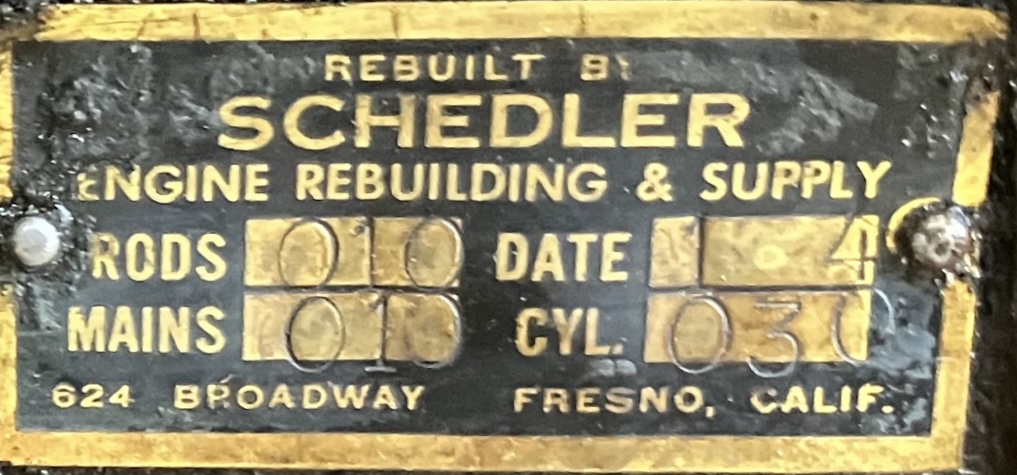

    Damn! Rebuilt right here in the dirty 'No. Crazy. Seems like based on the spacing it is 1**4. Place has been around since 1944, so it could be a bunch of different years, 64, 74, 84, 94??? My long lost buddy Gene used to be an engine builder at Schedler's. I've been trying to reach him. Will try again. Very cool.

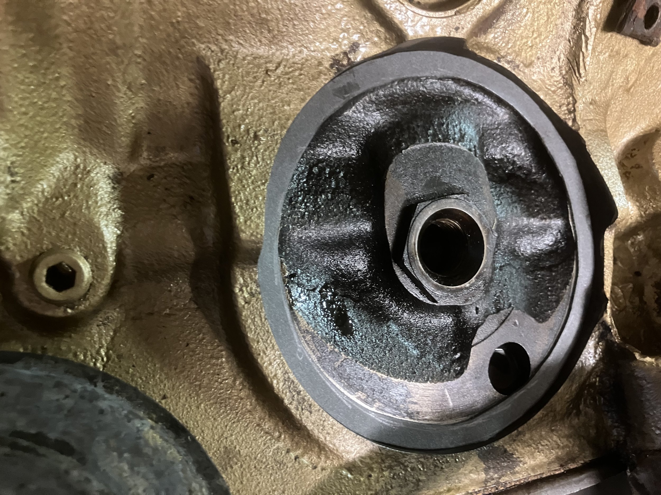

  18. From what I can tell the crank, bearings and cam lobes look nice. I took peek as I replaced the rear seal. Also cleaner than I expected under the valve covers and in the oil pan. Here is a better view of the plate:
  19. Made a thick gasket. The plate is straight, and I believe the flange sits very well on the gasket. I hope it will seal well.

    That looks like 1964 to me.

    If you still have the pan off, pop a bearing out they are dated on the back side. That would give you a good time frame to when it was rebuilt.

  22. I have to check the date next time the pan is off. Engine is in car now.

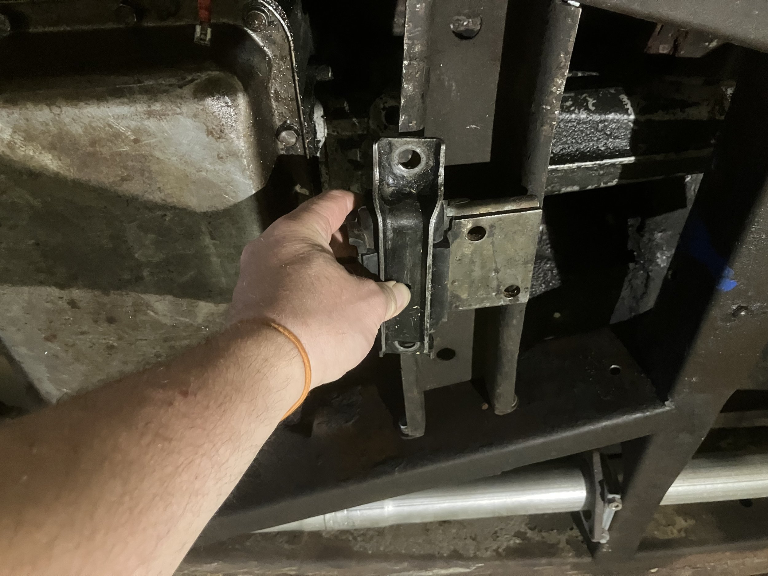

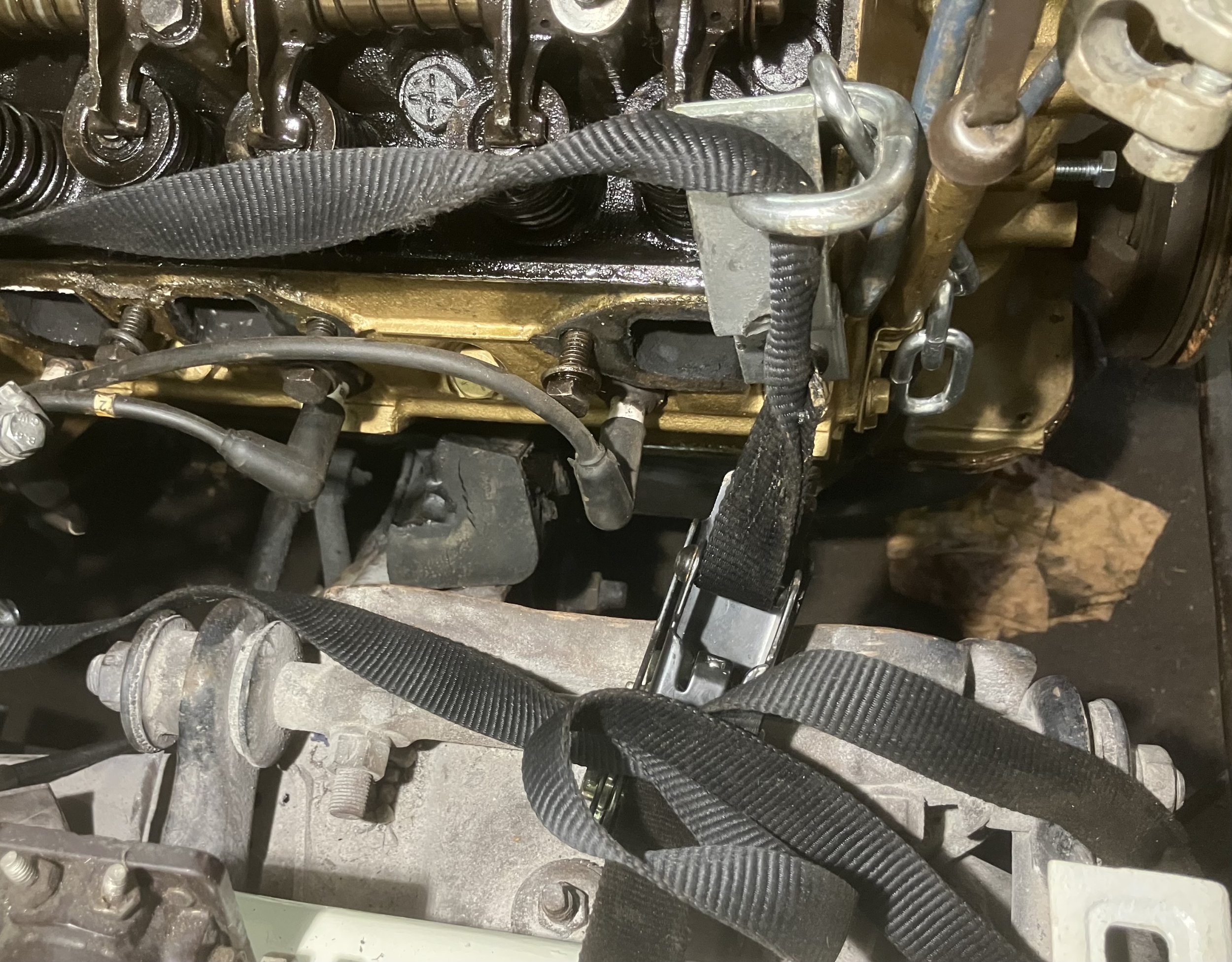

    Engine side mount has its opening to the rear. I believe this is the correct way to install it?
    Trans crossmember - engine/gearbox wont fit. 2” difference.

    Rocket Scientist Chris
    Yes, open to the rear is correct.
    I think you will need to use a ‘57/‘58 rubber trans mount and drill matching holes in your ‘56 trans crossmember. The ‘57/‘58 trans mount is smaller (shorter) but may still require added clearancing on your cross member to fit. :(
  26. The whole mount is located too far to the rear of the car, the diagonal bar holding the rubber to the gearbox is hitting the crossmember.
    I believe this is can be the reason: 55-56 Fords possibly had small case Ford-o-matics. This 1957 unit is a medium case. The medium case has its mount located 2” off, compared to the small case gearboxes??
    Solution? Shorten the crossmember and mount it to the frame in a position more to the rear.
    I have to do some research, measuring and thinking.
    osage orange and warhorseracing like this.
