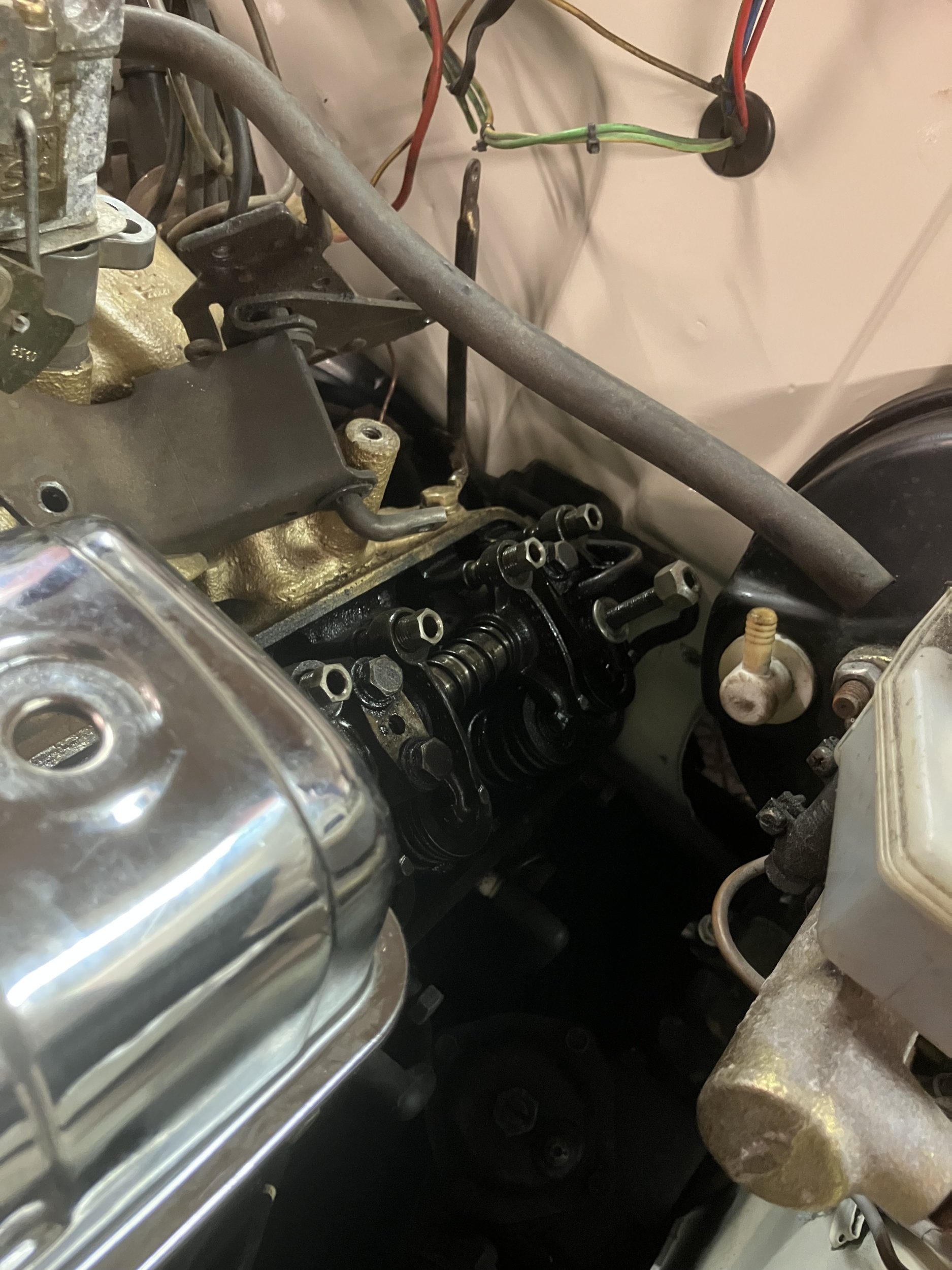

    Someone put an aftermarket brake booster unit on the car. It cleared the 305 chevy engine, but will not allow the Y-block valve cover to fit. I will remove the booster and fit the valve cover. Maybe put a dent in it.
    The 1957 bellcrank does not match the 1956 inline six firewall accelerator linkage. The 1957 trans pressure rod (”kickdown rod”) will probably not clear the 1957 valve covers. Even though the 57 parts came off the same running car. Also, Bubba has done some welding to the bellcrank and the rod. Very confusing.
    I guess I must hunt down some 1956 parts to move forward.

    I remember seeing a Chevy booster that was much much smaller than the one you have. I think it came off a mid 50's chevy. Sorry I can't be more help as to the year and make to look for but it is smaller in Dia. and length.

    Ford used a small diameter booster and a bracket that raised it up a few inches, they were used early to mid 60’s Ford. The bolt pattern on the firewall is the same as the ‘55-‘56 Fords.
    I believe it was a Midland brand booster.

    Booster for a ‘93 Cobra Mustang fit very well in my ‘54 and cleared the Yblock valve cover.

    If not already you need to cut the front rubber stops in half. I forgot when I put in the AeroStars 7 years ago and busted up the rubber. The shocks installed needed a floor jack to get up to bolt on but really helped the ride. kYB’s but I don’t remember the #. Larry’s Thunderbird in Corona Ca. Sells a 1-1/8” sway bar to replace the 7/8”.

    I.M.O.: That car needs it's Y- Block!
    I don't believe the booster is needed on that car. Manual brakes work quite well when adjusted properly. To eliminate the booster may involve a different master cylinder, but it would work well and be worth it visually.

  10. Yeah, that is my experience as well - drums work very well if everything is ok in the whole brake system.
    I will remove the booster and fit the valve cover first. The problem is to get it over the stud, with the booster in place. If this wont work, I most likely will get an original master cylinder instead and be done with it.

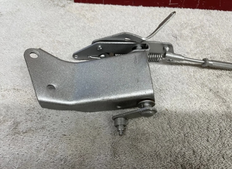

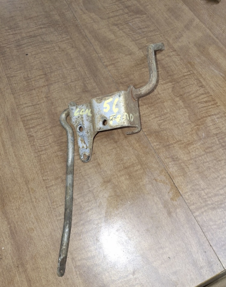

  11. I have seen different types of 1956 firewall linkages on ebay. Here is a pic from an auction. The bracket is the same as the one on my car, but the top arm is shorter, and should (?) fit the extra piece of linkage that connects to the bellcrank in the intake.
    There is an old junkyard marking on it that seems to read ”6 cyl” or something. I have asked the seller if he knows where it came from.
    I would like to find one that fits right. Drilling holes and fabrication requires the engine to be taken out again.

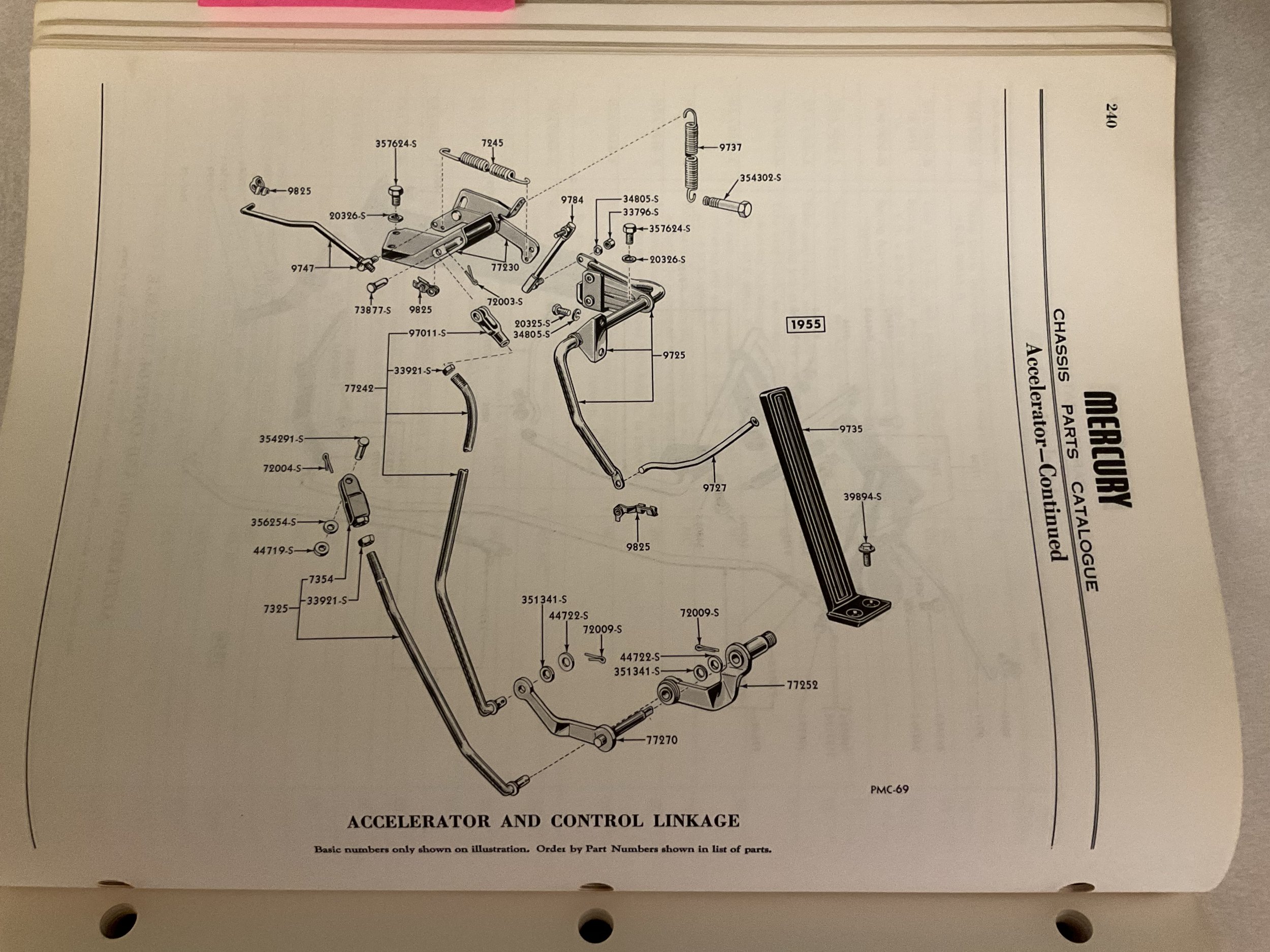

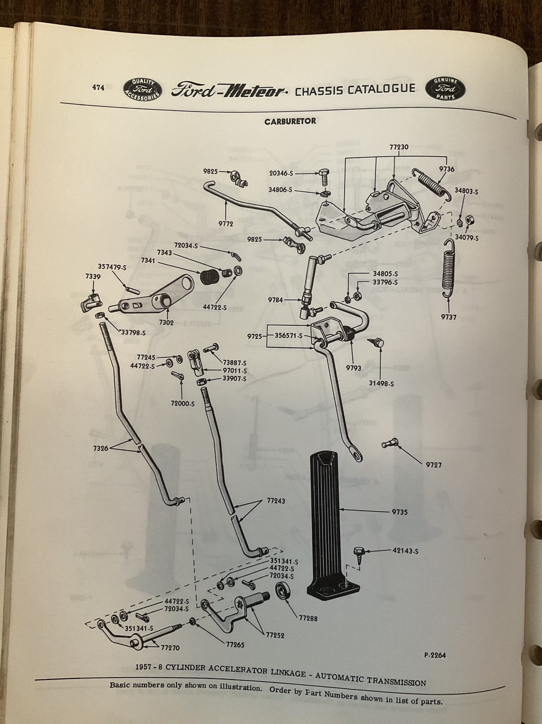

  14. Rocket Scientist Chris
    Posts: 661
    Here’s the ‘55/‘56 accelerator and kick down linkage parts diagram:
    Here’s the ‘57/‘58 parts diagram:

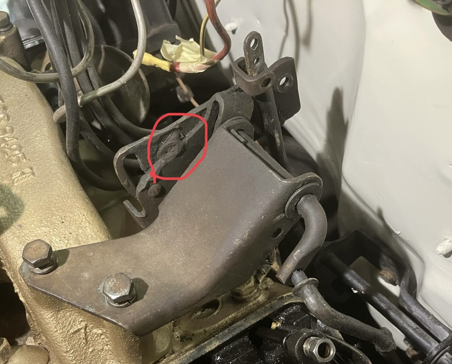

    Looking at your present linkage parts, I see a weld on the sliding mechanism that allows the kick down to work at full throttle. The weld negates the springs and won’t let the kick down function correctly.
    I’m not sure what year your linkage is. It’s close to the ‘57/‘58 Ford linkage. But, not exact. I checked my ‘49-‘59 Mercury parts books, but no match. You may have remants of a truck linkage and part of the old 6 cyl linkage.
    It may be easier to find a whole ‘55/‘56 linkage set and modify it to actuate your ‘57 Fordomatic’s kick down lever than to try to modify what you have (and have it all work correctly!).
    Hope this helps! :)

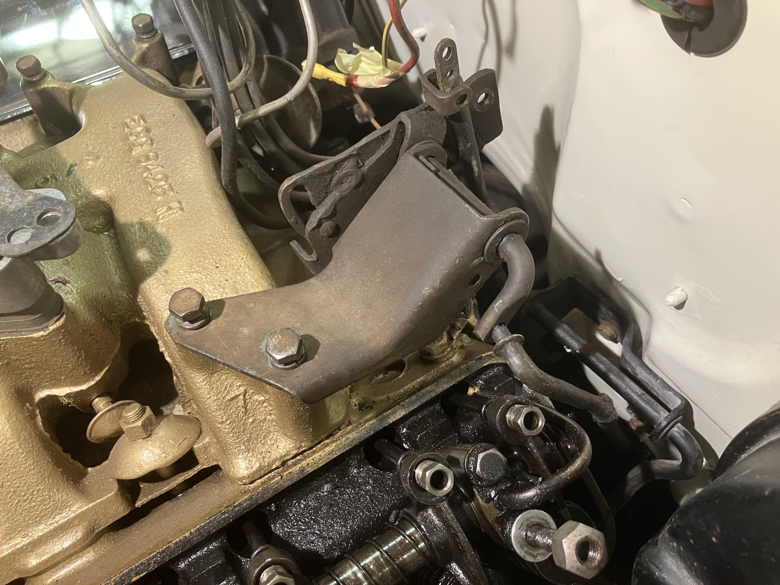

  15. Thanks a ton!

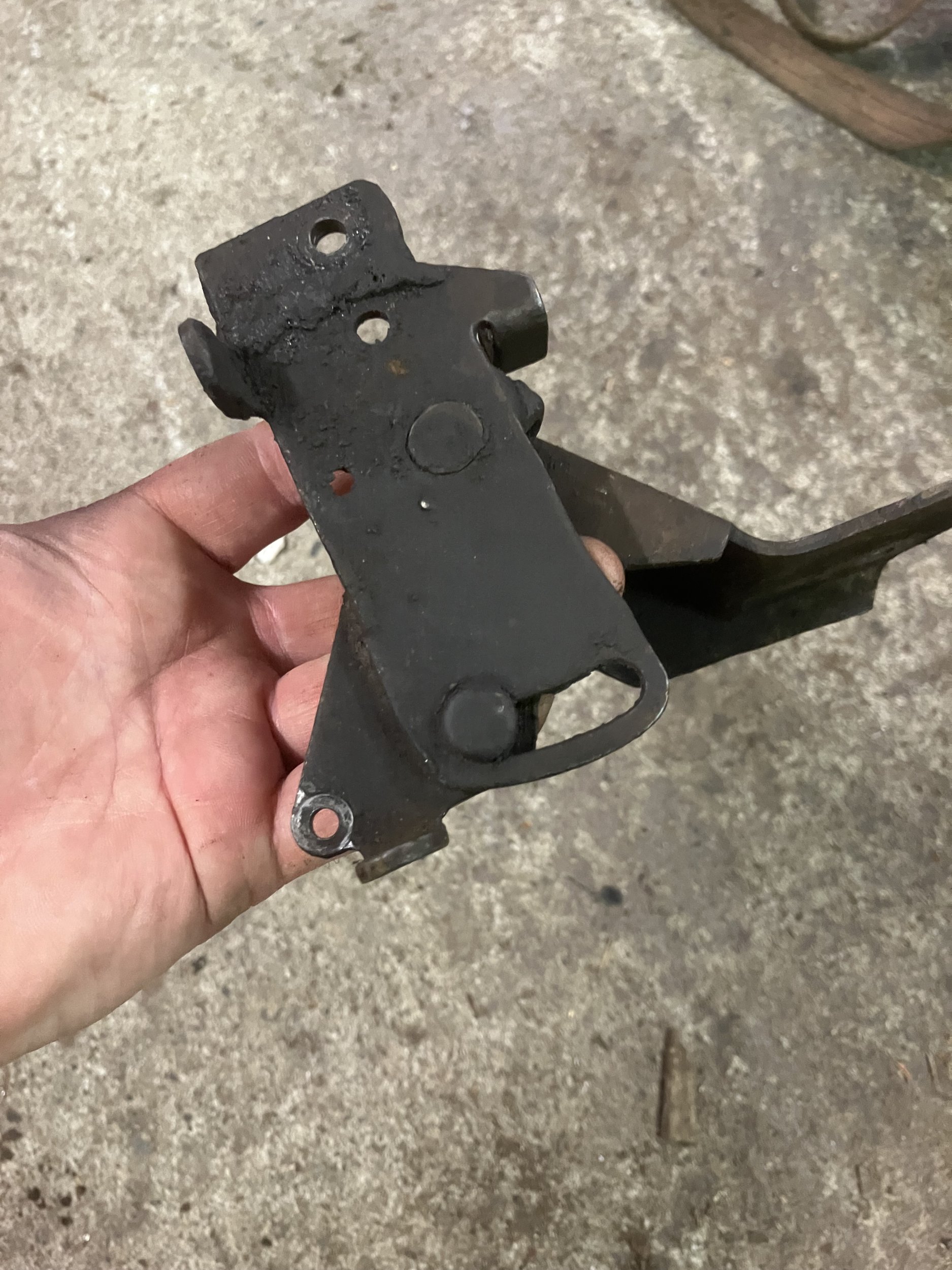

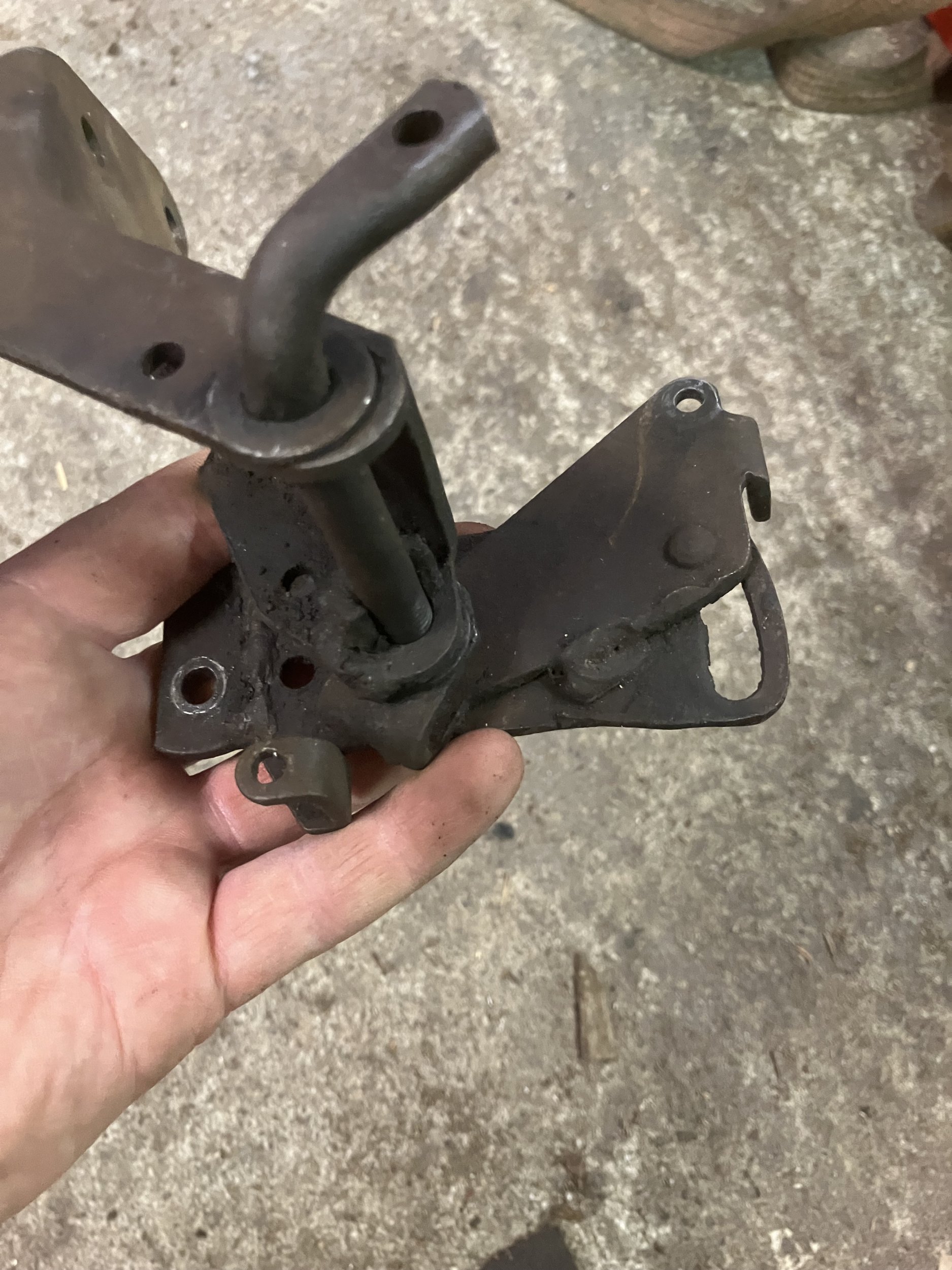

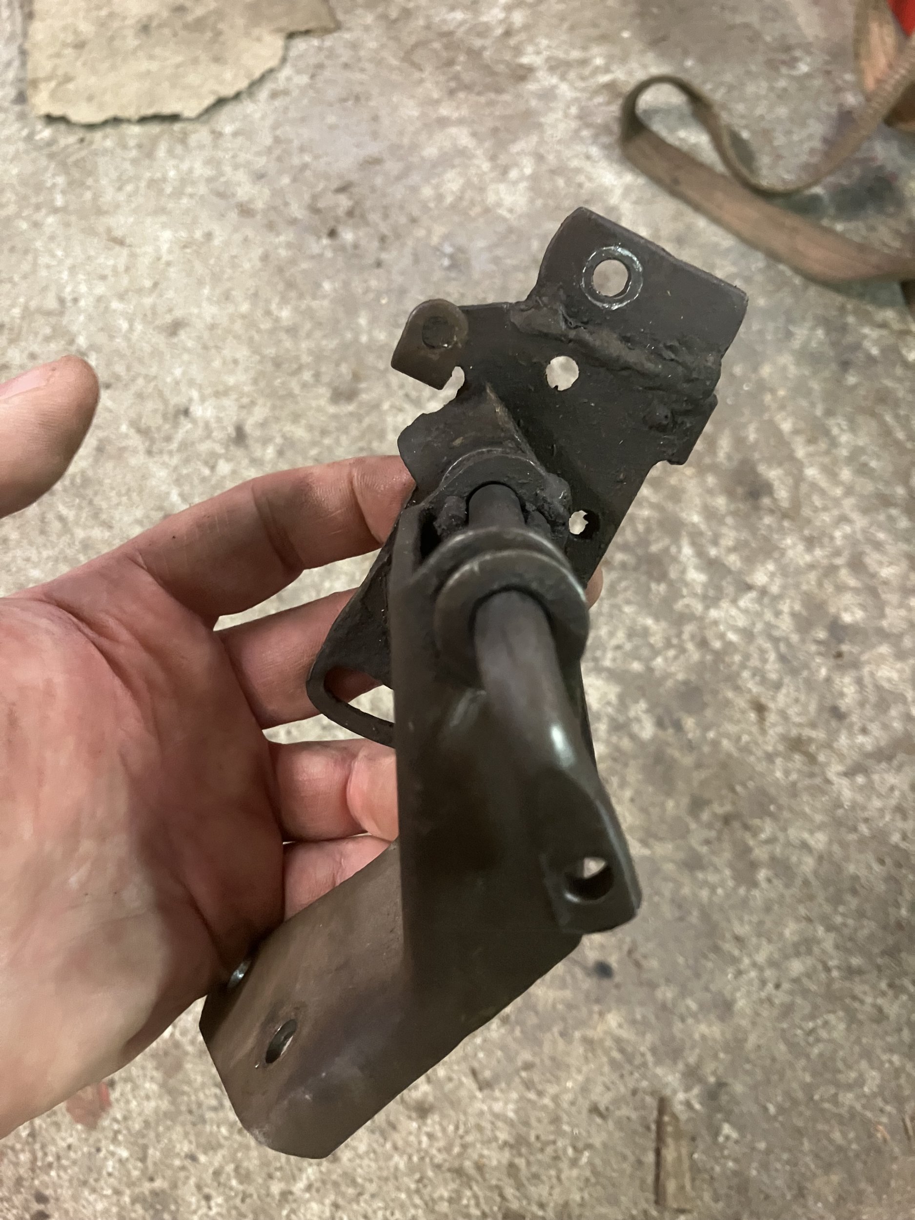

    My 57(?) bellcrank has been modified quite a bit. I do not know why, but someone looong ago had a problem to solve:
    I have tracked down a complete 1956 setup with everything from the accelerator pedal to the last piece of linkage to the carb - probably identical to the pic from the manual above.
    If I buy it I might have to make a bracket to bolt it to the 57 intake. But such issues can be solved.

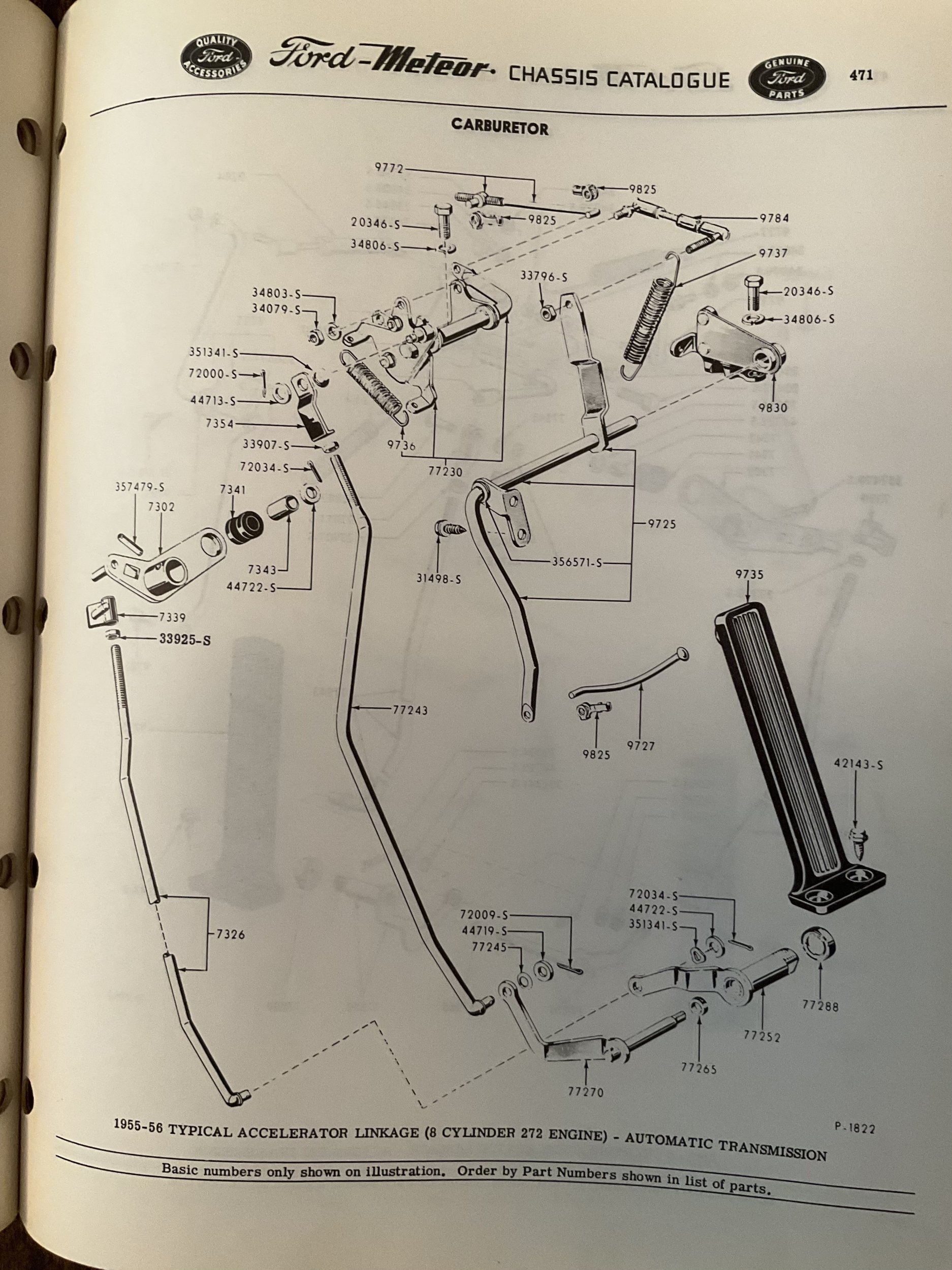

  16. Rocket Scientist Chris
    Posts: 661
    I just realized the parts diagram for the ‘55/‘56 linkage is for a 2bbl set-up. The throttle link connects to the p***enger side of the carb. The whole linkage ***embly bolts to the back of the manifold. The 4bbl linkage ***embly bolts to the two bosses on the driver side of the manifold and the throttle link connects to the driver side of the 4bbl carb. The linkage ***embly you want should look similar the the ‘57/‘58 linkage.
    Sorry for the mis-information! I can’t find a parts diagram for the ‘55/‘56 Ford 4bbl linkage. But, I can post the ‘55/‘56 Mercury diagram (4bbl only). I’ll try to get some pictures of the linkage in my ‘55 Mercury that might help, too. :)

  18. Ok, them I understand why some 56 v8 cars have the ”big” ***embly - they are 2 barrels. Often hard to tell from pictures on the internet, where the air cleaner hides the carb. The complete ***embly I tracked down is for a 2 barrel - you saved me!
    This one would probably be a good starting point, a 4bbl 56 bellcrank I saw for sale. Combined with some fabricated linkage and my re bent inline six firewall bellcrank. My goal is to have a functional driver, that shifts well and works as intended.
    Jacksmith and down-the-road like this.
  19. That would be a super neat solution. But the mechanism of the pressure rod for the transmission is integrated in the Ford linkage idea - so things get a bit more complicated…

  20. Rocket Scientist Chris
    Posts: 661
    Definitely a good start! Here’s the ‘55 Mercury parts diagram:
    Here’s a picture of the linkage ***embly on my ‘55 Mercury:
    It’s really cramped at the back of the motor and hard to get good pictures. Let me know if you have any questions regarding parts locations. I’ll try to get pictures or at least mark up the parts diagram! :)

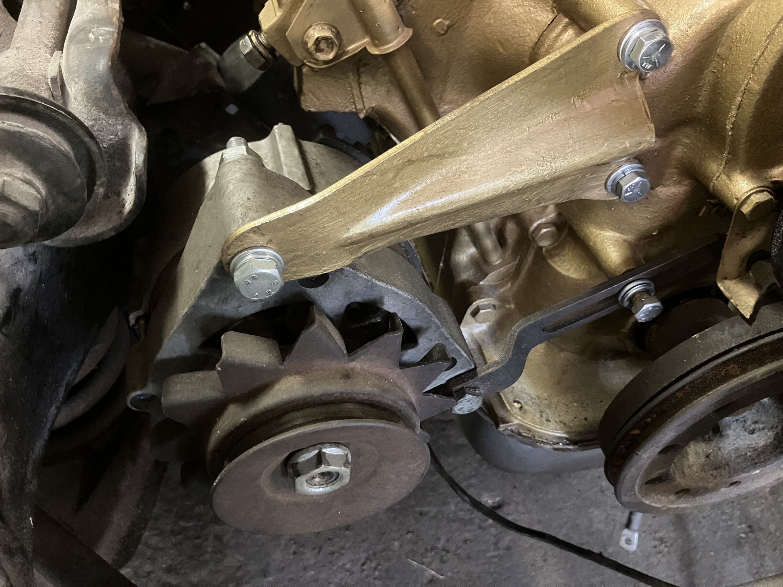

  25. Ok, I will remove parts of the steering linkage and see if I can solve the problem. I would like to avoid removing the engine mount, it was very difficult to bolt up right.

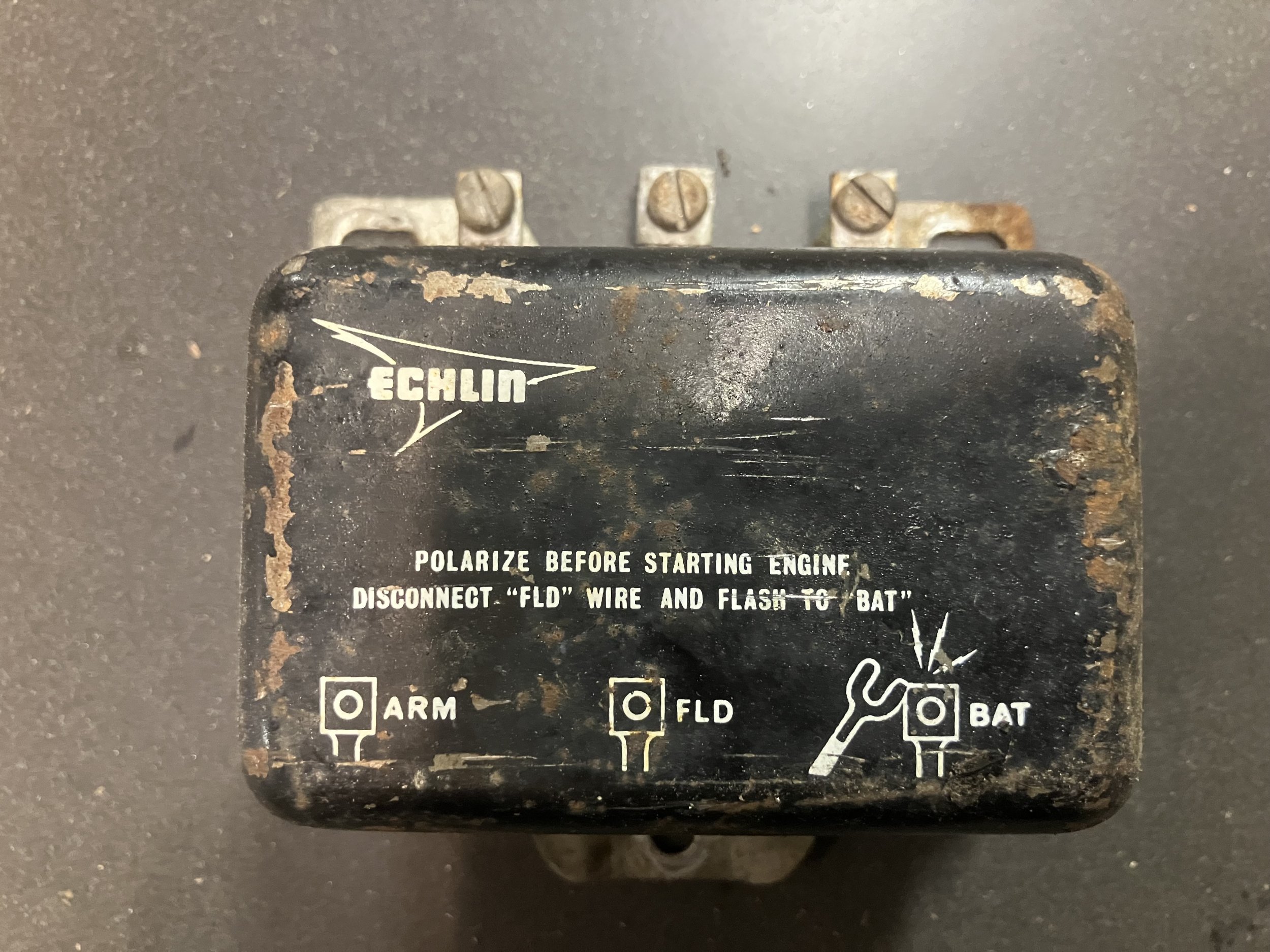

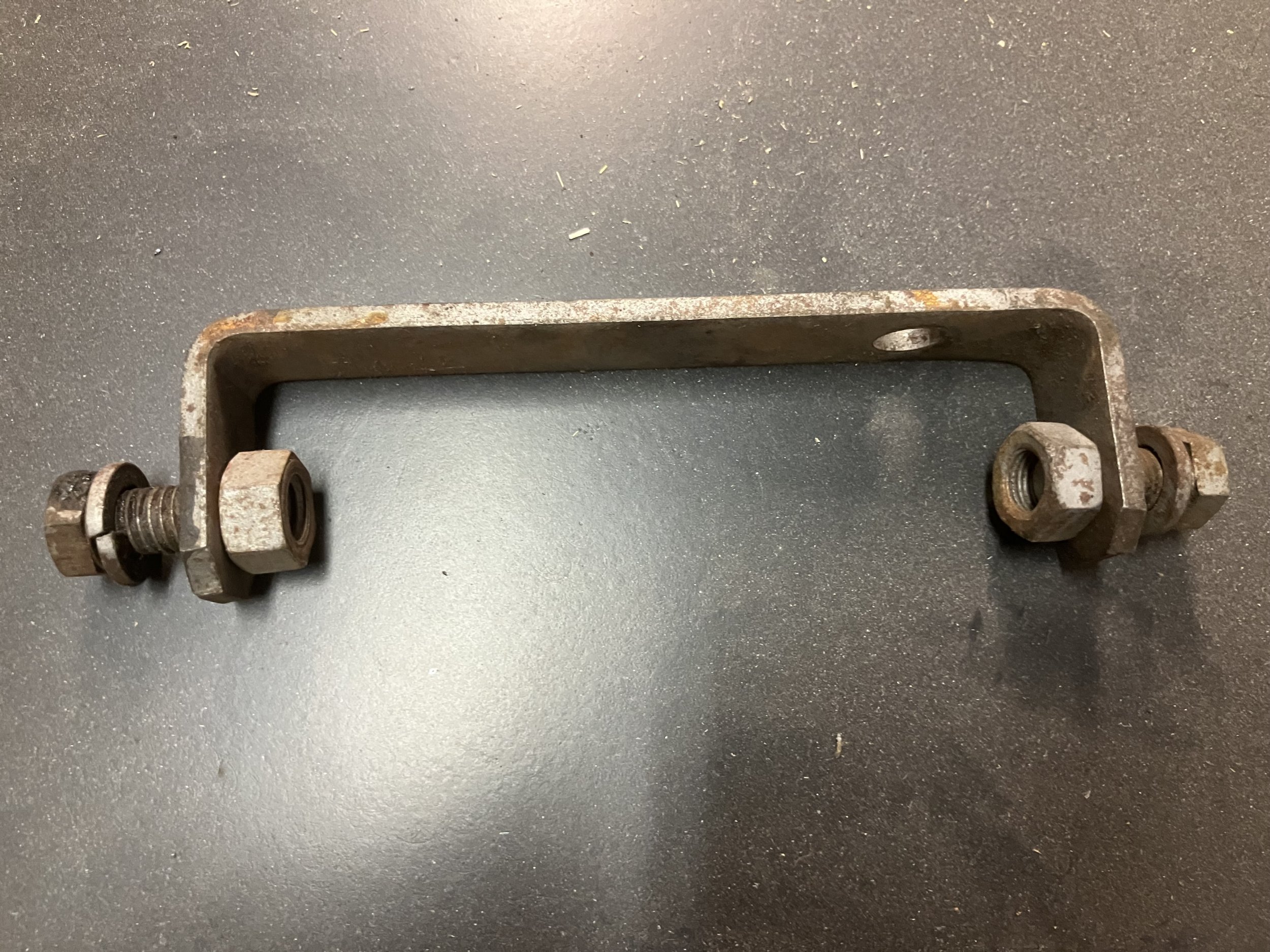

    Is the above the correct way to mount an alternator to the y-block? Note that there are only two points where it is supported.
    Is this the upper mount for the old generator from the inline six engine?
    Is this voltage regulator for the old generator, or for the alternator? Where should it be mounted on the car? The wite attached to the alternator is something like 3 feet, so I suspect left inner fender?
    osage orange likes this.
  26. patsurf
    Joined: Jan 18, 2018
    Posts: 2,818
    patsurf
    DEF. the old gen. regulator!!--try ,as everyone always says ,to just get a one wire alt.,and save yourself some probs!..smallest one you can find...
  27. 1930artdeco
    Joined: Oct 25, 2011
    Posts: 736
    1930artdeco
    from Lynden, Wa
    Looks like the upper bracket for a gen. and the voltage reg. for my 57 goes on the left part of the rad support next to the inner fender.
    Mike

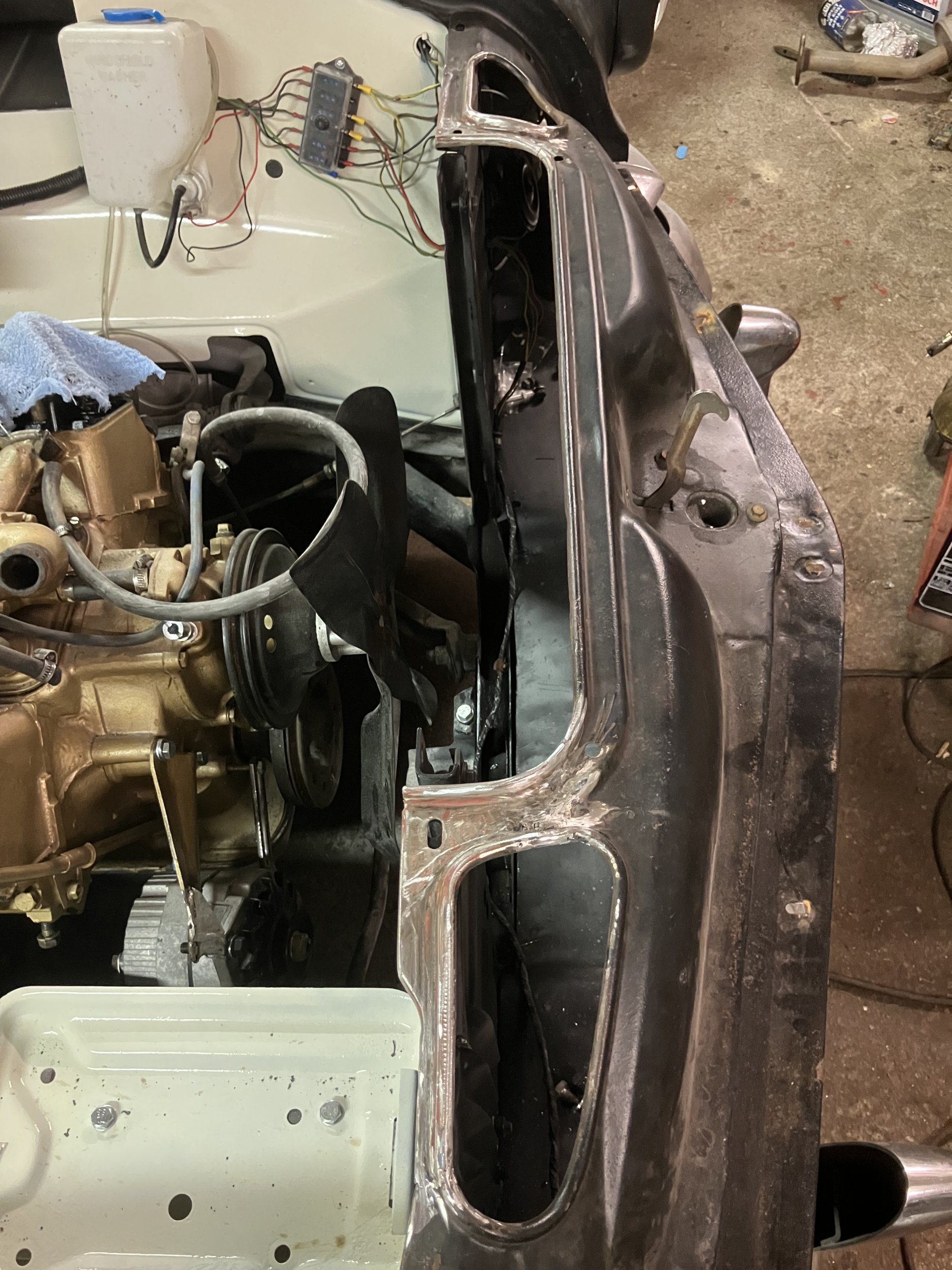

  29. I realise do not know the condition of the alternator and I am missing the right voltage regulator. Therefore I will use the new expensive one wire alternator I bought for the 305. I will modify the old generator top bracket into functioning as a third anchor point, to the back of the new alternator. Hope it will look ok.

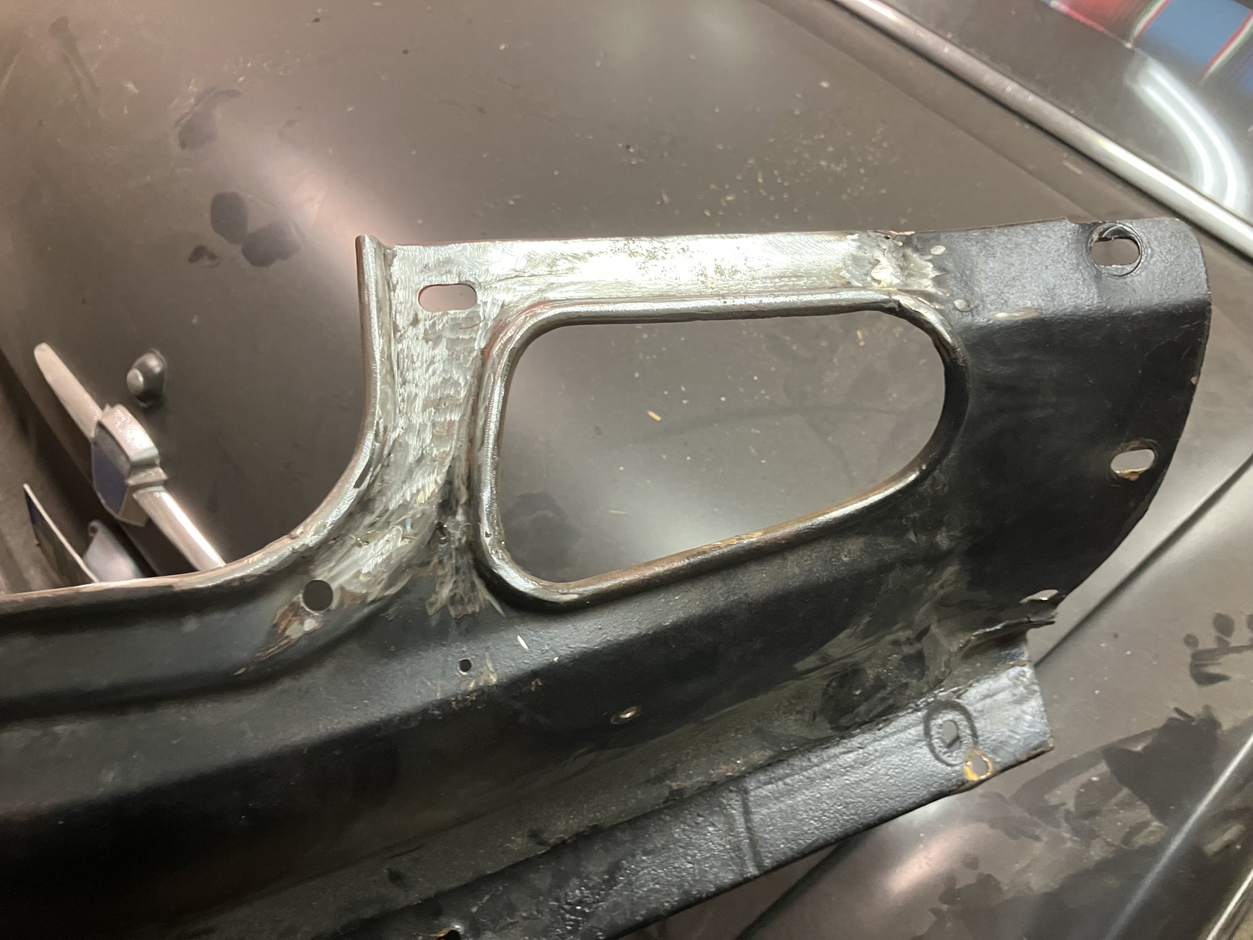

    Now I have welded/repaired the cut up shroud pieces next to the radiator support. There were crudely modified by someone, to hold a 1987 chevy van radiator with its horrible plastic shroud. (I sold that one, together with the 305/th350, to some so called swedish rägers.)
    I also mounted the u-shaped radiator support and test fitted an aluminum radiator.
    Thanks, absolutely helpful! Now I also see how the ignition coil is supposed to be mounted.
    osage orange and down-the-road like this.

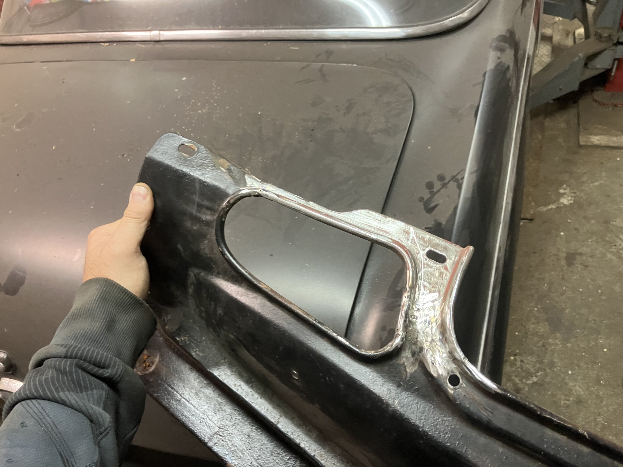

  30. I have been working on the linkage, and I believe it operates correctly now. The 56 4bbl and Ford-o-matic bell crank I bought seems to fit the 55 Mercury linkage that Rocket Scientist Chris posted. So I have bent/welded/fabricated a similar linkage. Thans for the help, everyone.
    Also, I have repaired the radiator surround plates. They were destroyed, to fit a van radiator.
