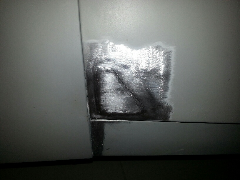

    Well nothing to exciting today but a bit of progress none the less. Slow and steady wins the race. A few small rust repairs, welded up some after market mirror holes and Victoria name plate holes.

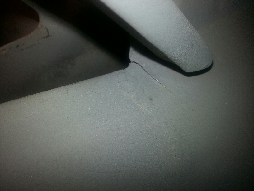

    Time to fix the dreaded 1/4 panel crack that we see on so many of these 55 and 56's. This one had been fixed a few times prior but it was never fixed with a backer, it was just welded up. I always choose to use a backer and also to hog the crack out a bit wider to get a good penetrating weld right down and into the backer.

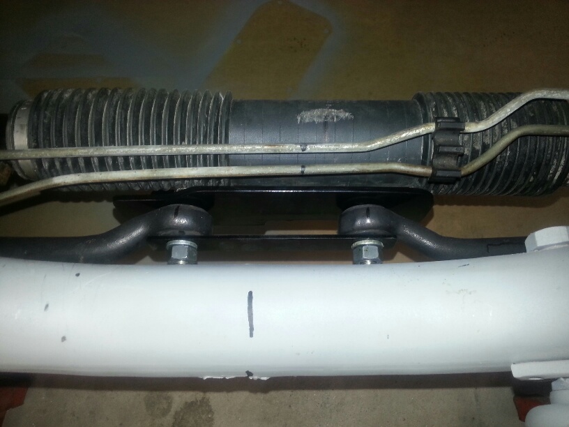

    Well the last several days have been somewhat productive, I have the steering rack in now and I am happy with the way it turned out. The brackets and angles etc were tedious to make! Shortened the steering column 3" and need to pick up some Borgeson u joints and wrap it all up.

    Yes the install looks pro so far. I really like the use of original holes to mount the brackets. Post some pics i,m sure some other guys building fords would be interested. Should handle great. Nothing worse than a ill handling car for serious miles.

    Here is a pic, this one is just before I completed the center bracket. Note the brackets bolt to the original holes in the frame. rack nov 12  2015.jpg

    A finished pic of the rack set up.

    Member Tedley and a good buddy of mine did this exact setup on his 50 shoebox build a few years ago. I have had the opportunity to drive his 50 a few times and it handles extremely well so I knew this is what I wanted to do. The rack is a early 90's Cavalier and the brackets I fabricated. I used the stock mounting holes on the frame from the removal of the octopus it had in it for the stock steering. Location and geometry are very critical but now that I look back it was a easy little project to do.

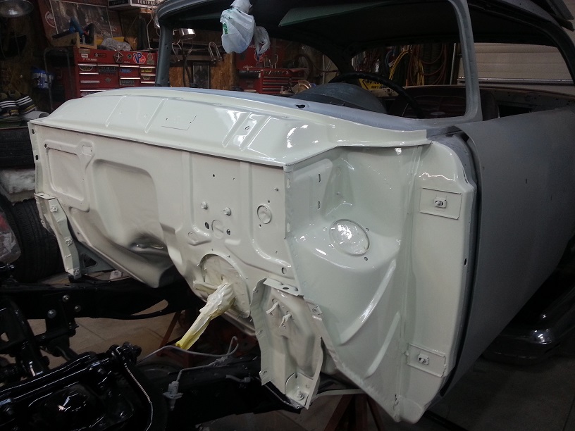

    Well a little bit of color is on, now the motor can go back in and hopefully it can stay there a while! The color is a Chrysler color, Cool Vanilla.

  24. tedley
    Joined: Nov 8, 2009
    Posts: 2,147
    tedley
    from canada
    Looks great, motor ready to go in? This project is bombing right along

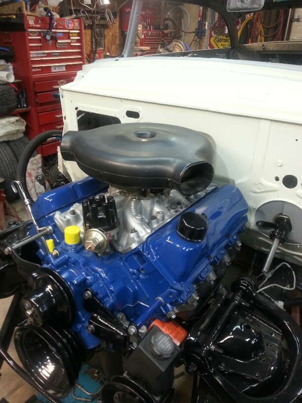

    Well has been little progress over the last little while, motors in so will run some lines now, hook up the steering coupler etc and then start to prep the inners for paint
