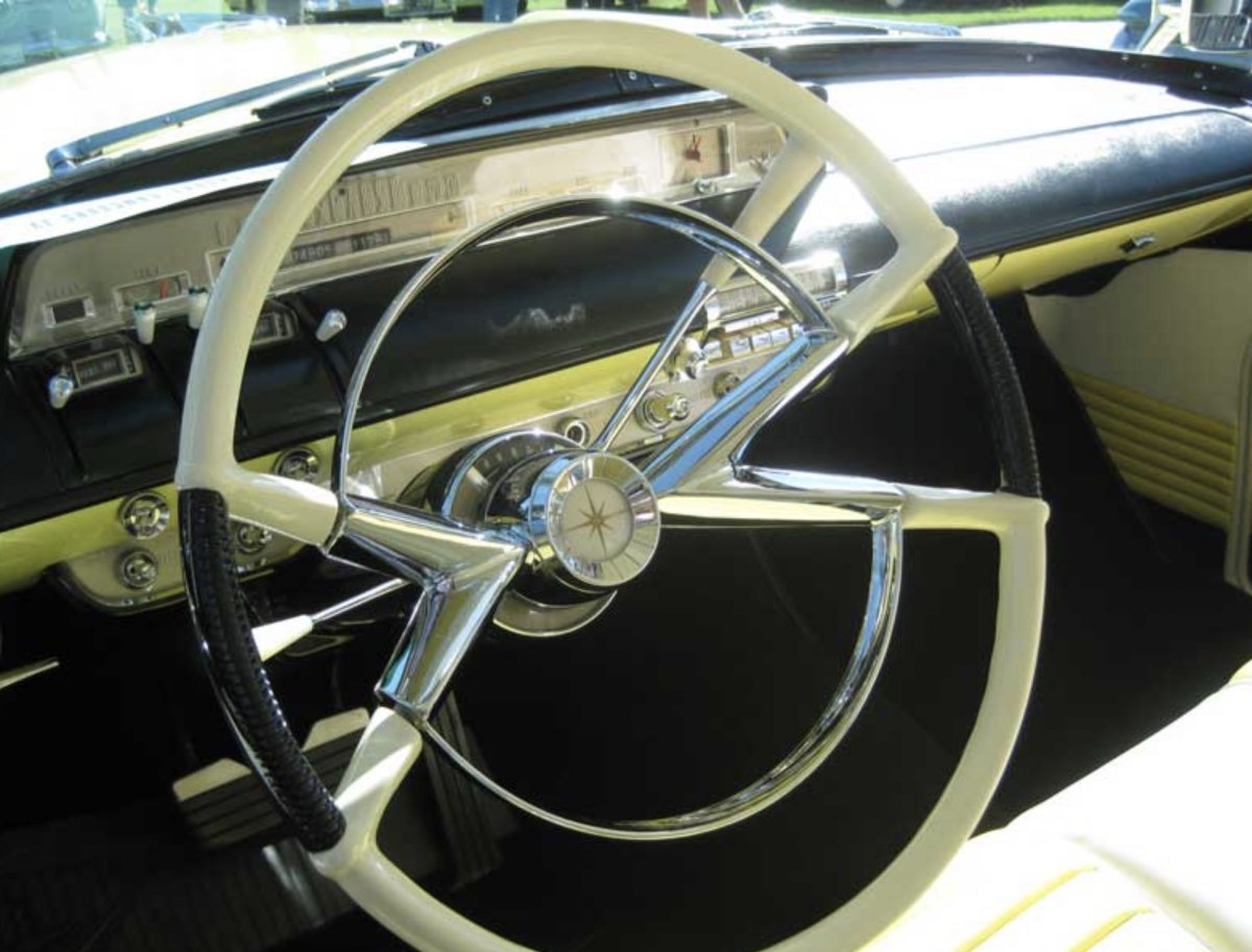

    Im shelving the blower idea.
    As far as the Cruise-O-Matic goes, I have 2 of them in my 59 Lincoln Connie and my 61 Connie. Both are smooth performers and have the "Bulldozer" 430 MEL engines. So they are torque monsters bar none as far as a lux-o barge goes. I think thats my best bet. Its close to being gennie too.
    The only issue I see is that the COM tranny has an D-1 and D-2 setting that lets you shift from 2nd gear in snow in D2. I want to keep the original gear selector indicator. Would just using the original Drive setting work?
    I do not want to replace the steering column or anything in the cabin.
    Ill try having the steering box rebuilt with 57 parts. Keep it stock.

    You could just as easily leave the column and indicators alone and just feel for the gears with the detents in the transmission. I, as well as hundreds of us here I'm sure, have logged thousands of miles with basic "universal shifters" like a Hurst Indy-matic, Mr. Gasket or the like with no gear indicators whatsoever.

    It will work, but you won't be able to select manual low gear unless you do some modifications to the shift linkage. If I remember right the D position on your column will give you D2 and the L position will give you D1.

    IIRC, jimmysix here did the Fordo to com conversion on a 56 Ford and got the column shift set up to work. Might have been over at yblocksforever that he did the write up. Might be worth a pm to him for his info.

    The original column should work just fine,I presently have a C-4 in my 55 that only has D and L but I can get all three with it and no modifications to the column.
  30. Yep, I did a 351W and FMX swap into a '56 sedan I used to own, the stock column worked. I did have to modify the lever at the trans to get the proper travel (a hand-made bolt-on bracket) so that the neutral safety switch worked right and the indicator showed reasonably accurate, but not a big deal.
    And I'm pretty sure I saw somewhere that the '56 Lincoln and Mercury steering columns share some parts with the '58-60 T-Birds, it may be possible to convert your column to the D2/D1/L detents. They are reproducing the T-Bird bits.
