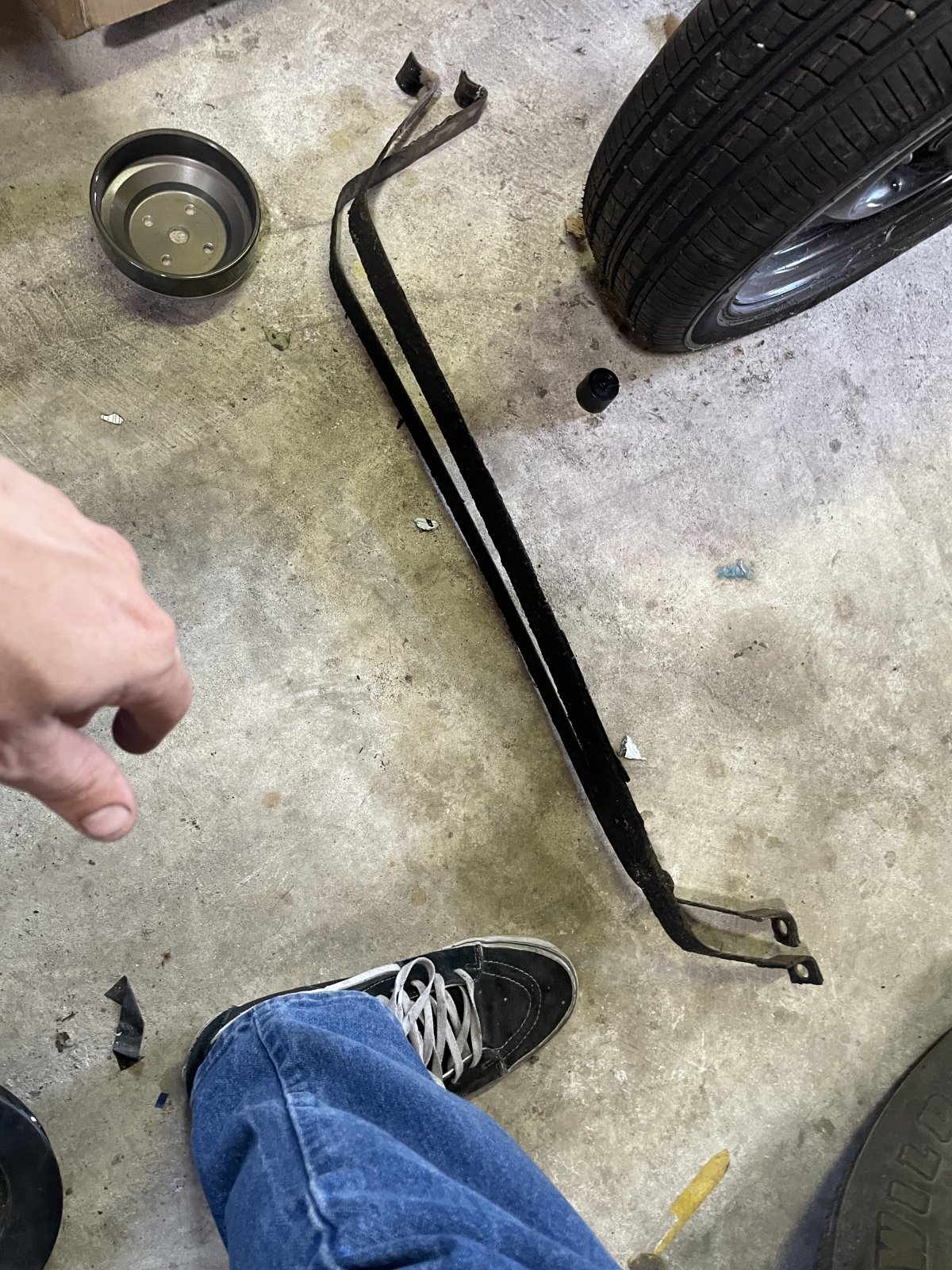

    I got a new tank for my Mercury project. The car didn’t have a tank installed when I bought it. I’m at a loss on how to mount it. I have straps and they seem to fit in some slots in the rear. In the front of the tank there are hooks. I don’t however see any holes or mounting hardware underneath. I thought I was supposed to bolt the tube across, but I don’t think that’s right. IMG_1126.jpeg IMG_1089.jpeg IMG_1088.jpeg IMG_1086.jpeg Any insight is very appreciated.

  3. BJR
    Joined: Mar 11, 2005
    Posts: 11,277
    BJR
    I believe the goofy bends on the straps go into the slots in the rear frame, and the J bolts hook over the hooks hanging down behind the rear end. This is just a guess from looking at the pictures.

  4. In_The_Pink
    Joined: Jan 9, 2010
    Posts: 977
    In_The_Pink
    I don't think he has any j-bolts? I think those are the missing pieces, and the tube is there to keep the front ends of the straps from spreading apart once everything is in place.

  5. Rocket Scientist Chris
    Posts: 657
    Looking at my ‘56-‘59 Mercury Ch***is Parts book, I’m pretty sure you don’t have the correct straps for ‘55-‘56 Mercury Hardtops/Sedans. The straps should fit onto the the hooks near the rear axle. The straps will have a vertical slot. On the rear, the straps are fastened onto threaded studs. If you don’t have studs present, there should be two female treaded holes. And, there is no cross bar between the two straps. Have you test fit the tank? If I remember correctly, there should be some locating “bumps” in the trunk floor that the tank fits onto. Hope this helps! :)

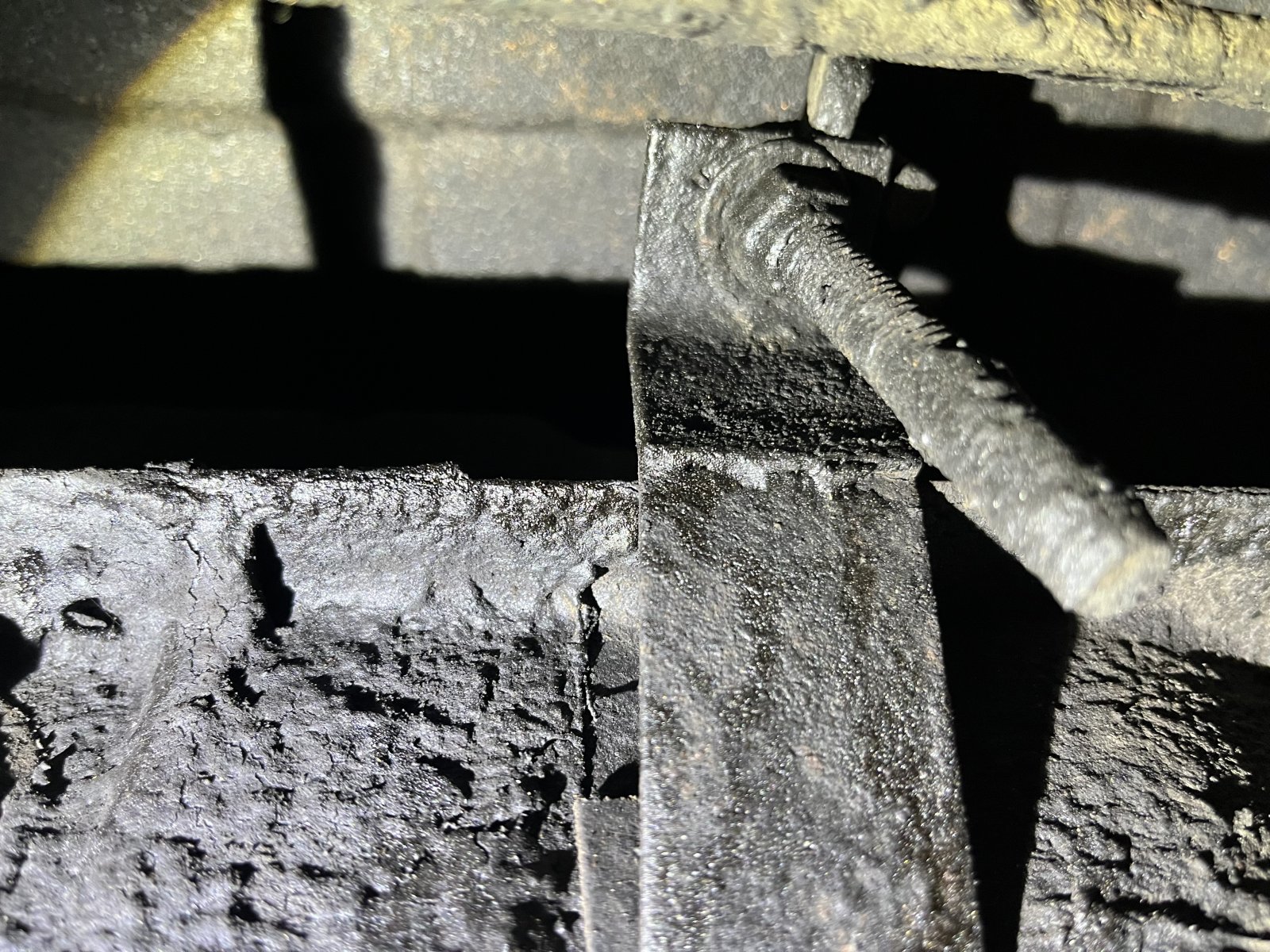

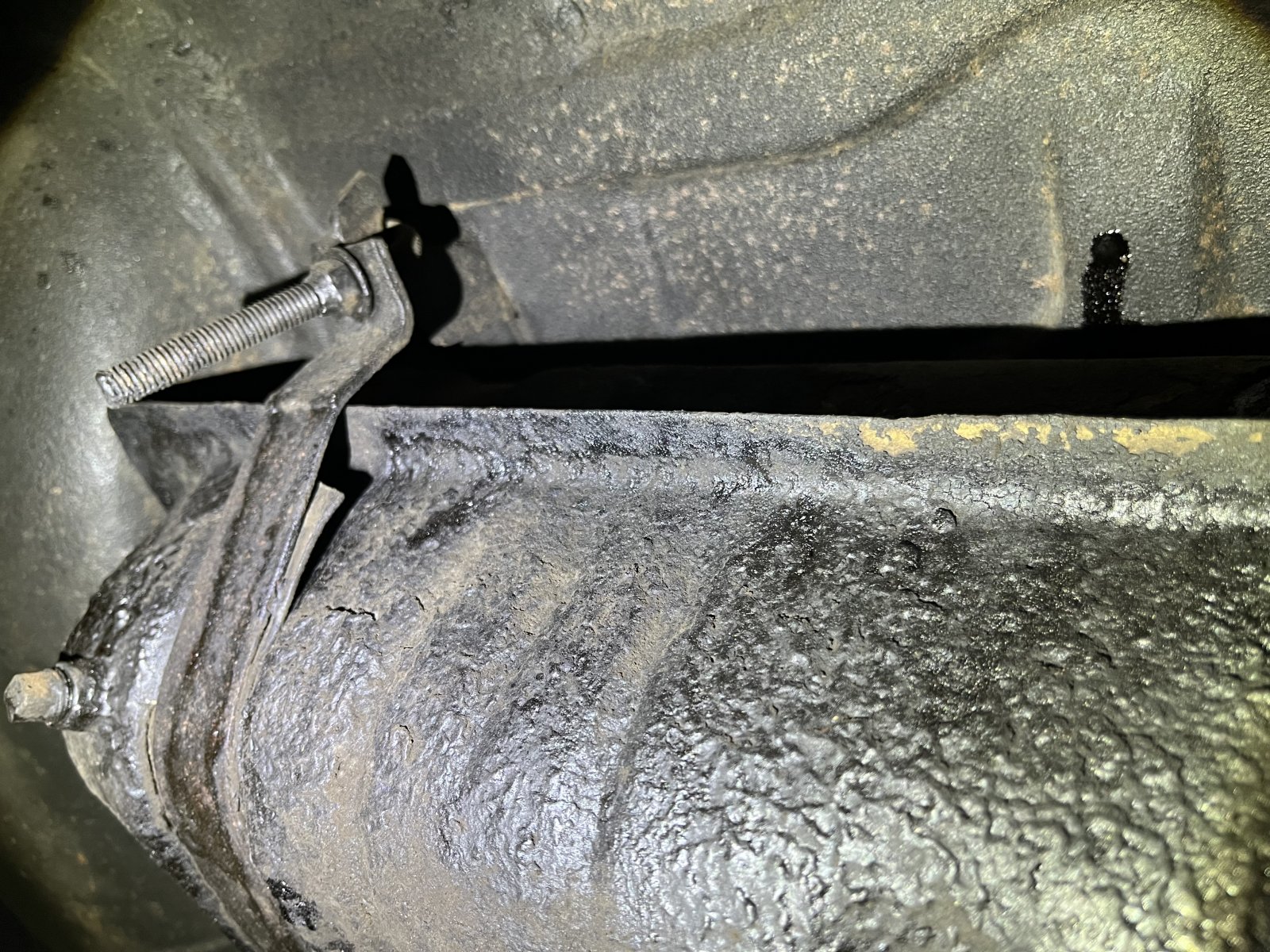

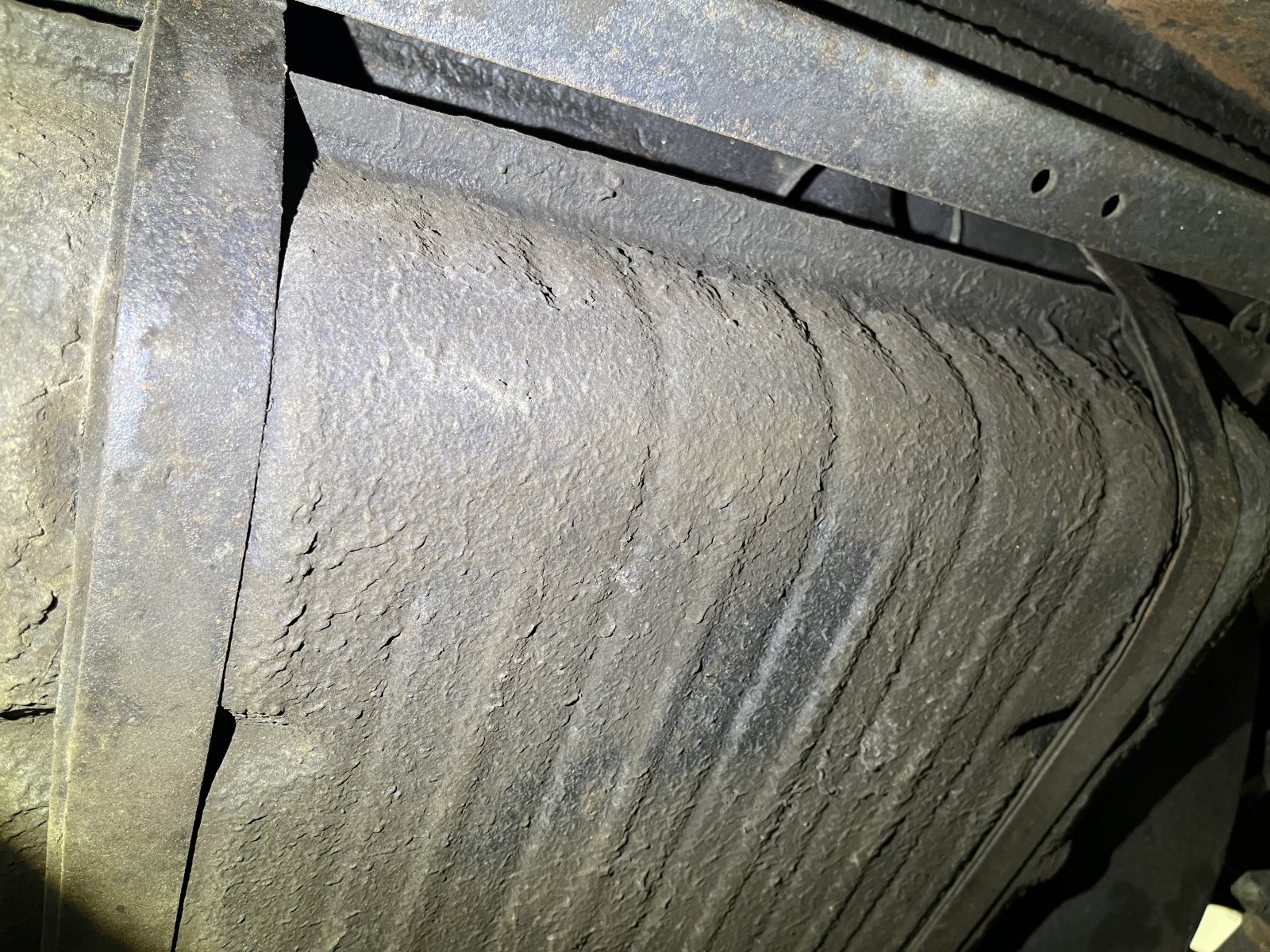

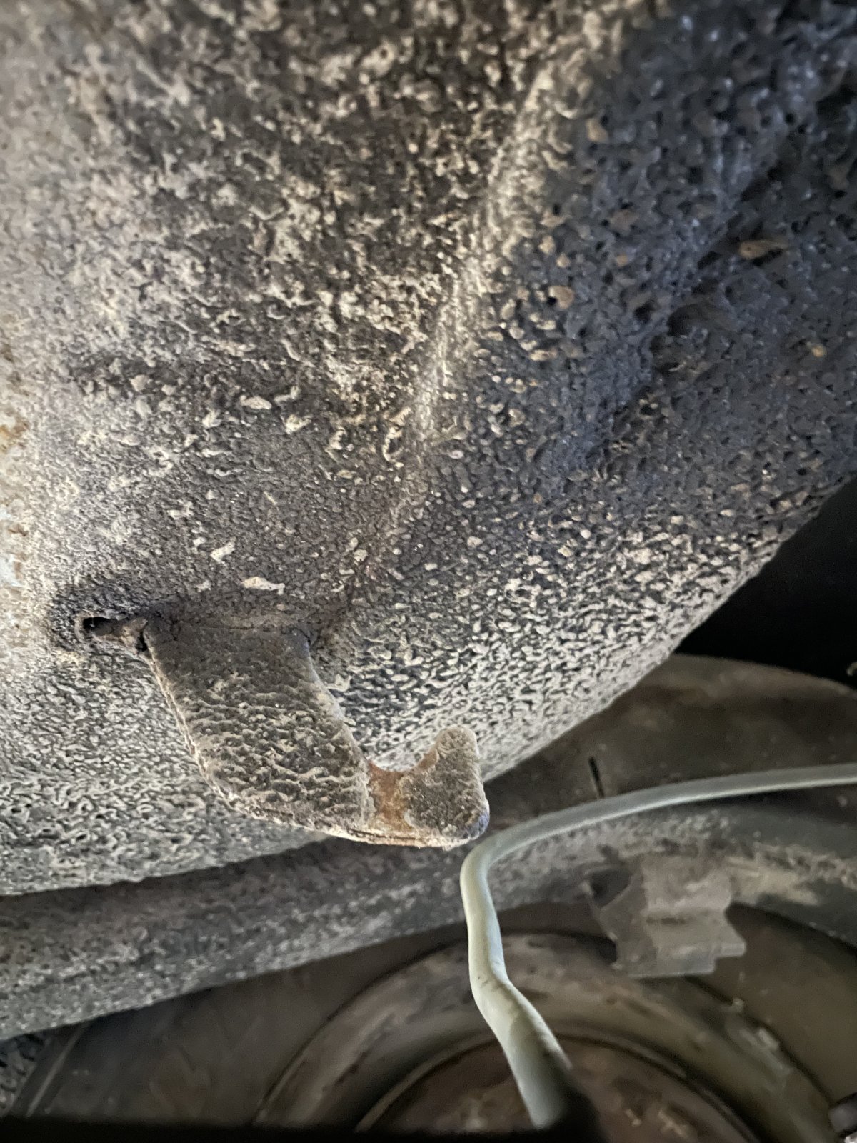

  8. Abchoppers
    Joined: May 31, 2023
    Posts: 55
    Abchoppers
    Here are some pics I just took of my 56 Mercury tank, don’t know if they help or not
    First two are the rear of the tank, last two are towards the front of the car
