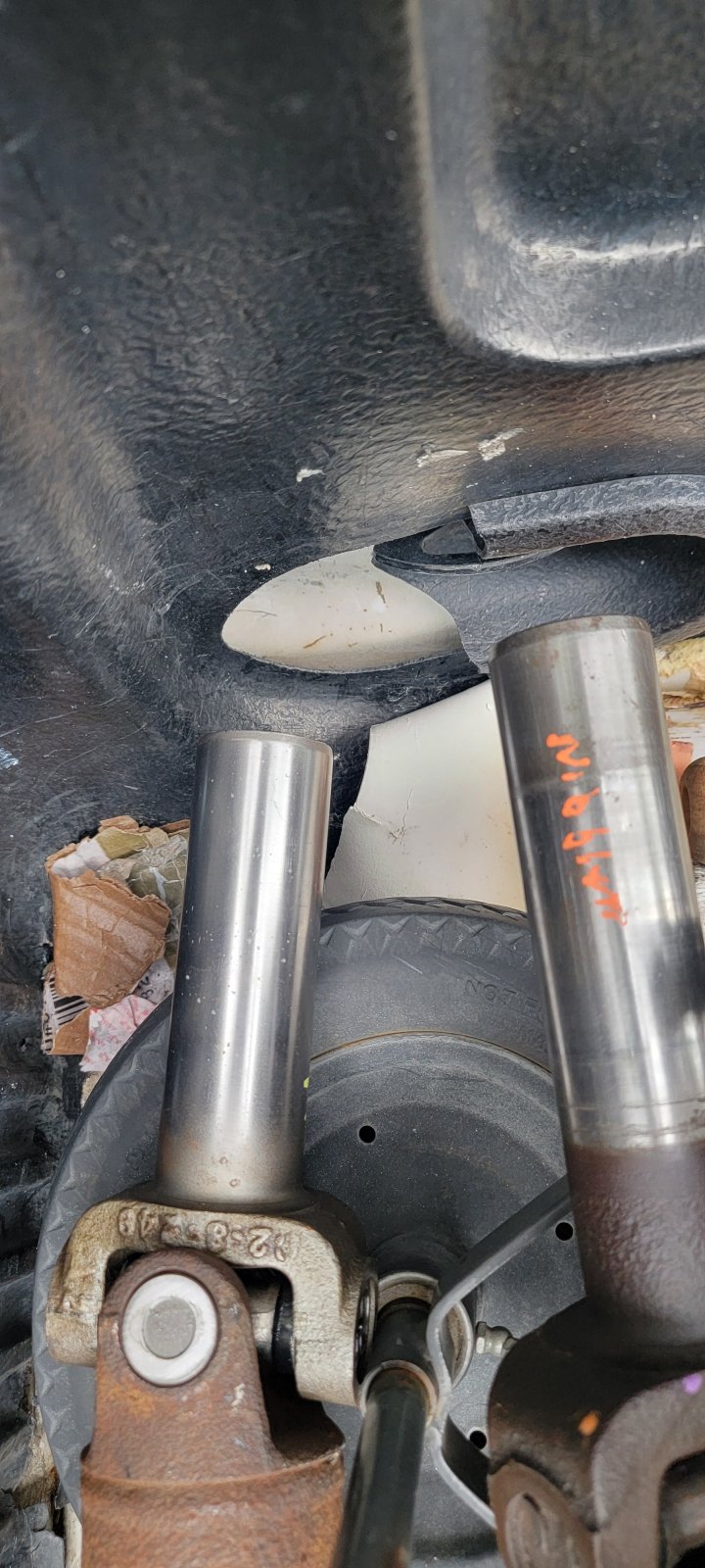

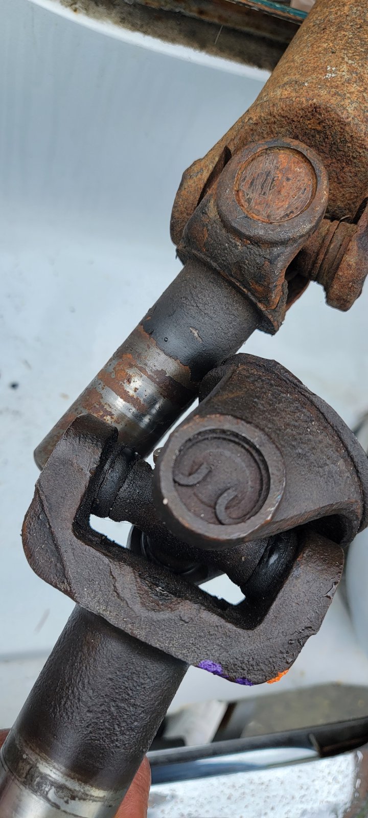

    Good day, I have a question.I have a OEM 56 MERCURY drive shaft and my car has a C6 transmission and I have the transmission yoke and the rear-end is the ORIGINAL 1956 Mercury I want to install the drive shaft. Does Naepco make one ?? Or take it to a drive shaft shop

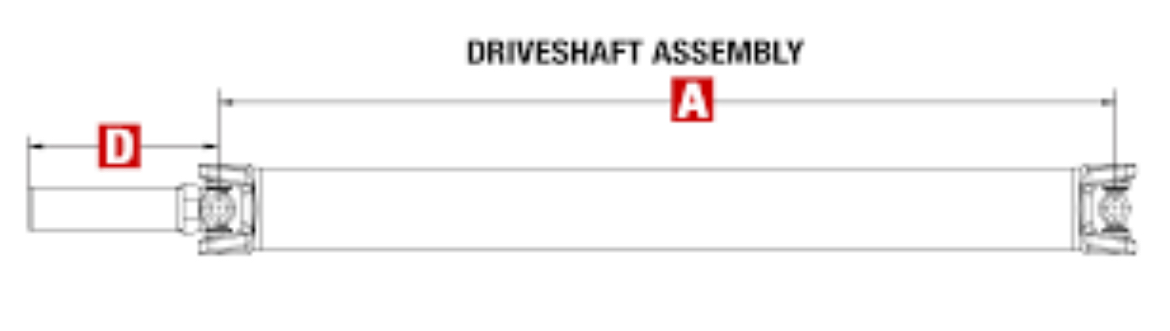

  2. You need the trans yoke in place to measure for a shaft anyway. Need the engine and trans mounted. Car with weight on the rear axle.
    Install the c6 yoke, allow about 5/8 to 3/4 for the yoke to move before bottoming out.(pushed all the way in)

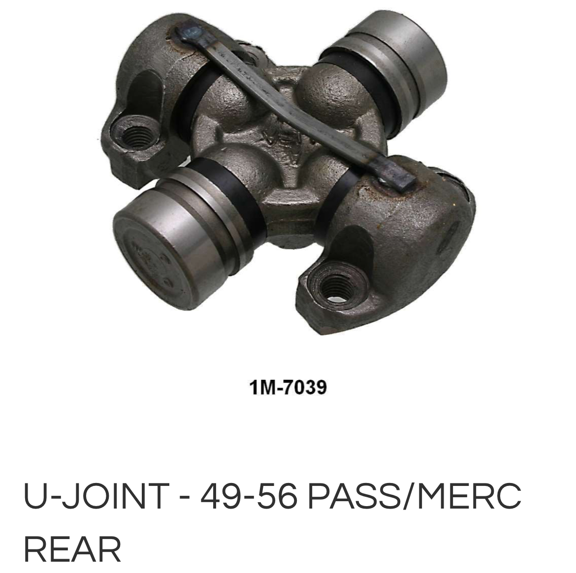

    That merc rear u joint is probably like this
    need to measure from the center of the rear u-joint to the center of where the u-joint presses in the trans yoke
    Need to figure out what u-joint the c6 yoke uses and what front u-joint the merc has. There are conversion (*******) u-joints to hook up different series u-joints

    Good evening to Everyone. Just got my driveshaft from the shop, they had a C6 yoke in stock that someone ordered 1 year ago and didn't get it. I had to wait 2 days for shipping..Parts and Labor was $103.00 .. New C6 yoke to 56 Original driveshaft. Next is the column linkage to transmission and exhaust 20240806_174125.jpg

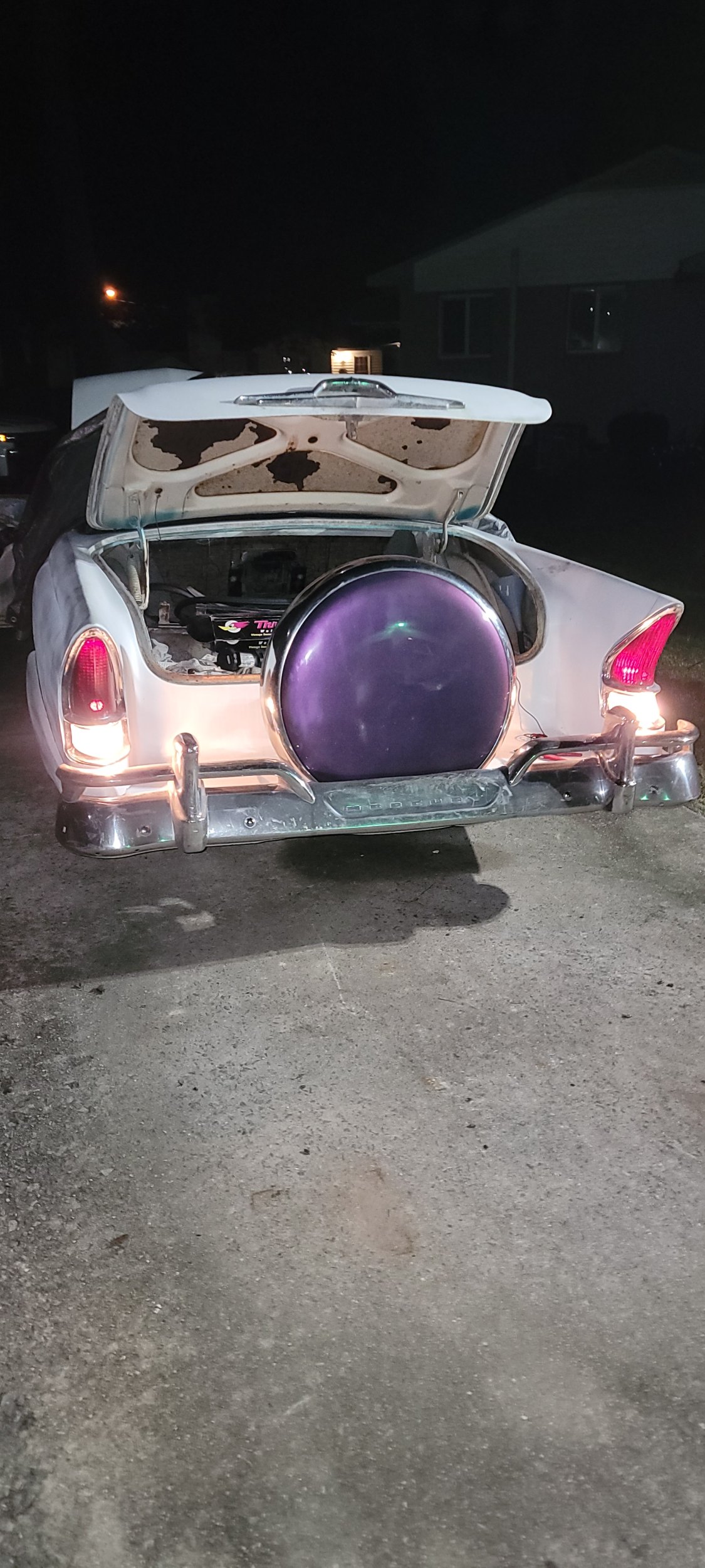

    Good evening..Been jammed working...I got the driveshaft situation FIXED!!!!!! She moves correctly, made my column shifter linkage with some ingenuity..EVEN the Backup lamps working in reverse 20241014_202236.jpg
