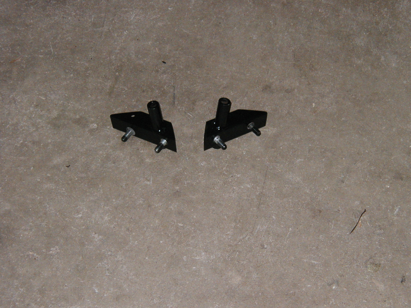

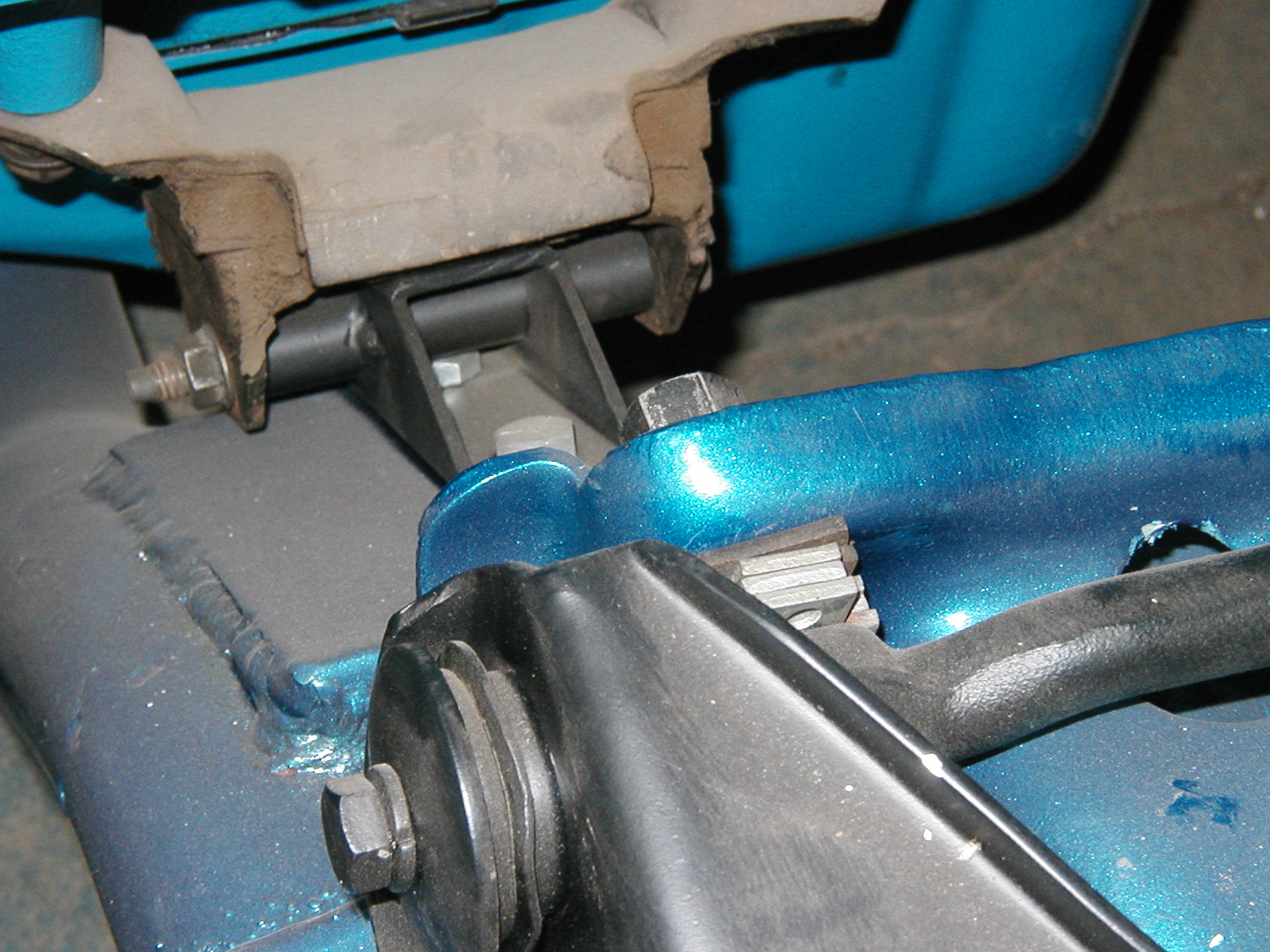

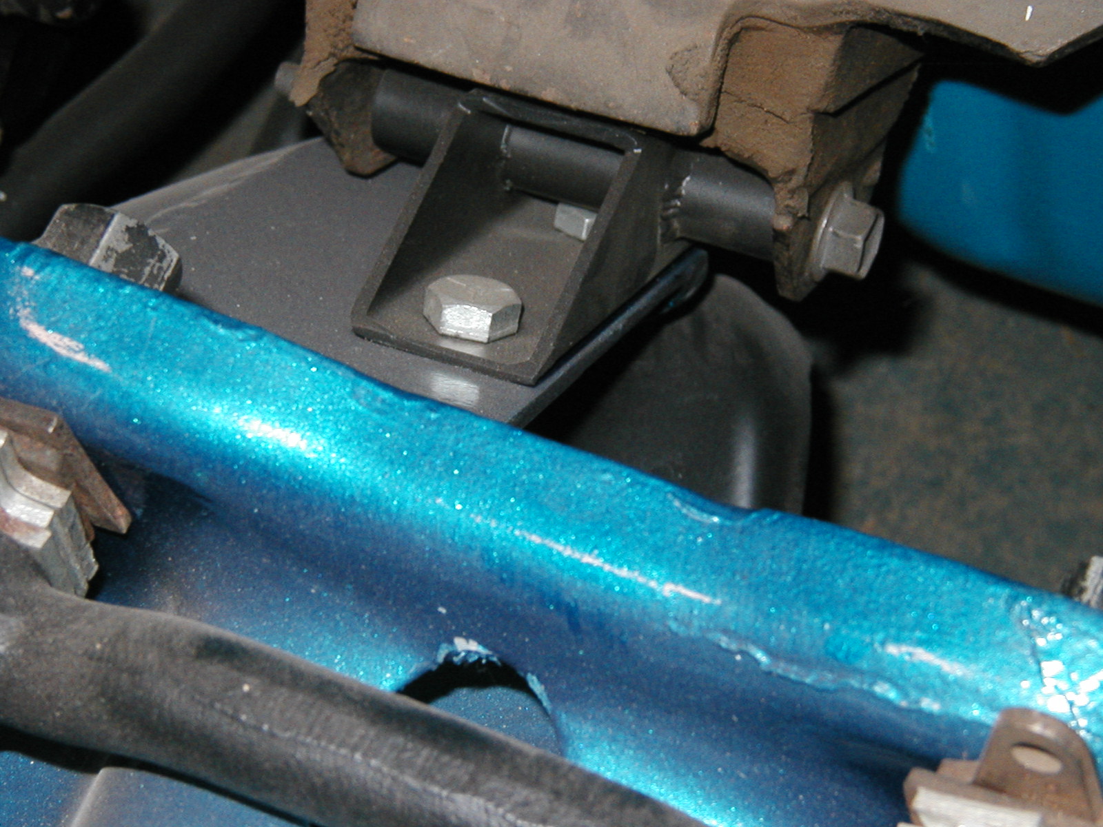

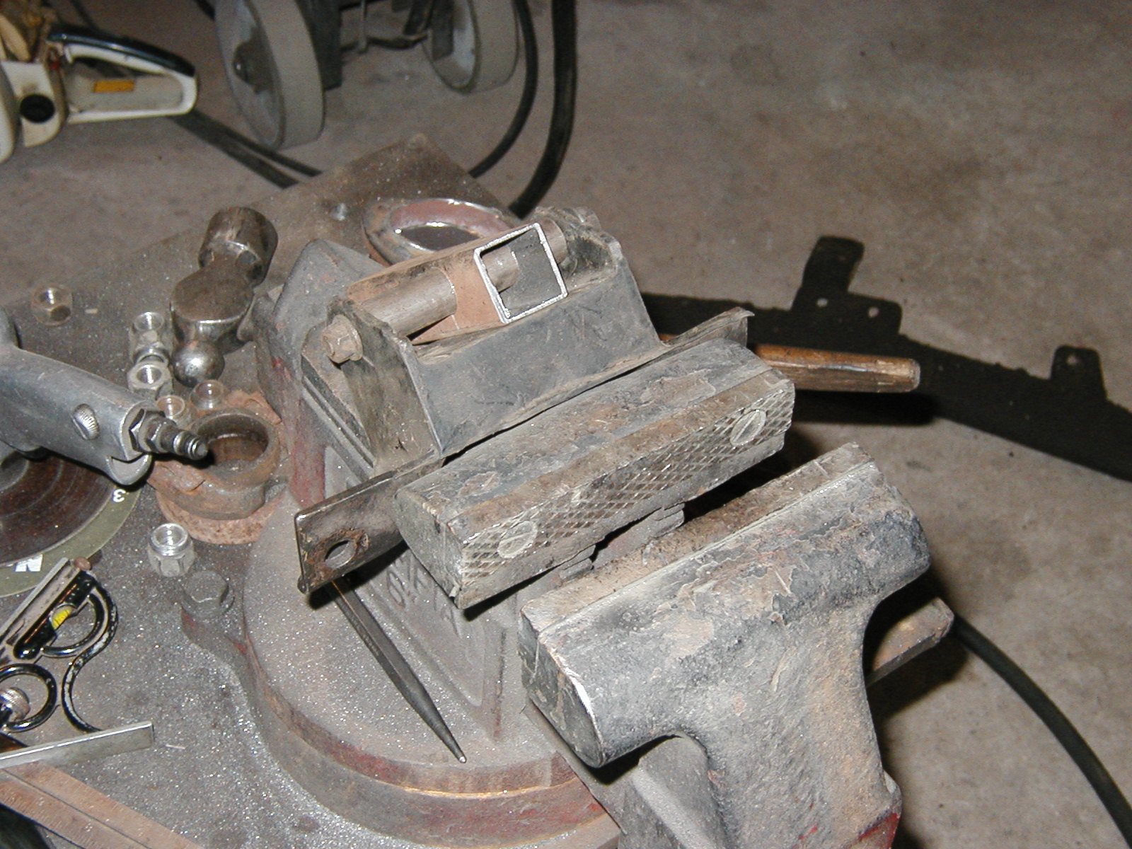

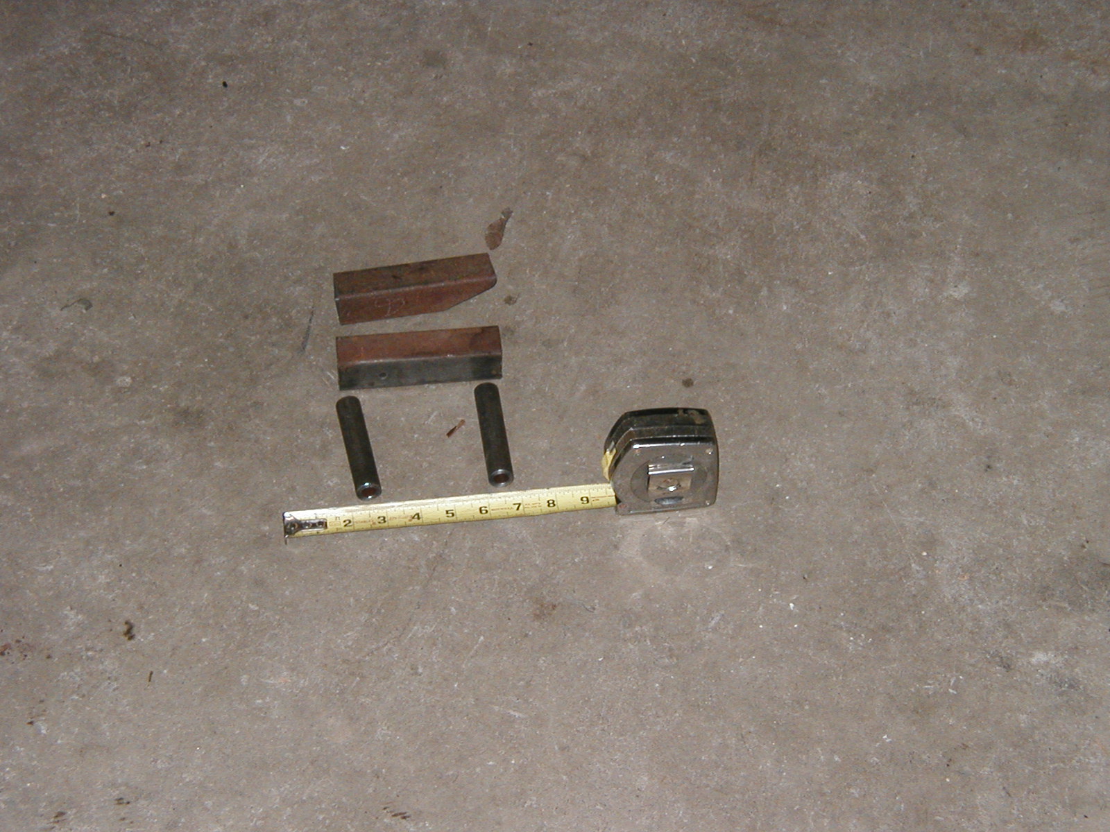

  3. 56 was the first year of 12 Volt. That's a big plus. The C-4 trans mount bolted right in the stock Merc location. I probably had to do a little length adjusting to the driveshaft, might have been as simple as just changing the slip joint. Speedo cable was a plug and play. I used the 302 rubber mounts and hand built the missing link. Trust me, it's kids play. No aftermarket kit will be any better.
    57 wagon mounts 001.jpg 57 wagon mounts 002.jpg 57 wagon mounts 003.jpg 57 wagon mounts 004.jpg 57 wagon mounts 005.jpg 57 wagon mounts 006.jpg Mounts installed 001.jpg Mounts installed 002.jpg
    These photos are from 3 different builds but give all that's needed to do the same thing. The 302 front sump oil pan fits just fine. I simply used the stock 56 Oil and Temp senders in the 302 so my stock gauges were correct. Everything relate to Ign was plug and play.
    So you know I have been doing this stuff over 50 years so the onset to do it may not fit your abilitys but it's really as simple of a motor upgrade as you can get into. No carving up the ch***is, no electrical mods needed, a little exhaust work and a few hosses. I bet over the years I've hand built those mounts 10 times. You want to be sure to bevel both ends of the tubing so you can access the bolts easier.

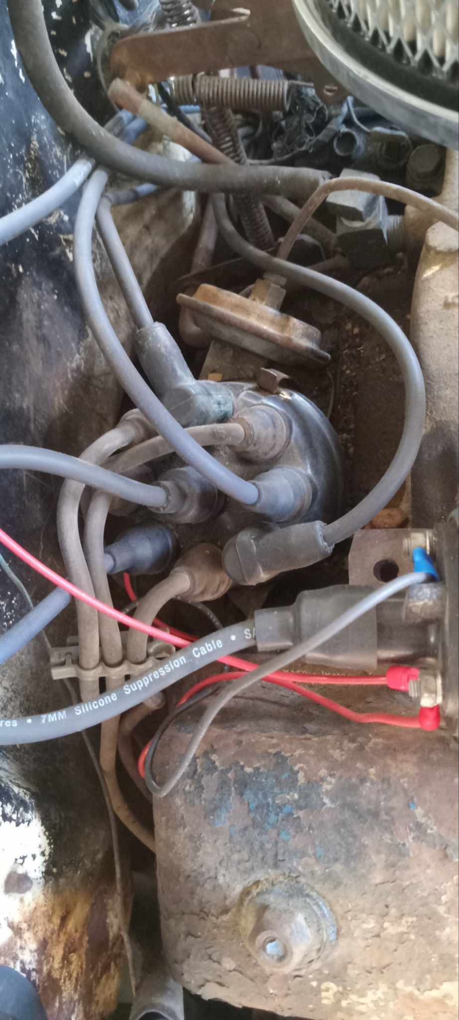

    Also what i see, is you have original loadomatic distributor.it will not work with that holley what is int it now. Check the distributor and if its loadomatic, you need 57 or newer distributor.

    Im not sure what you mean. While I have not driven the Merc except for on/off the trailer and in/out my garage, the engine starts and seems to run fine with the current distributor.

    If I’m seeing the picture correctly, the above comment is correct. The 56’ I’ve seen use a dual vacuum can, the 55’s a single. Both are matched to an individual carb (usually a Holley teapot). Unless that combinations is correct, you get no proper advance either as a “vacuum advance “ or “mechanical “ advance in a conventional distributor. Changing over to the 57 up distributor is simple. Car will start and idle fine, but lay down on power as it doesn’t advance with rpm. Or it’s set to run at speed, and cranking or pinging is a problem down low. Many yblocks have been pronounced “no damn good” because of that. Get that part figured out before you decide on and engine change.

    A stock 56 Mercury engine used a Load-O-Matic distributor. This distributor had no centrifugal advance. Instead it used a venturi vacuum signal from the carburetor to move the points plate to advance the timing with rpm. If your vacuum canister on the distributor has two vacuum ports, you have a Load-O-Matic. If you only have one vacuum port, it is probably a 57 or newer distributor with centrifugal advance. An easy way to determine which one you have is to remove the cap and attempt to move the rotor. The Load-O-Matic rotor is fixed and will not move. The 57 and newer with centrifugal advance will rotate a few degrees counter-clockwise.

    Just checked and my dist. only has the one vacuum port so I ***ume it is NOT the Load-O-Matic. 462576680_1378856499752471_2104540853213534440_n.jpg 467482481_1462429861101166_6664823613484031305_n.jpg

    It appears you have a ‘54/‘55 Ford/Merc Load-O-Matic distributor. The large diameter vacuum canister with the threaded fitting for the rigid tube is a good indication. The ‘57 & up distributor has a smaller diameter vacuum canister with raised hex portion and a slip on vacuum hose connector. The only way to difinitively tell the ‘54 and ‘55 apart, is to remove the distributor from the block. The ‘54 will have a 13 tooth drive gear (if I remember correctly) and have a “tang” that engages the oil pump drive. The ‘55 will have the same drive gear as the ‘57 & up distributors and the same hex drive that engages the oil pump.
    So, if you discover you have a ‘54 distributor, you most probably have a ‘54 Y-block. This will make the ‘57 up distributor swap a little more time consuming. The ‘54 drive gear needs to go onto the 57 up shaft and the ‘54 oil pump and drive needs to be replaced with a ‘55 up oil pump and drive. The ‘55 distributor is a simple swap with the ‘57 up distributor.
    Unfortunately, the ‘57 & up distributors are not as easily found these days. The swap is much more common knowledge, now! :(

    Not here to argue with anyone. But that picture clearly shows the early vacuum can RSC id’d above. It’s definitely a loadomatic. That’s the first thing you want to straighten out before you decide to change the engine. The chance’s of a 54 239 or 256 being transplanted are fair slim. A 272 or 292 much higher. But, it could still be a 312 someone mismatched parts onto.
    All the loadomatic’s, flathead, V8’s and 6’s (they were around on 6’s a lot longer) were carburetor engine specific. Many didn’t understand that or how they worked.
    While oem 57 up distributors are getting tougher to find, Ted Eaton (https://www.eatonbalancing.com/ has found some decent aftermarket replacements. You’ll find that at http://forums.y-blocksforever.com/default.aspx. Try the search function.
