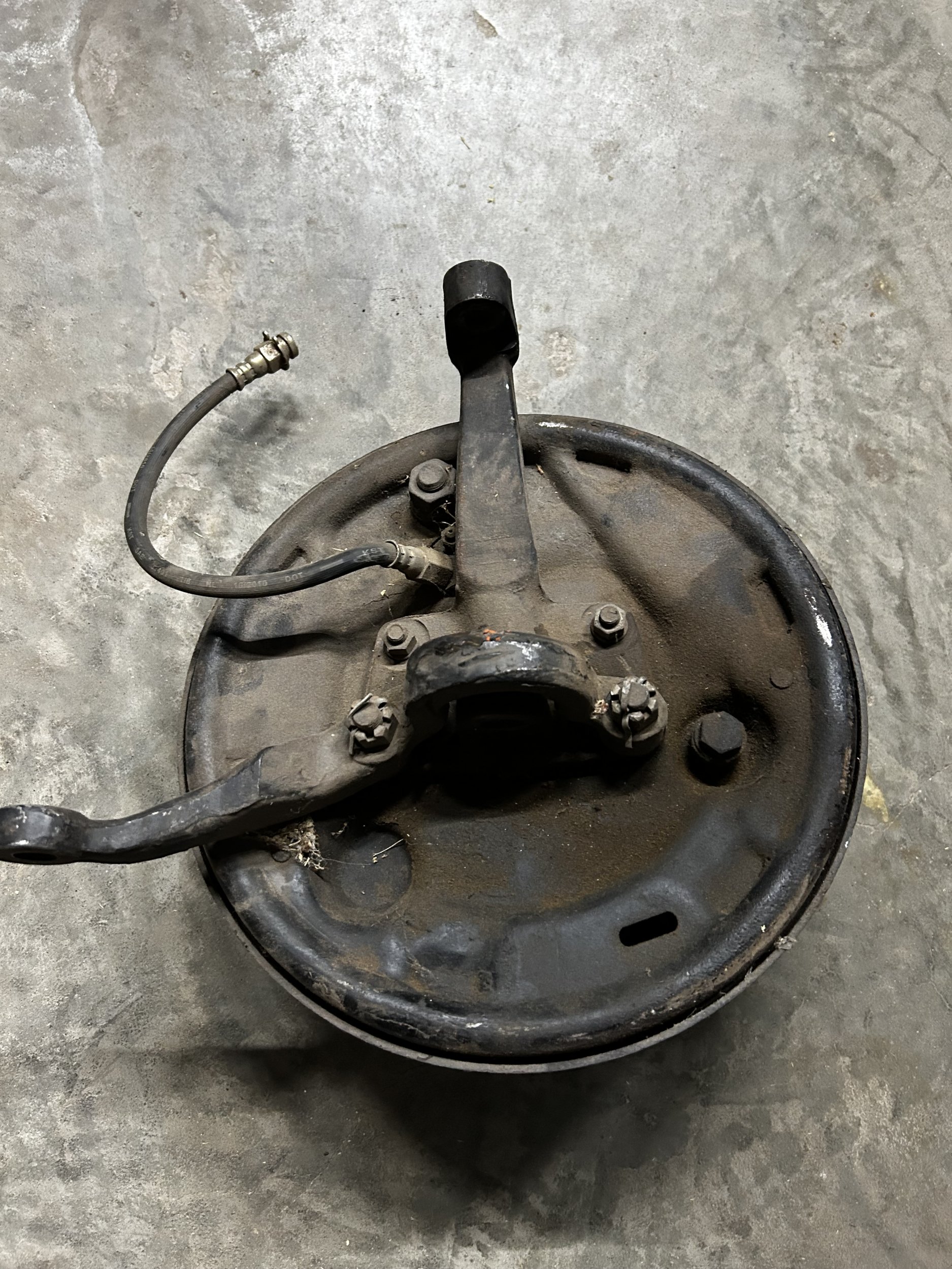

  9. guthriesmith
    Joined: Aug 17, 2006
    Posts: 11,972
    guthriesmith
    I have a set of good drums off a 55 if you don’t go disks.

  13. guthriesmith
    Posts: 11,972
    guthriesmith
    A picture would help us a lot on answering that. And, might also confirm that the ones I have are the same. :D

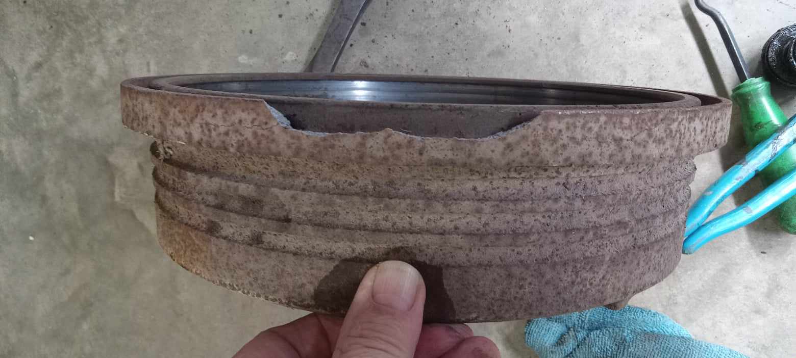

  16. T42
    Joined: Jul 26, 2006
    Posts: 384
    T42
    Ok, got the front brake drum off. Good news is, the front brake shoes also look like new! Here's a pic of the area on the back of the drum with the damage. I dont feel it will effect the operation of the brakes. Im going to clean up the damage area with a dremel tool and put it all back together and see if it has any balance issues after I drive it a bit.

  17. alanp561
    Joined: Oct 1, 2017
    Posts: 5,581
    alanp561
    I would suggest that if you are going to drive it like that, take it somewhere and get the tire and drum balanced as a unit. Surely there's somebody still balancing on the car.

  18. The lip on the backing plate fits in the groove to keep out dirt and debris. The inside of it is the important part. If it causes a balance issue, I'd chuck it up and turn the lip off just till the till the breakout was removed all the way around. In fact, that's exactly what I would do instead of spin balancing to compensate. If you do that you must be sure to put the wheel back on exactly the same stud rotation to keep it in check.
    warbird1 and T42 like this.
  19. Id replace the drum. Very common when iron cracks it send stress cracks throughout. Could come apart
    guthriesmith likes this.
  20. jaracer
    Joined: Oct 4, 2008
    Posts: 3,056
    jaracer
    I wouldn't use that drum. It will definitely be out of balance. There is a fairly long crack eminating from the broken off piece.
  21. T42
    Posts: 384
    T42
    Pics posted. Are yours the same?

  28. Id just separate them and install new drum slip on style. No actual reason to keep them locked together
  29. guthriesmith
    Posts: 11,972
    guthriesmith
    So, my drums look a little different, but I have both sides with spindles and newish brake hoses. These were likely rebuilt before being taken off of a restored car for a disk brake swap on a friends car.
