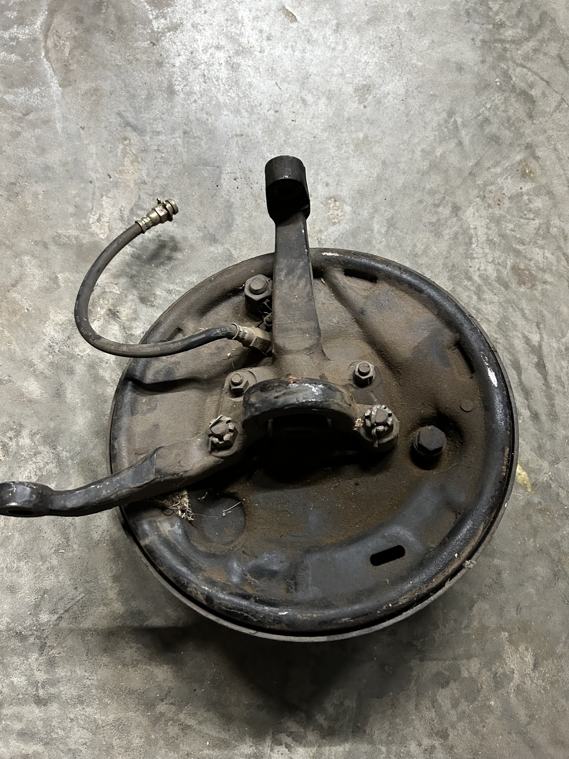

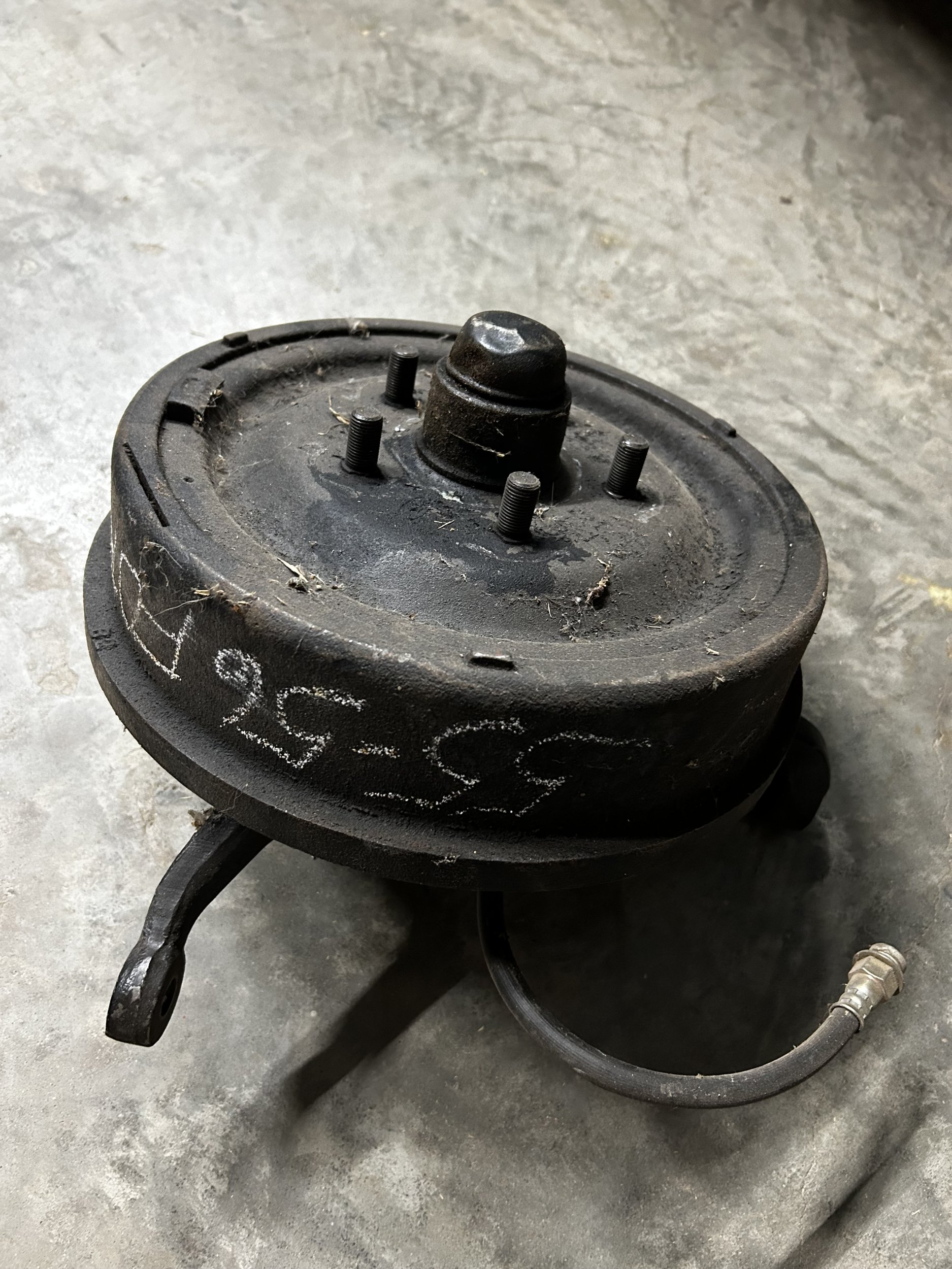

    I would take $100 plus shipping for what I have but you need to figure out whether they can work or not. I would guess since I have spindles, backing plates, etc., they should be able to work. But, I don’t know for sure.
    My parts are off a 55 Ford.
    The Chevy Pope likes this.
  11. guthriesmith
    Joined: Aug 17, 2006
    Posts: 12,011
    guthriesmith
    Sounds like the main difference between Ford and Mercury is the bolt pattern after talking to a friend of mine earlier that has a 55 Mercury. Mercury is 5 on 5 and Ford is 5 on 4-1/2 bolt pattern.

  12. Redrilling drum and or hub would be easy enough. Or if he ended up swapping the rear leaving the small Ford pattern on front would make getting a rear end with matching pattern easy

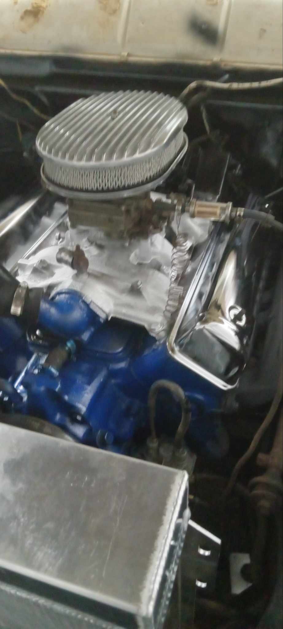

    T42
    Supposedly the 56 Merc came with a 312 engine. When I did some research, I found that no 312 engines came with a 2 bbl carb. Only '59 thru '60 offered 2 bbls. Mine has a 2bbl carb and intake. I really just wanted to replace the 2bbl with another one or possible run an adaptor plate with a small 4bbl. Does anyone have any knowledge of what 2bbl carb will mate up to my intake or what adaptor plate will match the stud pattern of my intake???
