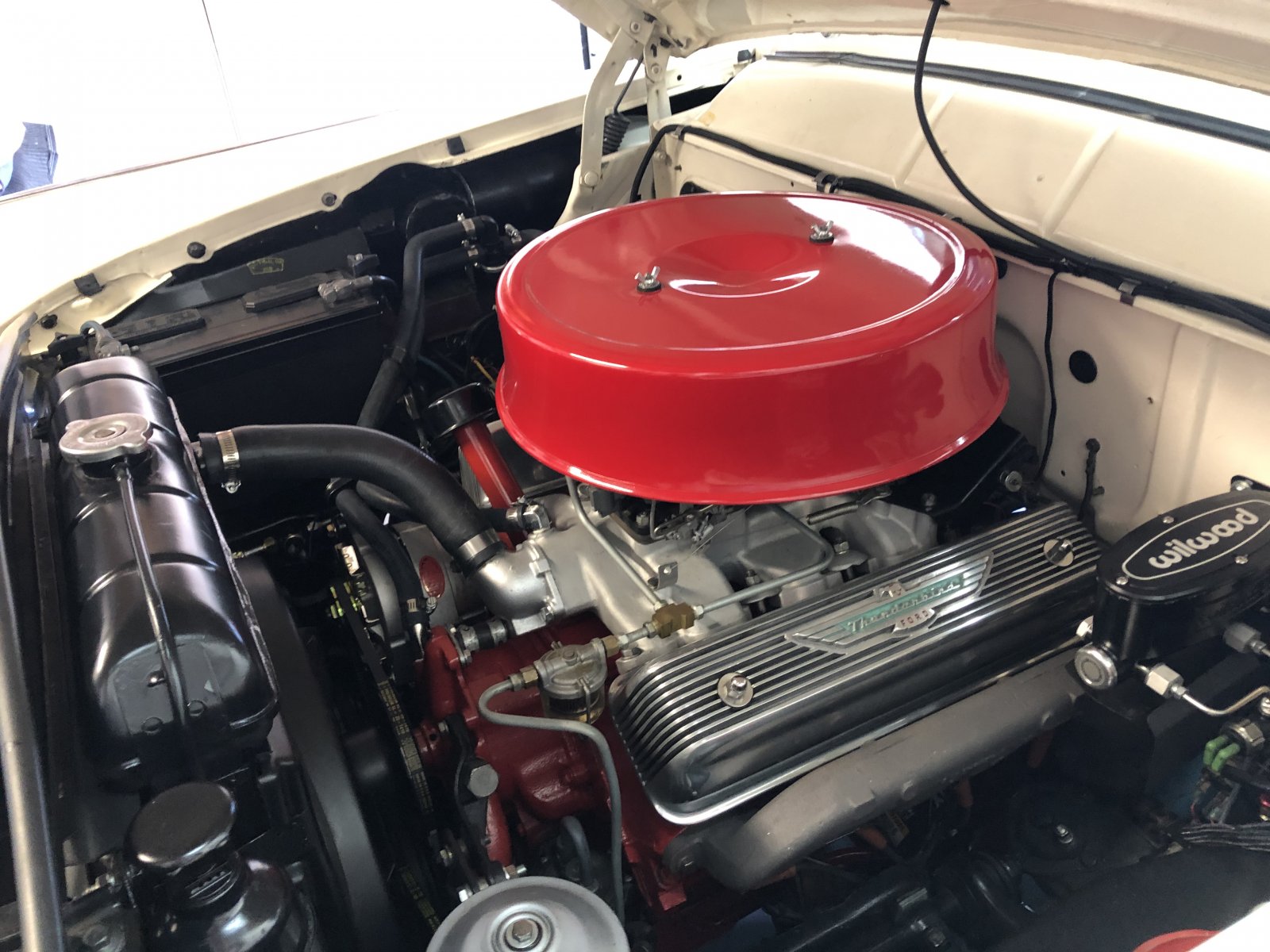

    The dual quad set option on GM Chevrolet and Pontiac, Mopars Dodges and Chrysler’s, Ford and Mercury’s were made for law enforcement and NASCAR, none were really experimental just the first time for factory available dual quads, but typically the public got there hands on them.
    Vic Edelbrock was making manifolds already in 54.
    GMs and Mopars were available stock on the cars when ordered. There is an estimate of 200 built by Pontiac and all had Rochester Carbs from what I’ve read. The Pontiac used the batwing style air cleaner on the non NASCAR as Purolator air cleaners were mandated in NASCAR for the first time.
    The 56 316”was advertised with 285 hp which was third to the 56 Chrysler 300B hemi’s and Dodge D-500 hemi’s. Ford and Mercury’s were over the dealership parts counter only and 260 hp.
    Chrysler dominated the 1956 NASCAR season with Ford, Dodge, and Chevrolet behind with no Pontiac’s winning in the top Grand National division. It’s written that more of the ended up on the drag strips across the country.
    I believe GM’s were the only large base carbs. I found photos of the Pontiac set up when researching the air filters used in NASCAR and never found a photo with a Purolator air cleaner.
    Ford/Mercury made a total of 103 dual quad kits for all uses even installed on Thunderbirds. Less than 1/2 had the Purolator air cleaner. Ford/Mercury Purolator was different than all the rest and one is on my Y-Block dual quad 56 Ford Victoria.
    Chevrolet had the most because of the Corvette. All Chrysler 300 B’s had dual quads and the Dodge was called the D-500 and no real numbers can be determined.
    Keep us informed as I will follow for sure. The photo is the F/M Purolator filter with Merc Carter WCFB’s and not the Holley 4000’s used on the Fords. DEC87049-D85C-4A03-8132-3B462D86C747.jpeg
