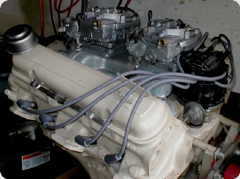

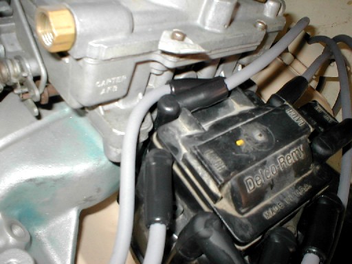

  20. I also did the PCV in the original road-draft-tube hole/spin-on filter swap on my '57 engine. In the past I've also used a factory H.E I. distributor in the old 55-60 engines, even with a dual quad setup [photo] A small amount of grinding on the intake [Offenhauser] and the cap is helpful to get some timing adjustment but it fits.
    In my case there was a plugged hole in the back of my Carter AFB that accepted a screw-in pipe nipple for my PCV hose. It all works fine. 389-2.jpg 389-3.jpg

    Thanks Rocky, pictures are a great help.
    Currently running the factory 2bbl manifold & carby, but good to know about grinding necessary on the old offy with 2x4bbls as I have one of these setups which I will be installing in the near future.
