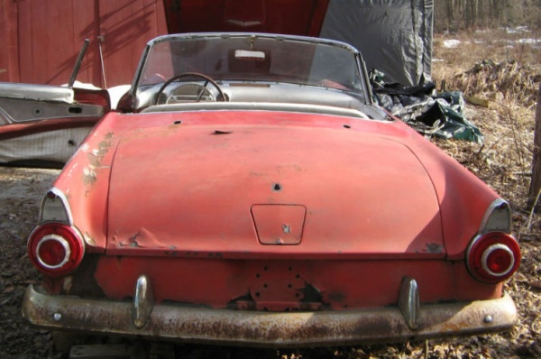

    Yes, scrounge up a 55 bumper. And trim the rear tailpan so you can tuck in the bumper.You can chose to run the exhaust however you want underneath or get a 55 rear section. ( I just happen to have one!0 Anyway good luck. All the 56 stuff will sell for a decent price to those in search of it. here's a pic of athe 55 rear section I have. Looks rusty but it is not, all in primer FYI the license plate area is a different size between the two years. I also have a 56 rear sectionlsimilar to this if you need pieces.It has the tailight areas with it.

    I don’t know if they still make them but regal roadster’s used to make a chrome steel rear bumper, no bolts showing. Be worth asking given that a 55 bumper will probably need chrome and some work. Most of the pictures show them painted, but that’s kind of the market they build for.

    I’ve seen ‘birds done with the 56 back panel (no exhaust openings or bumper overriders for exhaust) and a plain 55 bumper. Much nicer than the picture squirrel posted (on a finished car and without those overriders). I always thought that if I got my 55 repainted that’s what I’d do. But the money for the bodywork and paint always seemed to end up in the drivetrain. The bird suppliers used to sell that rear panel as patch panel for the 56. I don’t know about the splash apron or if the 56 will trim out.
