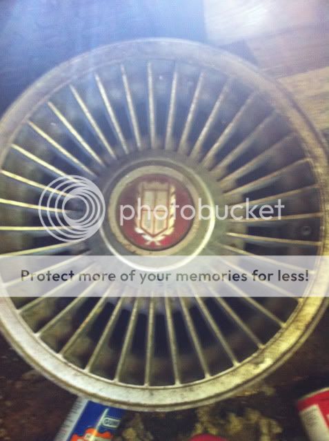

    On a side note, can anyone tell my what car these wheels are off of, I have a full set in the trunk.

    Those wheels came off a 1980s Crown Vic.

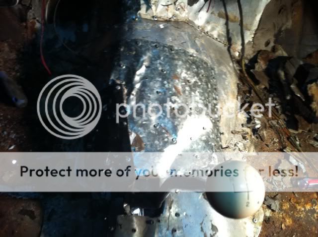

    After years of anticipation, I have finally gotten to work on her!
    It's actually doable no because it is where I have tools, and don't have to bring things with me, and indoors, so I might actually get something done.
    Thank god my dad only bought the car, and did not build it! I know he would never do the kinda work that I found!
    Started out by removing the seats, and carpet. Front seats were held on my some bent carriage bolts, and rear seats were held on by hose clamps, yeah, hose clamps.
    Cleaned out yet MORE ACORNS! Everytime I think I got em all, there's more.
    Then I saw the trans tunnel for the first time. I knew it was a hack job, but I had no idea..... But atleast now I know why it was so hard to hit reverse, it was hitting the tunnel.
    Then, it gets worse....
    And what you see here is all bondo and undercoating, from the outside! Never mind what I chipped off the inside.
    Remove some metal, find some bondo....Remove some metal, find some bondo....
    And when all the **** is out, this is what I am left with.
    All in all, there were 14 patches botched together to make a tunnel. I would estimate conservatively that there were 150 self tapping screws, and around 200 pop rivets, with give or take 3-4 gallons of bondo, and god knows how much of 3 different kinds of epoxy. If you're gonna go through all that trouble, why do that bad of a job? I mean, come on that had to have taken a long time to do.
    Well, I guess it was worth it though, found two nice suprises. Didn't know I had a hurst shifter (whole shifter, not just the stick) and an ansen bell housing.

    Well at least it'll be easy to change the clutch.

    Wow what a sleeper, hot FE, 4 speed, coil-overs, leaves and traction bars, looks like someone was up for a little Friday night stop light action. I hope the outside is not as bad as the trans tunnel!

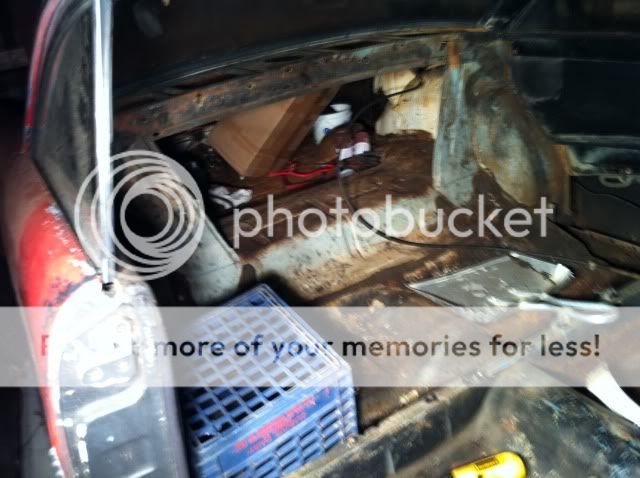

    I hope the outside doesn't hold this kinda surprise. Gonna have to clean the hood and trunk and check the nose and decking job....

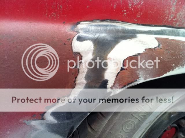

    I had some time today so I got out the wire wheel to strip a few spots to see what I'm up against here.
    I am convinced that by the time I am done, the car will be 300 lbs lighter, there is more bondo on this car than I have ever seen.....
    On the plus side, there is a half inch of bondo over straight clean metal too, so maybe it was preserving it? Of course, found some more questionable repairs, and some not even tryings....

    Whoa, I hate to say it but it looks like the car needs to be completely stripped to bare metal. No telling what other "surprises" may be under that paint (and bondo). Can you see the insides of the doors, fenders and inside the body? In any event, its still a pretty cool project and if it were mine I would definitely keep at it.

    That tunnel is quite the piece of work, I agree, why would anyone put that much effort in such a poor job. Guess they did the best with what they had as far as skills, tools, ect. Sure am spoiled out here in the desert, you got your work cut out for you with the rust issues. I'm with someone else that commented, I'd replace the rusty front cross member with a straight axle!
