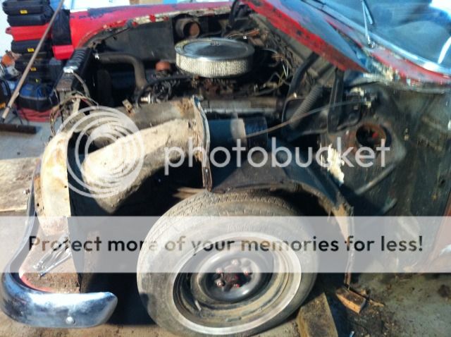

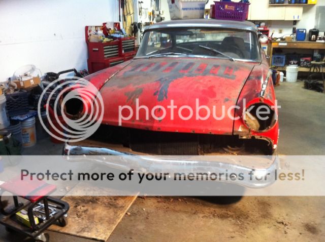

    Got pushed aside for a while, had to move my shop etc....
    Finally got a chance to do a little work today. Removed, you guessed it, more bondo. Also pulled the headlights, grille, and a fender.
    What's behind the fender, bondo hair around the fresh air duct, literally an inch thick. This is getting kinda old here...
    Makes you need a coffee.... Oh wait, that's the other side of air duct, maxwell house coffee can!

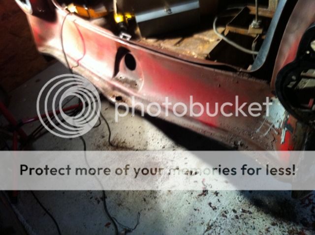

    Not much to update. Been picking away at the body work, smoothing out some of the factory seams, like in the rear where the back panel meets the quarter. Waiting to see what I can find at the upcoming swap meets, though I don't know how much time I'll have to look, I need to be selling my 57 ford stuff.

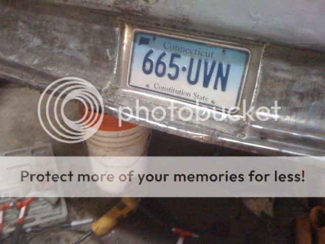

    Did me a little work today, got rid of the gas fill, plate mount, plate light and the dip and holes where the plate light went.
    Just roughed in at the moment, still needs more welding and grinding.
    Plate is just duct taped on right now, still debating plate light and plate mount methods.
    An older before picture:
    [​IMG][​IMG]
    Now:
    I think after I finish this part up, and also patch in the rest of the lip that gets hidden under the bumper, I am going to work on grafting the skin from a 57 fairlane to patch this trunk lid. Should prove interesting.
