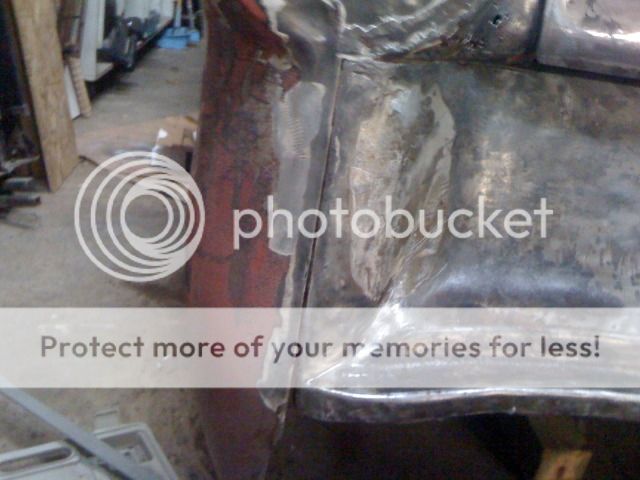

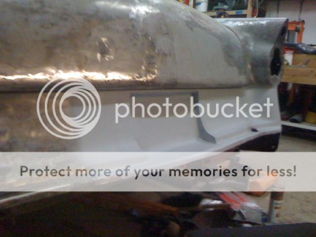

    Did a little more work today:
    Also smoothed one of the seams where the quarter meets the under trunk part. Welded them up, and also added some material to smooth the lower part's transition to the lip as well:
    Here's the one I didn't do yet for reference.
    And the smoothed one.
