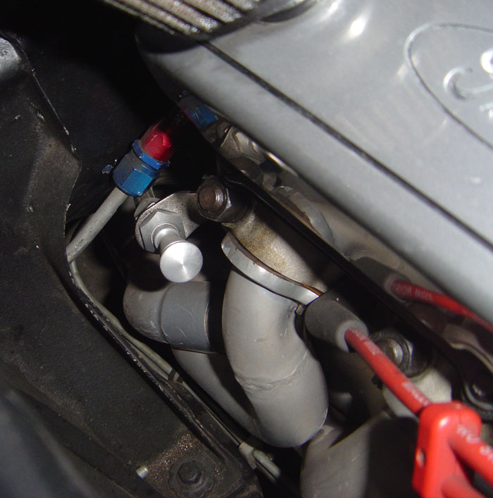

    Lokar makes 2 types of trans dip sticks a trans mounted one that will bolt to the bellhousing and a firewall mount version that mounts...guess where.
    The trans mount is really short, and the firewall one I believe is trim to fit, read - longer.
    The trans mounted version shouldn't put the strain on it that you describe because it is designed to work in a specific location.
    Here is a shot of the short dipstick on my shoebox Ford.
    If you end up reworking the stocl dipstick just make sure to replace the O-ring and maybe add a dab of silicone.
