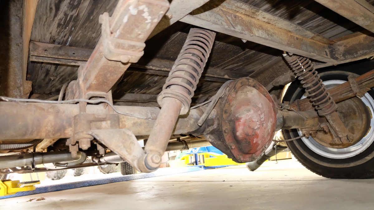

    IMG_20180210_140145.jpg Underside2.JPG IMG_20180210_140156.jpg Engine Bay.JPG To start it all off I’m going to do what I do with every new project and obtain a factory service manual from back in the day. If anyone has one for the cheap or knows where to download one, please let me know. Otherwise I may be taking the eBay route. Lastly, where’s the best and most “budget friendly” place to buy parts? I see a ton of different options but wondering who had the best luck where. More posts, photos, and questions to come. Thanks for putting up with me, everyone.

    Someone already swapped in a 64-70 pickup rearend, eh? along with the later motor.

    The heads have bolt holes in the ends, which is a 1969-up thing, so it may or may not be a 68 Camaro motor, or parts of it may or may not be. There are numbers stamped on the block, in front of the p*** side head, that will help start to identify it (if they were not removed during block remachining).
    The rear end...you probably want to take it apart and inspect bearings, inspect axles, inspect the pinion gear for cracks at the base of the teeth, etc. While you have it apart you can read the numbers stamped on the ring gear, they will tell you the ratio. Or just do the both tires one turn/count driveshaft turns trick if you want to know the ratio quickly. Most were 3.73, some were not.

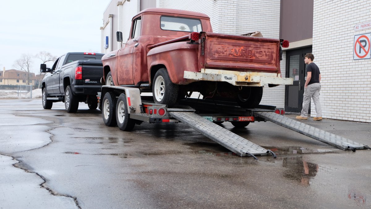

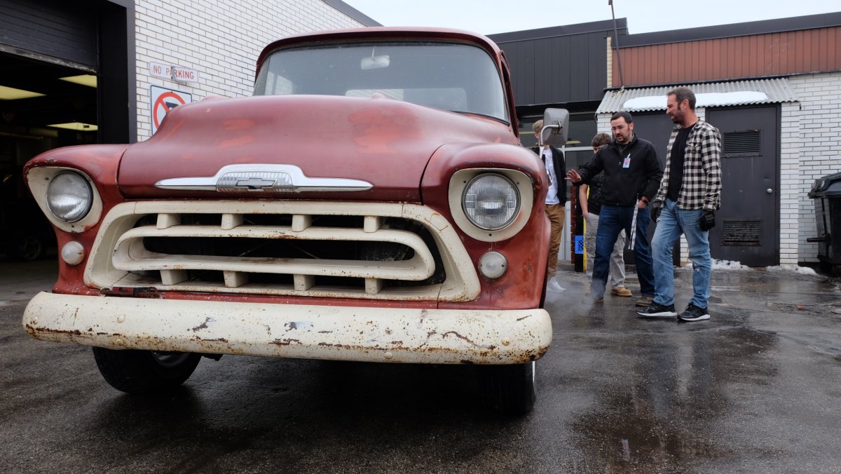

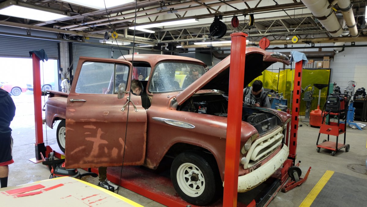

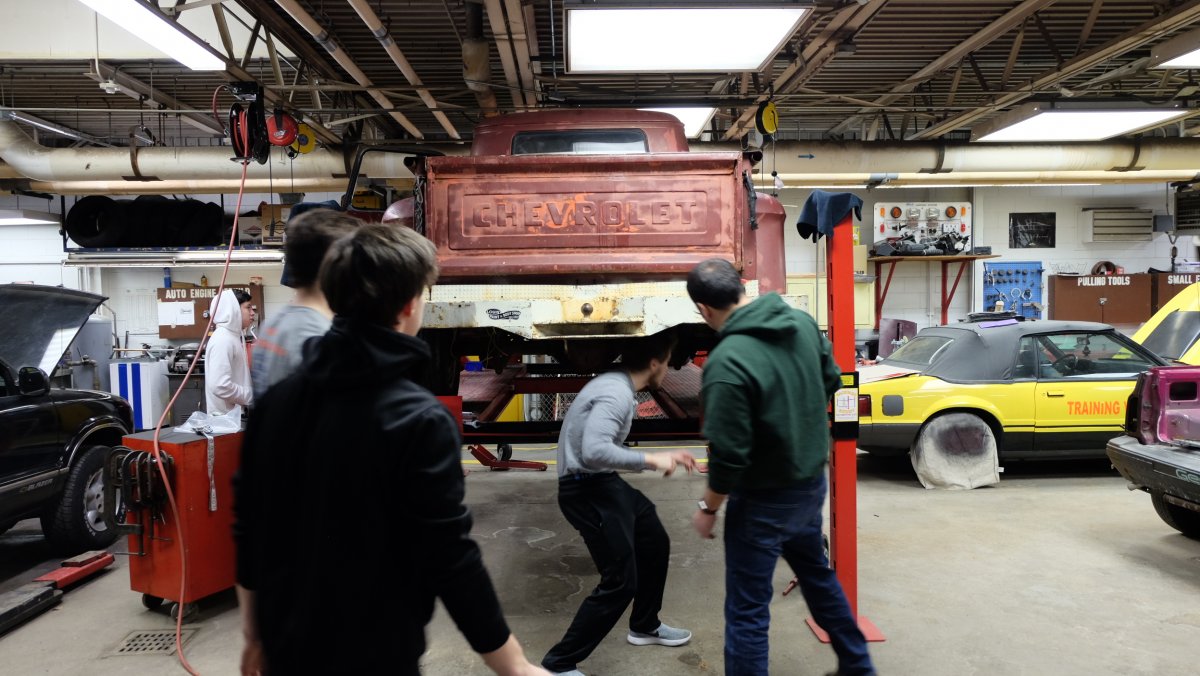

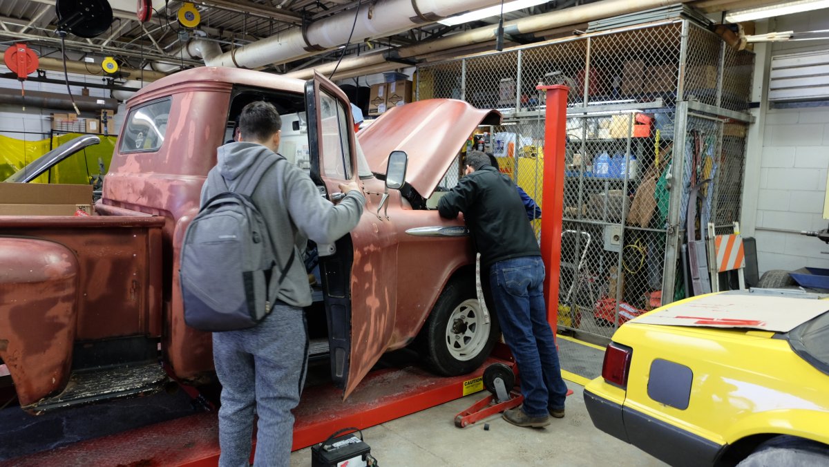

    Level of enthusiasm is building, and I don't quite know where to start. Slowly, but surely, it'll all be tackled. Truck was delivered today and I couldn't be more excited. There are others who are excited as well. . . my 19 Automotive Technology 2 students who were there to witness the delivery. A huge thanks goes out to Chuck, the seller and delivery driver. There's your little easter egg. I'm a HS shop teacher. Every day I'm learning. The old school, however, I'm always going to be learning. Good news is, I'll have a lot of enthusiastic helpers, but this is not a school funded project so it will only move as quickly as my budget allows. Also, I was able to photograph the numbers on the block near the p***enger front of the engine. That will be part of the upcoming photos in the post. Hope you all enjoy; it's been a long day with other things and its time for bed. I'll do my best to get more updates as things move along. Any help with block decoding will be greatly appreciated (basic googling has me thinking its a 307?)

    Yup, looks like a 1968 307 with Powerglide from a full size Chevy. The engine was ***embled on June 6th, the car was ***embled in Janesville WI. I drove by there last summer.

    Very straight, clean truck. Dropped axle is the better method for the front, as there's very little travel to start with. Anything done with springs decreases any travel left. Please, no Pinto swaps .....
