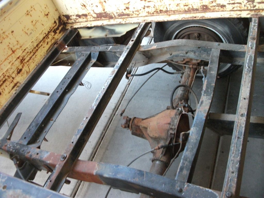

    Picture of rear axle. My rally rim ID is not as large as this one. Should I bore it out to fit??

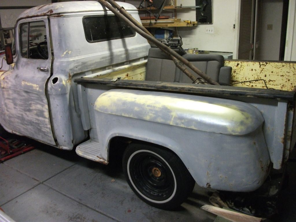

    After thinking I would never find a set of rims, I scored a set tonight. Hell they even came with whitewalls on em!!!
    THANKS TIM!!!!!!

    Might want to look and see if the rivets are ground down on the front brake hubs, if not they'll keep the wheels from seating properly.
    Looks good, just get rid of the whitewalls and it'll be perfect! ;)

    Neat, it's an original V8 truck, it has the motor mounts riveted to the back of the front crossmember.
    I didn't see the wheel picture before, this is a 1988-98 type wheel, not a 1970s wheel.

    I didn't notice before, but you have a later model rearend in there, probably from a 1970s 4x4.
    You can replace all the front studs, or just the ones that are bad, it's up to you.

    I am trying to decode the damn axle tag but can't find it online. Maybe cause its out of a truck. I have been looking at Camaro, Nova and Chevelle info. The axle code is KRY041W9Z. The ratio appears to be somewhere around 3:73 judging by the number of driveshaft rotations (3.75) vs the axle turns (2) on one side only.
  25. squirrel
    Joined: Sep 23, 2004
    Posts: 60,988
    squirrel
    3.73 was pretty common on them.
    My books for trucks only go up to 72, KRY is not in the list.

    Hey Jim maybe its KBY not KRY
  29. squirrel
    Posts: 60,988
    squirrel
    I don't have codes for the newer rears like that...sorry.
