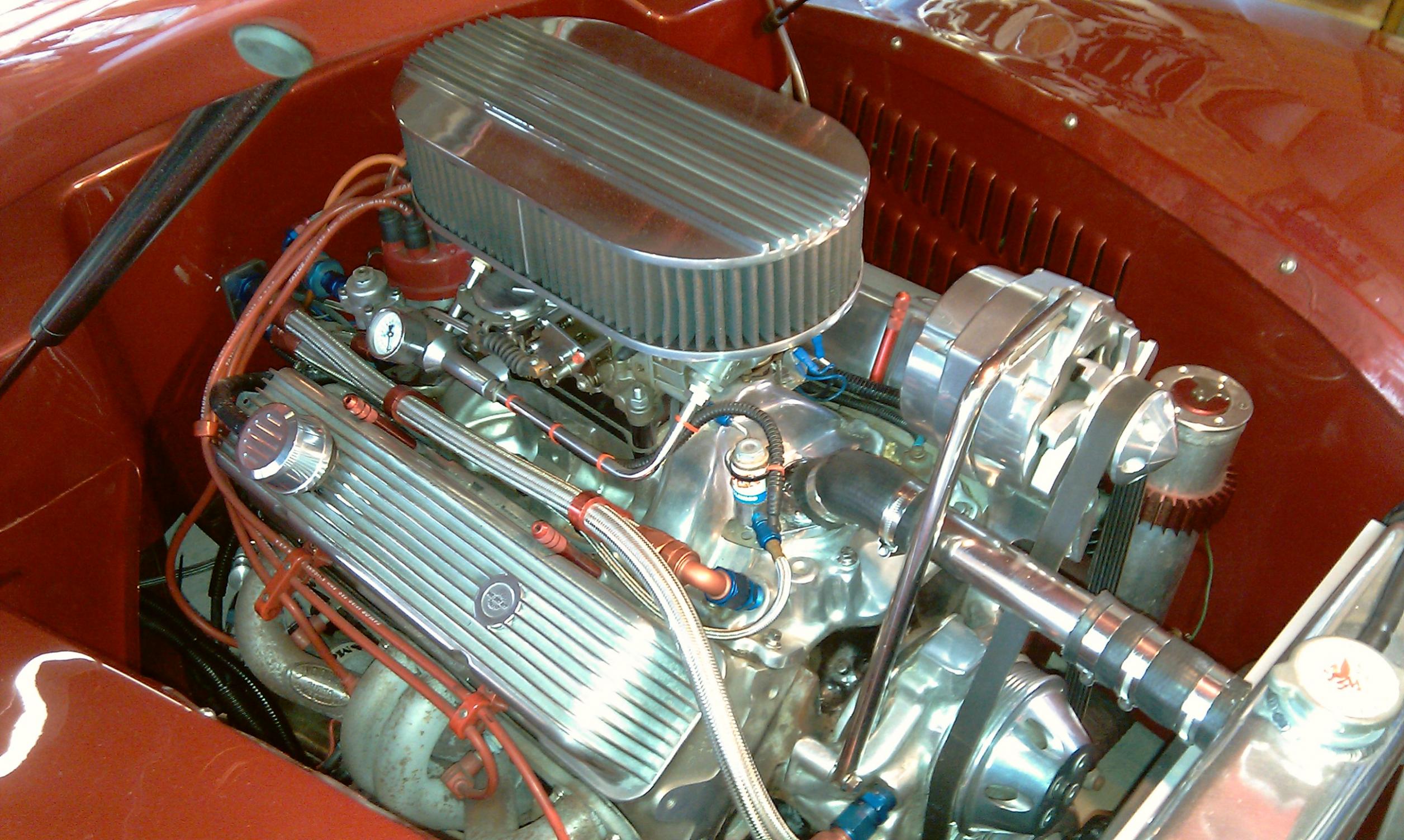

    Mr poopy pants
    Hi Red, just checked out your build, see you are using trusty 350 350 + 10, love those early vette style Calcustom valve covers I have the same set myself I used on another project, I took two bigs slabs of Aluminum to a machine shop and they made me an air cleaner to match

    Red Ryder
    Poopy, my project truck is a slow progress thing due to many other demands on available funds and time. It will get there, but it will take longer than a lot of guys are able to complete a project. I will use the 350/350 with the 10-bolt posi at 2.56:1 ratio. Hoping for a good cruiser. Very nice looking small block in the Ford!

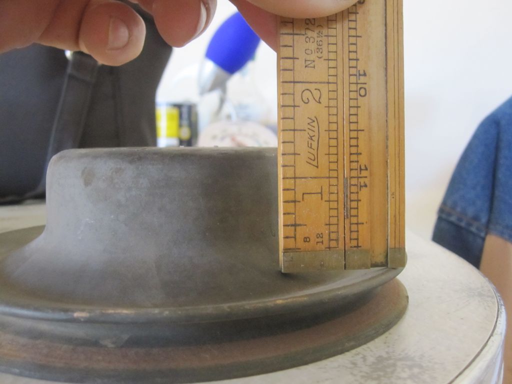

    Alright, spent this morning making door bracket tabs to weld nuts to because I am missing 4 of the rectangle caged nuts somehow. Couple of questions I been meaning to ask.

    2. My long water pump pulley I purchased doesn't quite line up with the crank pulley, its proud by not quite half a belt width. My pic angle is off a bit, the alignment is actually not quite that good. Any ideas? As always thanks in advance for the advice.

    You have the wrong upper pulley.

    I think this is the right pulley, do some measuring on yours?

    I get the exact same measurement on mine. :confused: Only thing is mine is a double pulley which will allow me to hopefully run AC one day. Also remember I cut off the front crank pulley, hope this doesn't come back to bite me.
