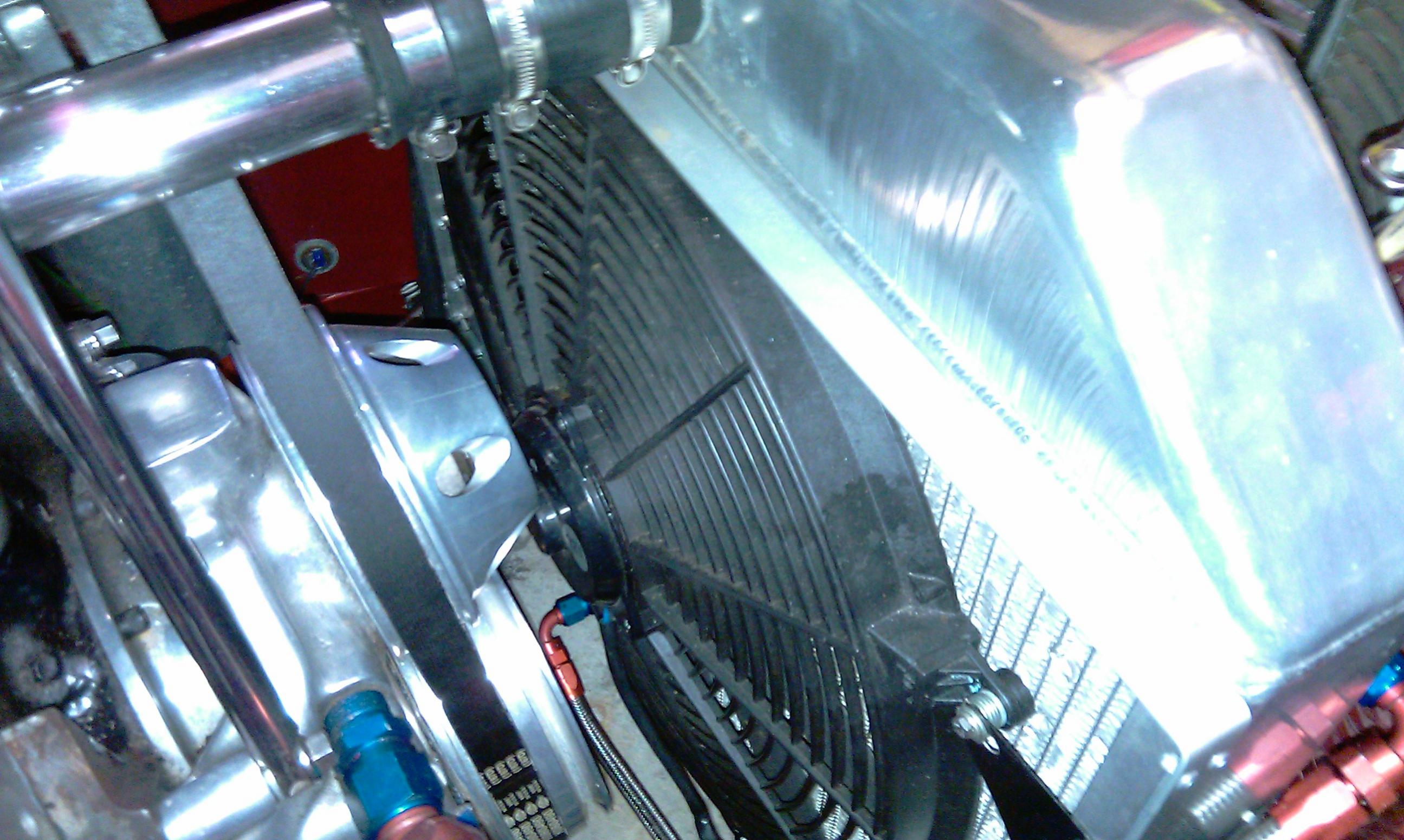

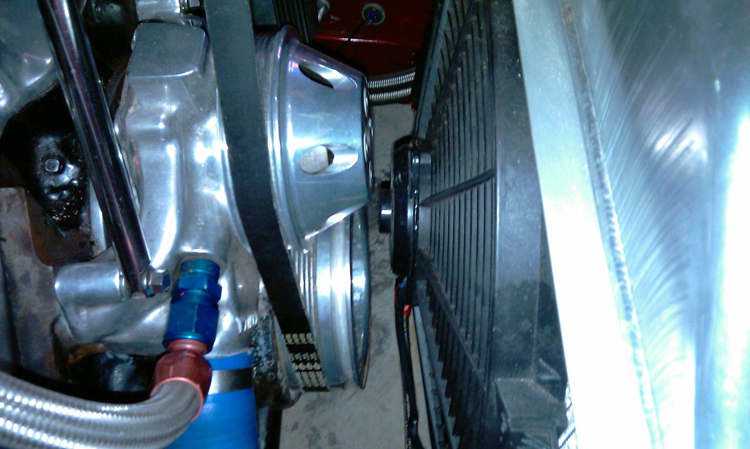

    Hi Not sure if this helps, here is a pic of my pulley setup, I got them from Street and performance, it is possible to go with a serpentine system which I think is stronger and because they are wider allow you run with less tension, therefore load on your bearings etc. I have used Aeroquip hoses and fittings they also do a series of cool fuel filters which fit inline on the supply to the carb. This stuff lasts a lifetime and looks good too. All rubber will perish eventually...

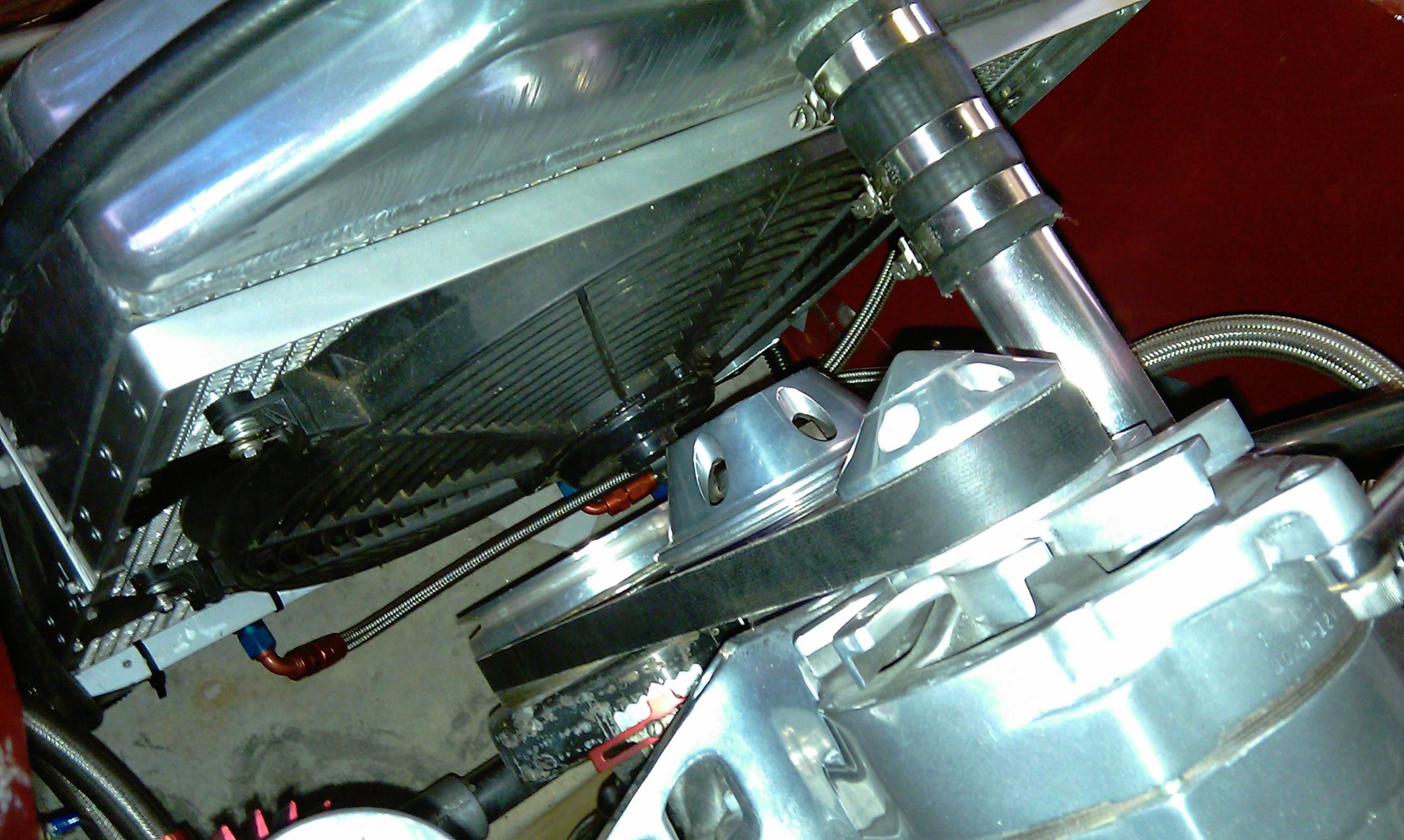

    A few more pics of pulley setup

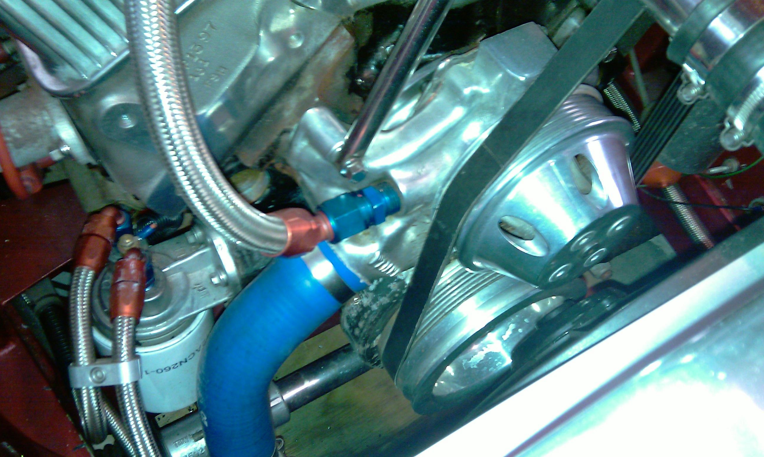

    Serpentine pully system pics

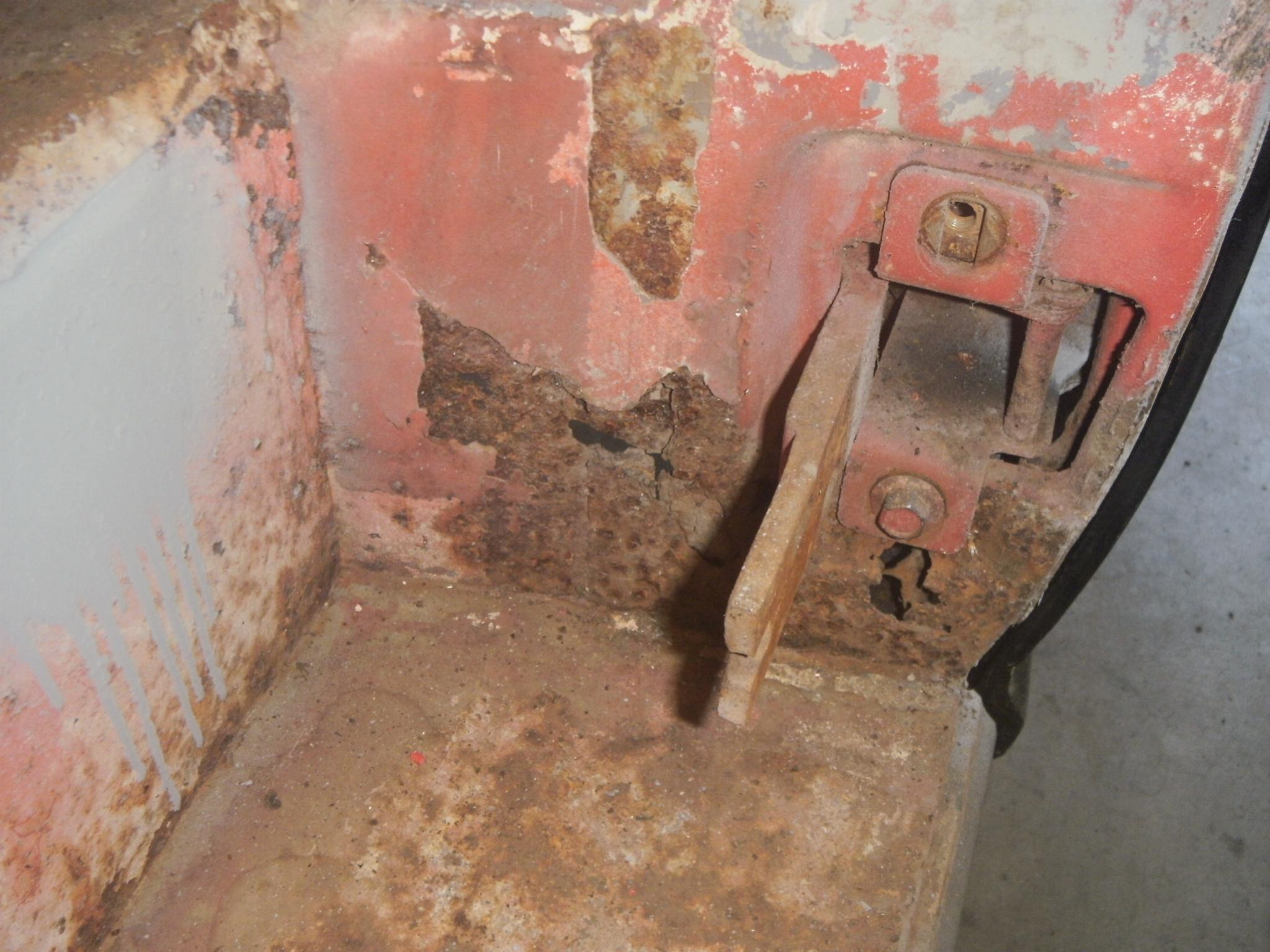

    Don't feel too bad sqrints, you haven't seen my "hinge pockets" yet! Talk about cracked / rusted out! I am going to have to cut out all that stuff and weld in new patch panels. Illinois winters and such have destroyed most of the lower parts of the cab. BTW, my doors probably **** way more than yours do too. It will all be worth it when the truck is "done" (whatever that means)! Hang in there.

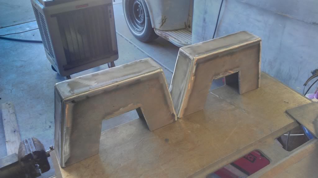

    Decided to weld up the step notch kit because I am tired of dealing with doors and weatherstrip! Also realized the radiator that I traveled to Yuma to to get will not work in the truck. Its for a 55-59 car I believe. Its too wide, bummer.
    Was just screwing around with my new camera phone software on this one.

    sqrlnts, here is an example of what my "hinge pockets" look like at present. I can't imagine how bad the doors are until I start grinding out the gobs of old bondo! We are talking about major surgery on the old truck, but I am committed now to do it. Maybe I should just be committed myself? Getting better every day, actually.

    Need to shorten the step notchs' by about 2", might also have to raise the bed floor by a bit to gain some more differential clearance, not sure on this yet..... Another nice thing is I can now brace from one step notch to the other and can also mount my rear shocks on the notch side plates.
    I can live with this rear stance as long as the gas tank doesn't drag, all depends on how the front lands. Of course I say that now!!! Hahaha
