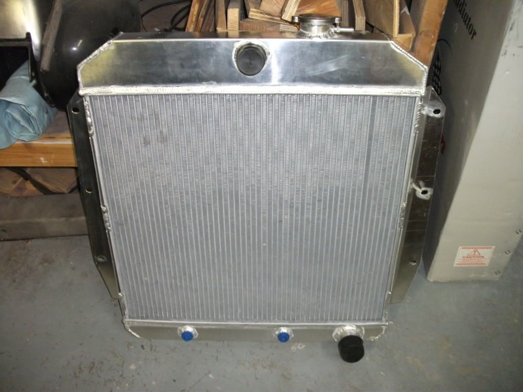

    Thanks guys! I did receive my $169 eBay Chinese radiator, It looks like it will hold water.....lets just hope it can cool down AZ summer temps.

    That radiator looks like it might work. Let us know!

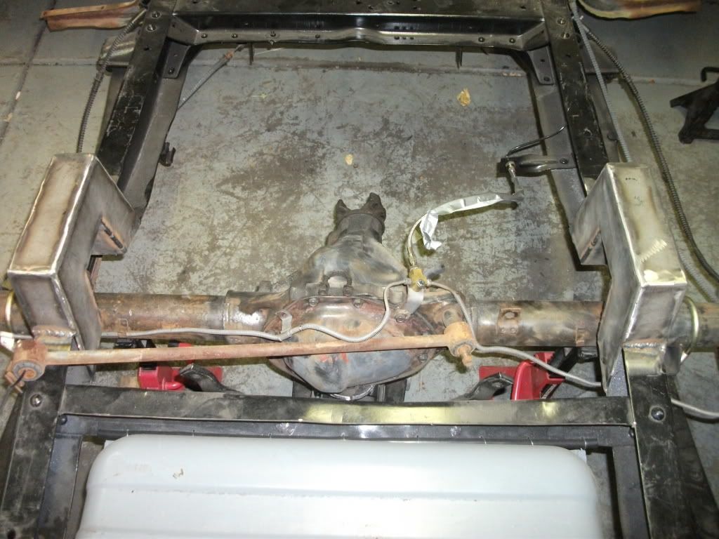

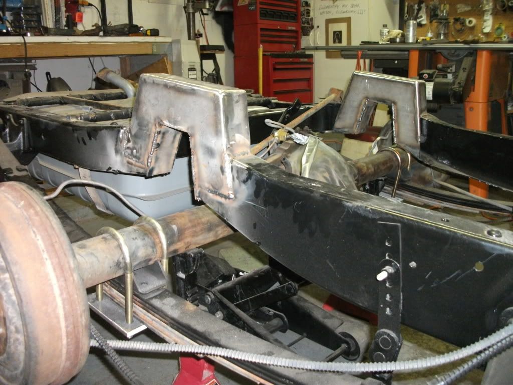

    The temps dropped a bit so I asked my buddy Matt to come over and help me weld in the step notches. They still need to be ground down, dressed up and boxed in but they are IN, thanks Bro!!!
    Anyone have any thoughts on trying to use the old Panhard bar on the rear end? I plan to weld in two brace pieces that tie in the step notches together side to side on the top. This should give me a good spot to weld in shock supports. Then I will box the whole thing in and it will stick above the wood bed floor.
  7. Buzznut
    Joined: May 9, 2008
    Posts: 2,349
    Buzznut
    Is that a draglink or a sway bar link in those photos?
  8. sqrlnts
    Joined: Apr 2, 2007
    Posts: 314
    sqrlnts
    Neither Buzz, its a Panhard bar. This rear end is originally out of a '68 C10. I am just trying to see if its something I want to mess with adding.
    I know from reading the bar needs to be as long as possible and parallel to the ground at ride height to work properly. Once we are back at ride height I will see what my options are.

    You probably don't need it, the leafs will do a good job of keeping the rear where it needs to be. If you're going to swap it out for a 4 bar later or something, then it might be worth building the mounts now for the panhard.

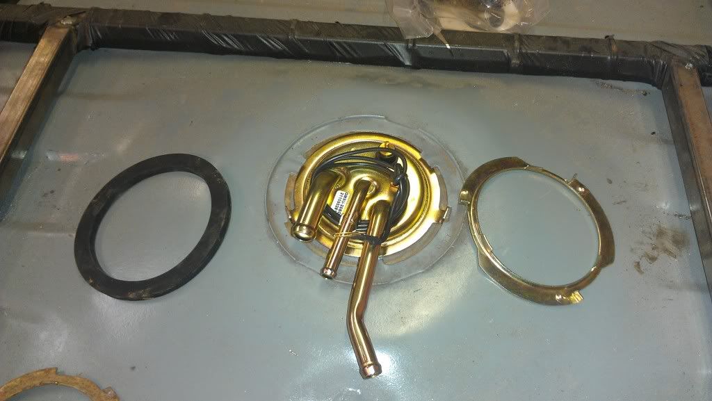

    What's the order for the fuel sending unit? Gasket, sending unit, then lock ring? This looks like its gonna be a total headache fitting this together
  17. squirrel
    Joined: Sep 23, 2004
    Posts: 59,943
    squirrel
    that's correct. There's a special tool...but screwdrivers, hammers, and patience will get it done.

    Sender is in! BAM, thanks Jim.

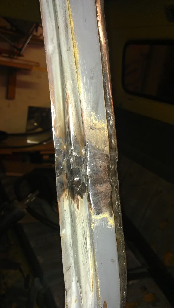

    Cab pillar is s***ched in it still needs lots of work but at least the windshield should fit. both doors fitment still blow monkeys. Installed a short water pump and pulleys, they line up perfect but are aluminum, will these wear out faster than steel?

    My blower drive came with an aluminum lower pulley for the fan belt. I noticed recently that it's worn out. I have 100,000 miles on it! so you should be ok
