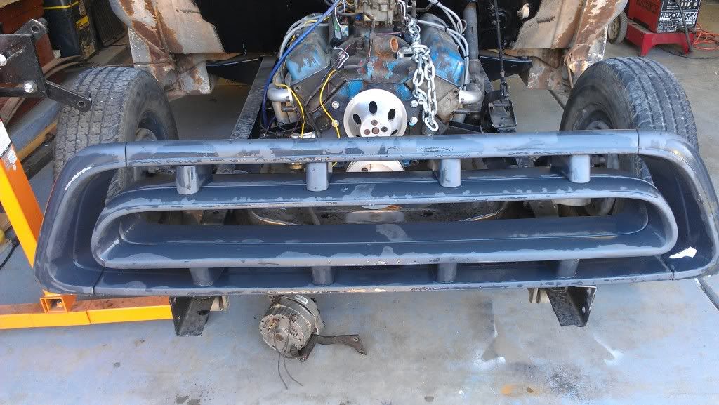

    Strange things happen sometimes. 1 day after Jim offered up his cab I found this 58 GMC cab, 1.5 miles from my house! Thanks again Jim, I think your good karma may have something to do with this find.

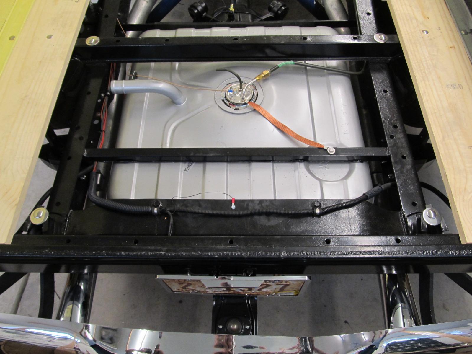

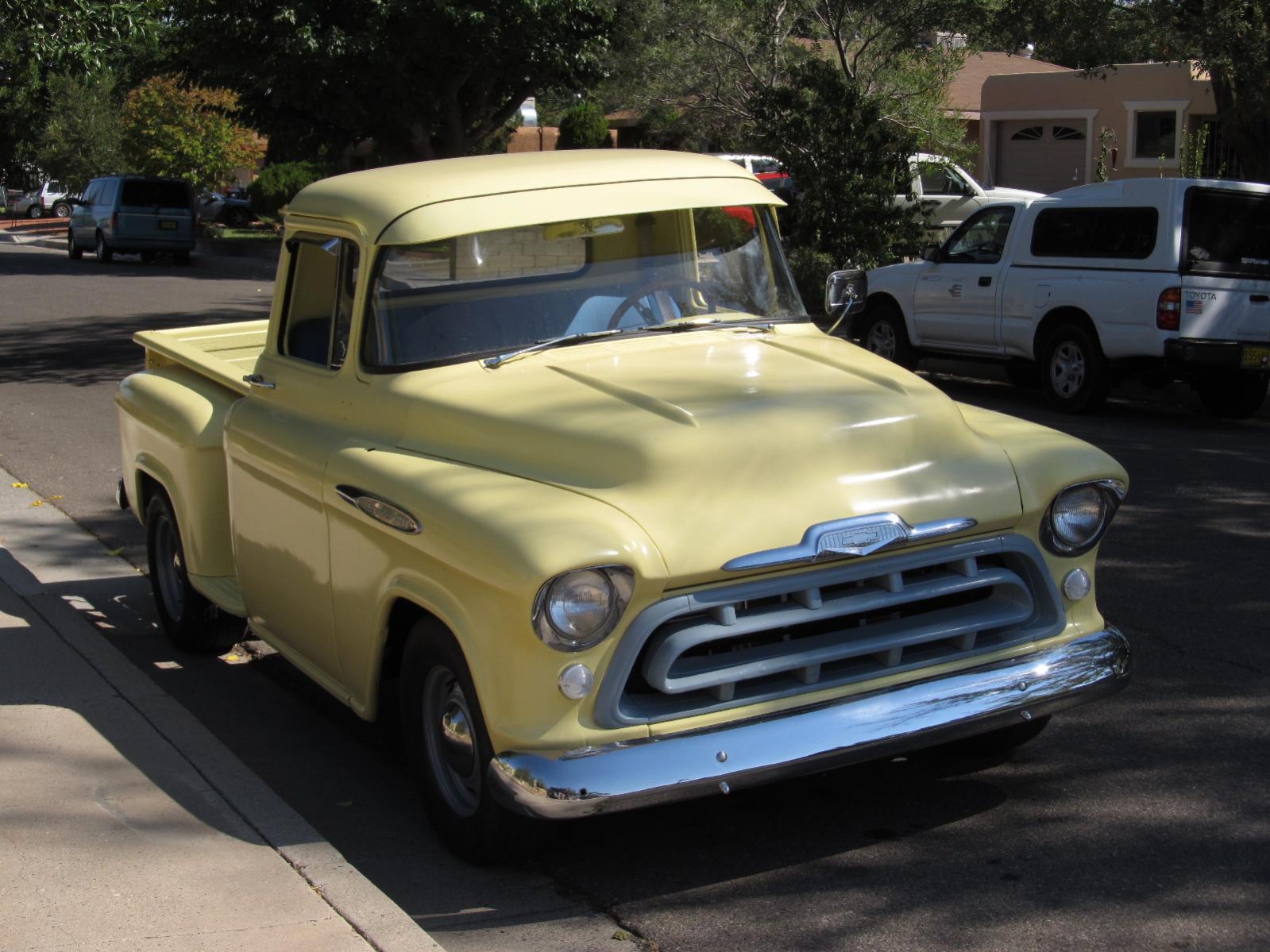

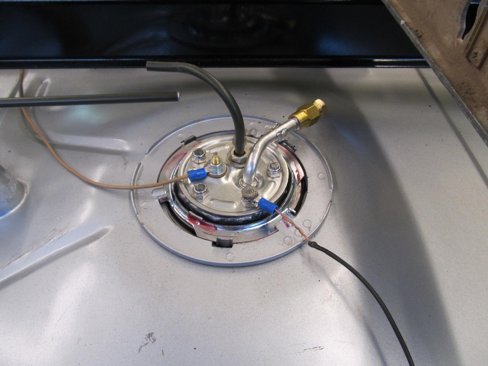

    not to take anything away from your project, just thought I'd show you how I did my wife's '57 3100. (remember me, you got the dropped axle from me).
  27. Gary, what gas tank did you use?
  28. classic gary
    Joined: Sep 24, 2009
    Posts: 506
    classic gary
    mid-late 70's, early 80's, Chevy Blazer. 24 (?) gallon. I made/make an adapter to use the STOCK gauge sending/fuel pickup unit. Stock 5-6-7-8-9 Chevy is 30 ohm, the tank is setup for later 90 ohm senders.
  29. squirrel
    Joined: Sep 23, 2004
    Posts: 59,931
    squirrel
    that's an interesting way to do it. I did one of those once by changing the resistor on the sender, put an early resistor on the later sender. worked fine.

    No problem, these days if it wasn't for some chit chat there would be no updates around here! :eek: Your wife's truck looks perfect, great job.
